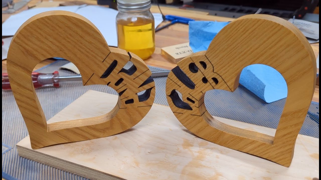

Do you want to explain this in other words? I probably got lost somewhere in the translation and “rotating” the piece doesn’t solve the problem because I intend to make it up to half the thickness of the material on the front side, and then turn it around/flip it and cut the other half of the thickness on the back side of the material.
This is because I already realized that trying to make the full cut on just one side ruins the internal foam.
If you can guarantee the corner placement you can use it to accurately cut both sides. Starting from the top left front, you have corners A, B, C, and D - if your placement is based on “D” (bottom left) when you flip your piece over horizontally “D” is now in the lower right corner - so rotate the piece 90 degrees clockwise to get it back in the lower right position (starting at top left, your corners would now be C, B, A, D) - and your reference corner is very accurately placed.
You second cut shape would be mirrored around a 45 degree line from corner “D”. My explanation makes this sound complicated, try it on a piece of paper to see what I mean
This video I found yesterday.
In fact, this was the first video I found that deals with exactly the issue I want. Make a cut halfway through the thickness of the material, turn the piece of material over and make a second cut that will coincide exactly with the first.

Okay, Sunday morning, let’s try again.
This time I opted for the @onhiatus technique.
I did a test on cardboard and another on K-Line. In both materials I came across with a beginner’s difficulty.
Secure the material in the honeycomb.
If in the case of cardboard it moves due to the air assist (which can be disabled) in the case of K-Line it is warped enough that, from one end of the piece to the other, the laser protection that is only 0.8mm away distance from the face of the material (for focus purposes) touch the piece and make it move away from the spot.
I tried to use double-sided tape but when removing it damage the material surface.
Painter’s tape has little adhesion, and forces me to create an area of extra material that could be damaged when removing the tape. But probably the most reliable option.
I’ve thought about using some fixing pins but taking into account the jig and the length of the pins needed plus the excess material needed (According to my calculations, around 60mm more (30 for each side)) I don’t know if it would be reliable… ![]()
