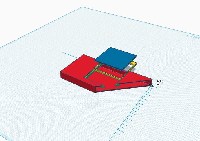

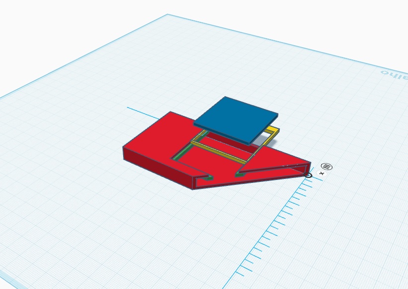

I leave an outline of what I plan to do.
A table made of some type of wood or chipboard with a hollow interior and a drawer where a frame slides into which the honeycomb is placed. It is not shown but there will be a fine mesh underneath the honeycomb to prevent small pieces from falling onto the table. This is because I intend to place a fan/suction at the base of the table that will (or will not) aspirate fumes but mainly “vacuum fixation” of light material to the honeycomb (at least this is the idea).

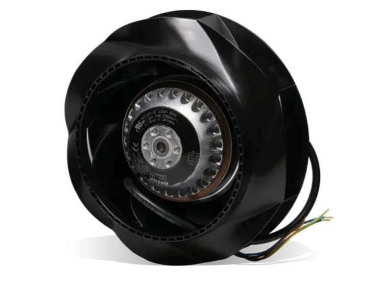

The fan will be one used in air conditioning ventilation. From my experience, I think it complies with the vacuum fixing part, but I’m not so sure about the smoke extraction. :smiley:
This table will sit on top of a bathroom cabinet that I still had when I had a flood at home. (Yes, floods also happen in Portugal. Especially when a pipe bursts in the middle of the morning and I only get home at night. :smiley: ) I’ll post a photo later, but when it’s cleaner. :smiley:
The table:
The fan:

For larger “particles” and small pieces, this mesh will prevent them from being sucked in by the fan.
For fumes and dust, the fan support will have an easy fitting that will allow it to be removed for disassembly and cleaning when necessary. (I’m comfortable with this cleaning because I do it regularly at work)
Otherwise I would have to use a specific fan for exhaustion and a proper filter, this type of fan is usually noisier and takes up more space. (I don’t mean to say that in the end I won’t have to opt for one of these solutions) :smiley:

To know, my brother will be the one who will build the table, who has more skills and more appropriate tools for working with wood than I do.
In other words, the merit will not be all mine. If something goes wrong it will be his fault. :rofl:

The fan I have placed in the image produces an interesting volume of air. With the exact reference I can say how many m3/h it can discharge. But to give you an idea, it can hold a cover made of 0.8mm sheet metal measuring about 500x900mm (19.7x35.4 inch) facing the floor. (I hope the example is clear because I have some difficulty in exemplifying in words)
