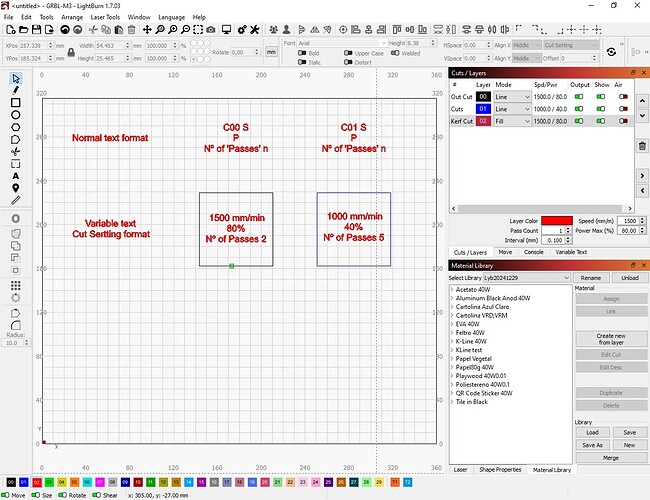

My question is simple, what is the letter to index (think this is the correct term) to show the number of passes when I edit the code?
I have already consulted the software documents but it does not indicate the letter for this detail.
C00 - For layer “00”
S - to speed including unit of measurement
P - to max power including “%” symbol
But for number of passes I don’t find anything…
:thinking:
Or am I seeing things wrong?
I don’t intend to compete with the “Material Test” tool :grin:, but I want to do some specific tests on plywood and it would be useful to have the number of passes “automatically”.

Number of Passes can be accessed with ‘n’. It’s possible this wasn’t added to the docs, so I’ll let the team know.
Oz Thank you very much. That’s it! :100:
If you let the team know to add that to the documents i’ll be appreciated, otherwise I would do it.
@misken
As I expected, if when using the “material test” feature the information on the number of passes exists, I immediately deduced that it was possible through variable text. To do this, you just need to know the code. :wink:
Can you guess now the number of passes selected on each layer? :wink:
(The word “Passes” must be between ’ ’ because the letter P is the code to display the power including the “%” sign.)
We don’t have all settings available through the variable text system, but many of them are there. I think the number of passes was initially omitted and then added when a user requested it, but I forgot to tell the docs team about it. They’ve now made the change as well.
