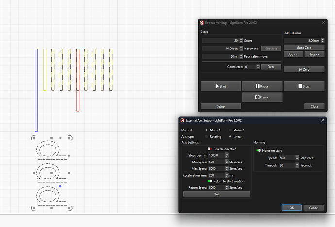

What acceleration value did you use in your latest testing?
That would require a second pass. I used to do it that way to add the numbering and the longer tails 10mm graduations after running the 1mm grads, before I figured out the easy way. When I first started testing the X-Y table I would actually run 1mm repeat marking and then go back and run 10mm repeat marking to check repeatability. I don’t have a video up of it currently but didn’t have any issues.
I use 10mm splits repeat marking with linear mode.
10 deg value (10 mm).
Pause - 200 ms.
Step per mm - 1000
Min speed - 500
max speed - 3000
Accel time - 250
Some tests with old params of pause and speed here (image for previous message):

Your methodology looks sound. I would still slow down the 8000 down to maybe 3000. Never mind, I see you used the old image but updated values in your post.
Yes, the initial settings were as shown in the image (all matching the EZCAD configuration). Later, following your and Aaron’s advice, I reduced the speeds and increased the pauses — but it still didn’t help.
To phrase this differently: You are sending the controller 10k steps.
10 x 1000 steps per mm
The gap after each “repeat” indicates that 1000 steps per mm is too high. try a lower value here.

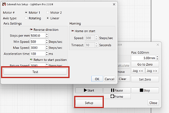

Can you measure the movement when you use the Test button in Repeat Marking? It should be exactly 50mm. I claim, it will be more in your case.
Can you measure the movement when you use the Test button in Repeat Marking ? It should be exactly 50mm. I claim, it will be more in your case.
Sure, i will be near laser on monday and will rec video of test for you.

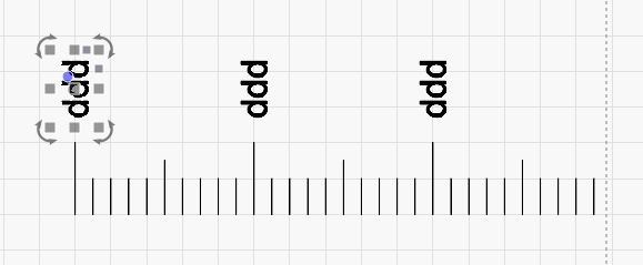

Simple workaround: Instead of marking with Lightburn’s number format, mark with its CSV one, using a file with “1” on the first line, “2” on the second, “3” on the third…“99” on the 99th, “1m” on the 100th, “101” on the 101th, and so on. Shouldn’t take more than a couple minutes to set up, but it can’t handle more complex changes.
Tried at home ( only app test). Approach with variables from csv file and it helped fix condition of “Xm” marks. Thanks!

Finally had time to run some tests:
Video 1 (5 cm sections):
Each part is 5 cm long (numbered for convenience).
As you can see, the start of the next part is exactly where it should be (on the cm mark), while the marks in the previous part are partially shifted.
Video 2 (3 cm sections):
Same issue… all lines except the first one are partially shifted, while the first line of the next part is exactly where it should be.

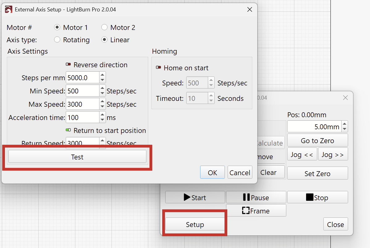

Thank you. That proves that the Steps per mm are indeed correct!
For my peace of mind, could you press the test button in the setup and confirm that the axis moves 50 mm back and forth?

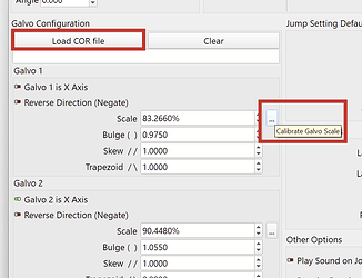

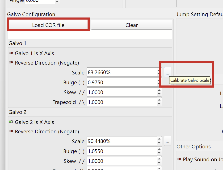

The other videos indicate that the scale of your galvo axes needs to be calibrated.
If you have a .COR lens correction file you can load it in the Device Settings.
If you don’t have this file, do this:
  • Engrave the largest possible rectangle on a flat piece.
  • Click the three dots next to the Scale field.
  • Enter the Requested- and Measured size, and click OK.
Pay attention to “Galvo 1 and 2” to see which one is the X or Y axis in your case.
I’m curious to know how that helps.
100% correct. It moves the right amount, but it is squeezing the gradient lines. Make sure of focus and re-calibrate. Then remember to raise the head to re-focus on the ruler.
