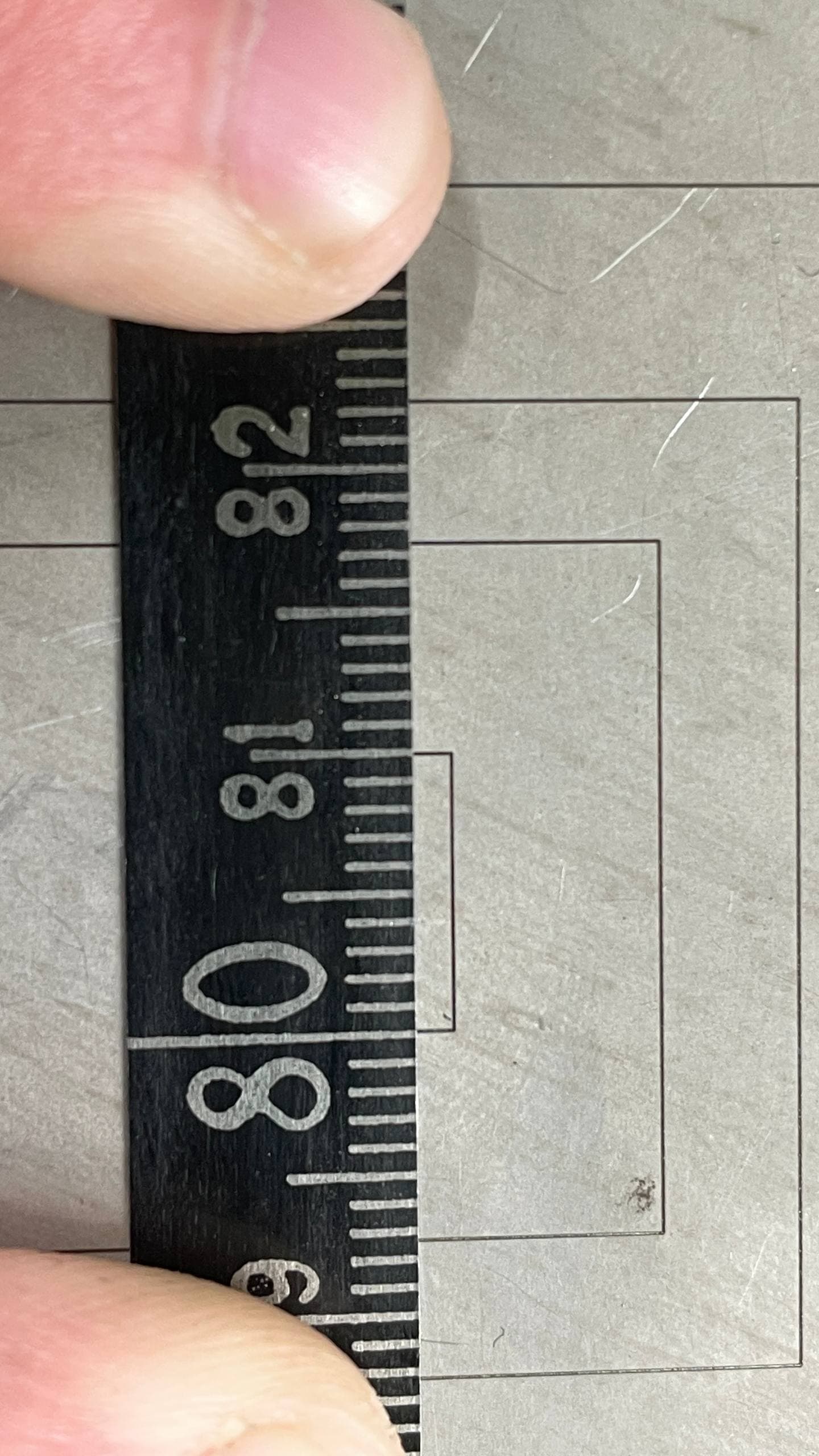

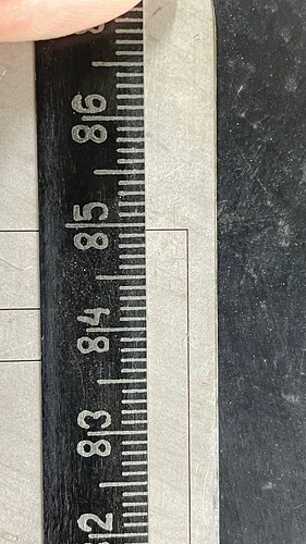

Have no time and material to test big sizes (sorry), but here some small size info:
I made blocks of 10x10 25x25 35x35 and 50x50 mm:
10x10:
All looks like almost perfect.
25x25:
Here we already got some shift of approx 0.10-0.15mm
35x35:
Here a bit more - approx 0.25mm
50x50:
and here is approx 0.4mm

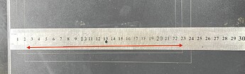

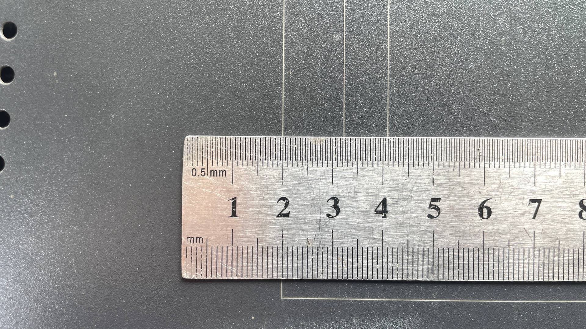

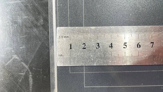

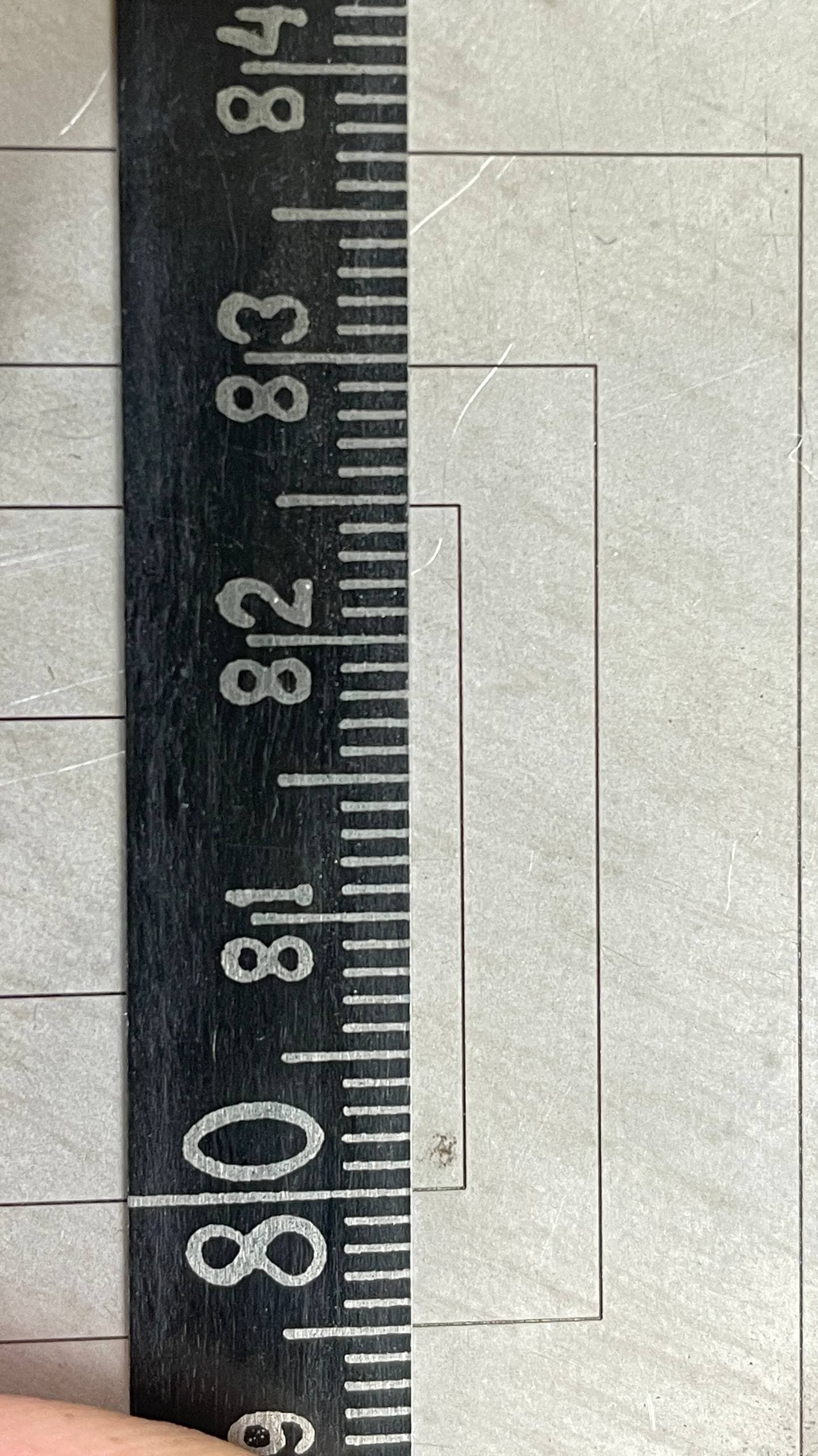

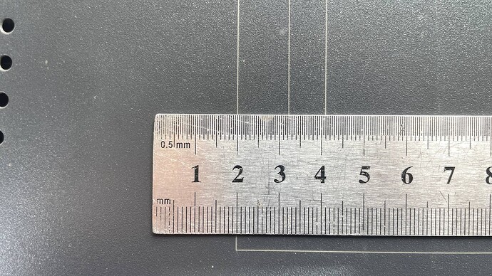

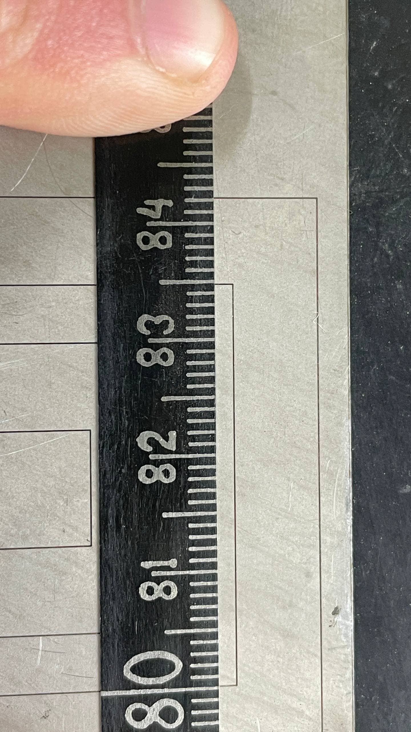

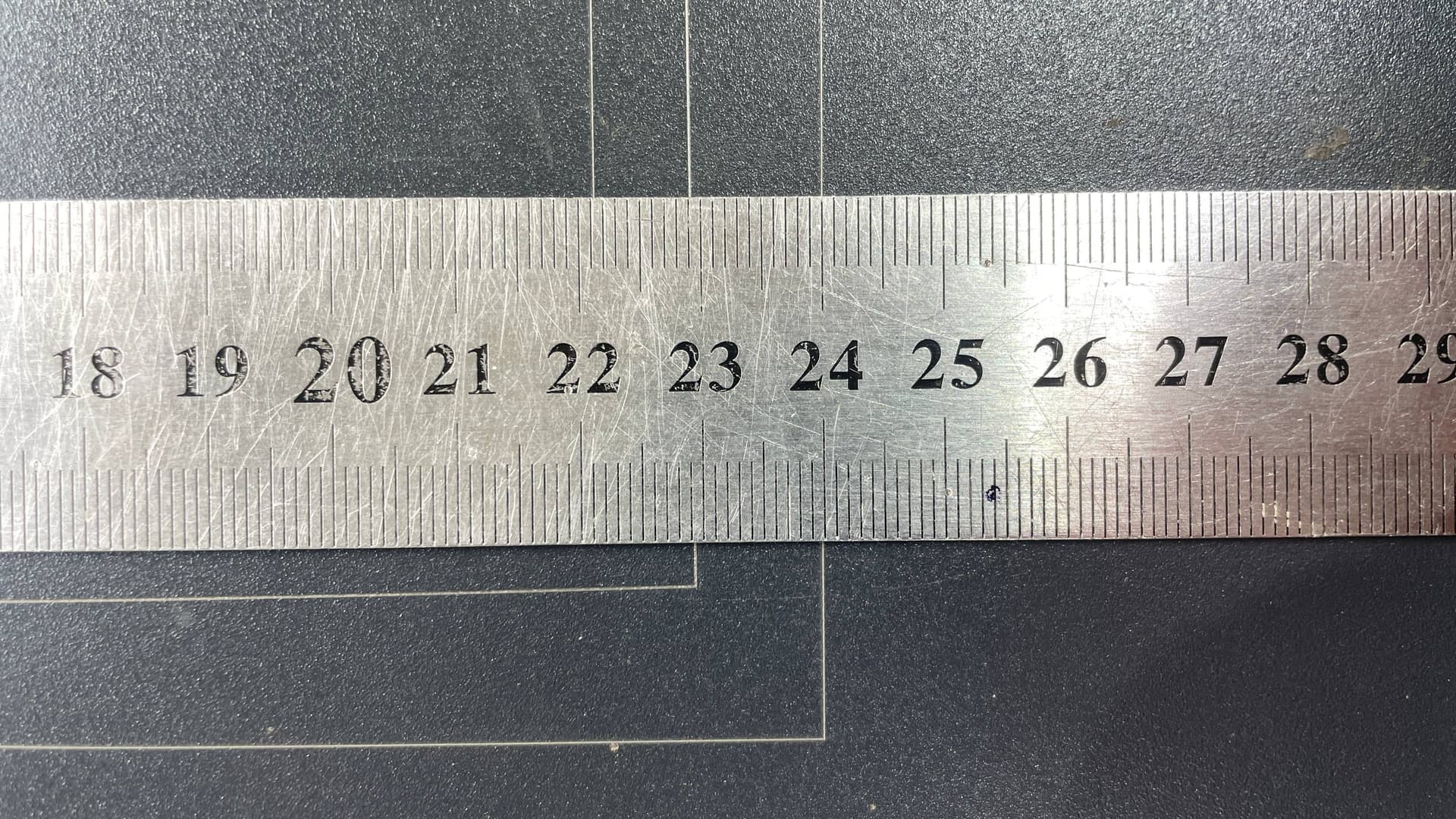

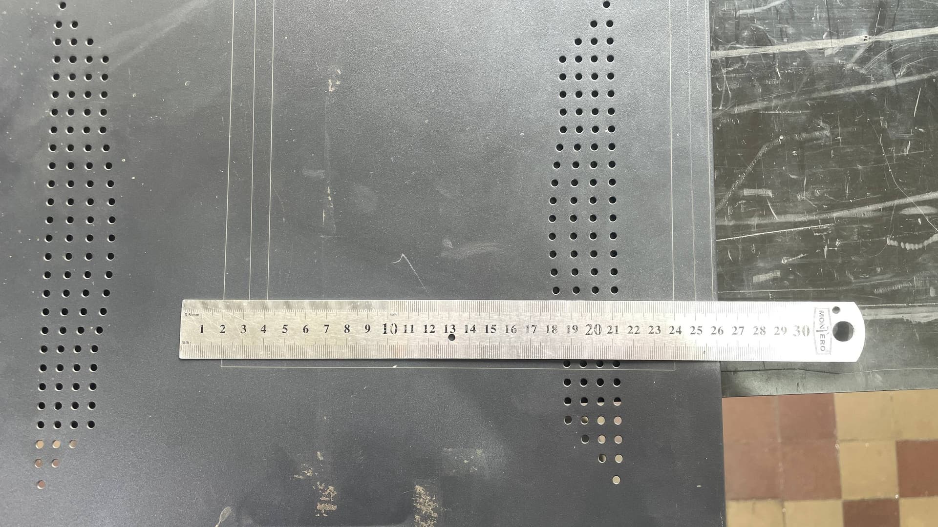

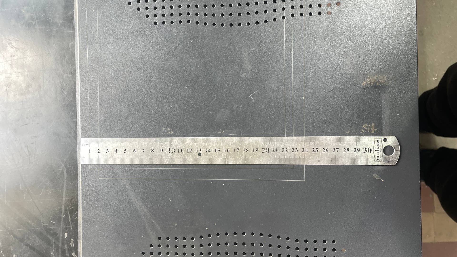

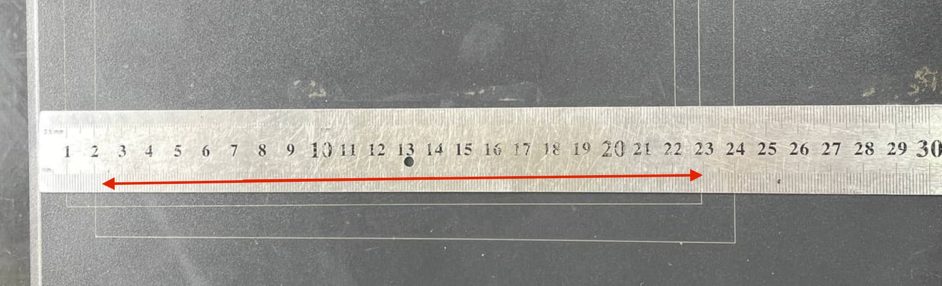

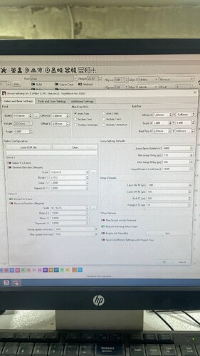

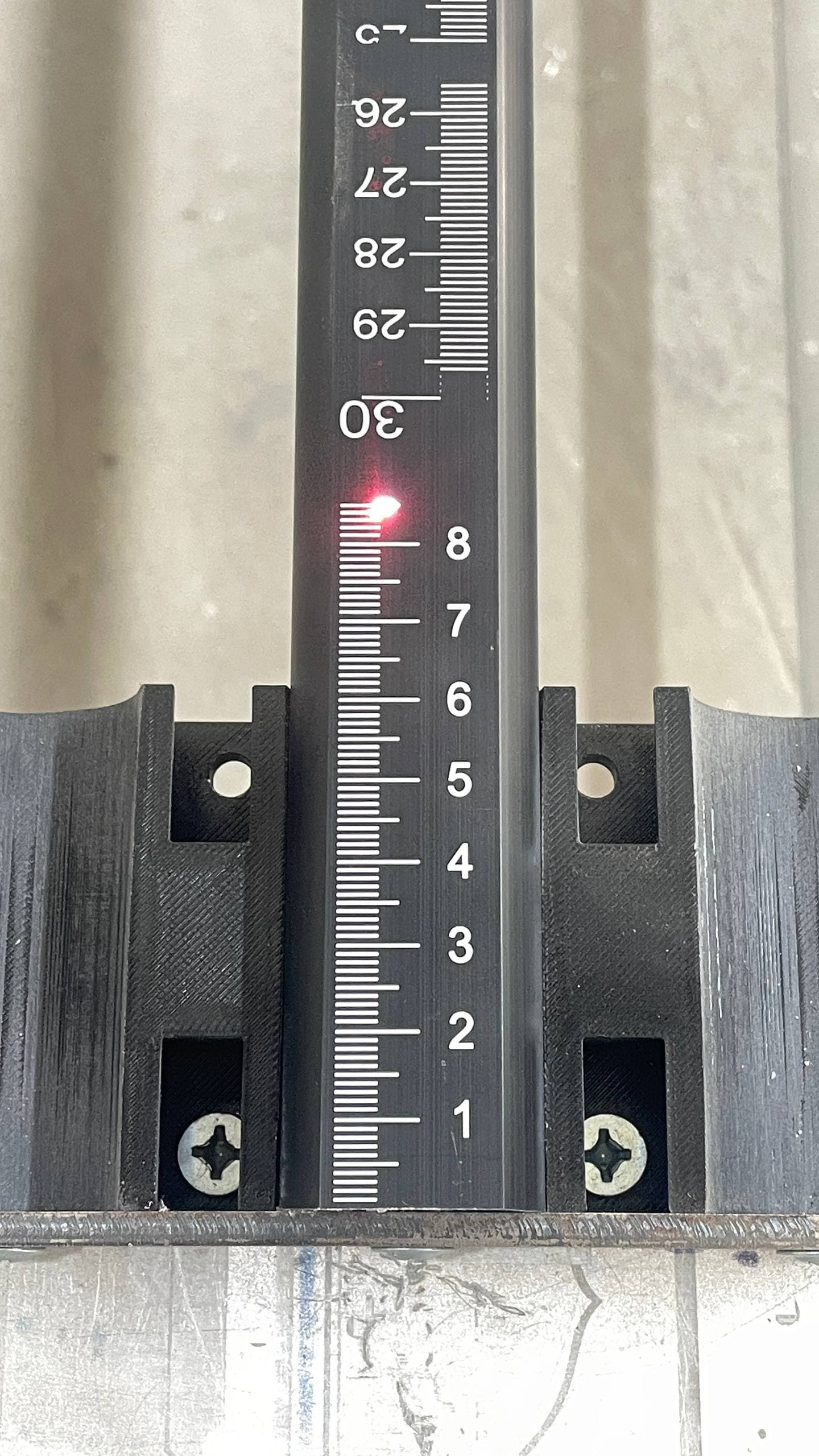

rsx2007
(Yura)
October 14, 2025, 3:22pm
53
First of all, it’s important to note that the starting point is the 2 cm mark .
The testing area is 220 mm .

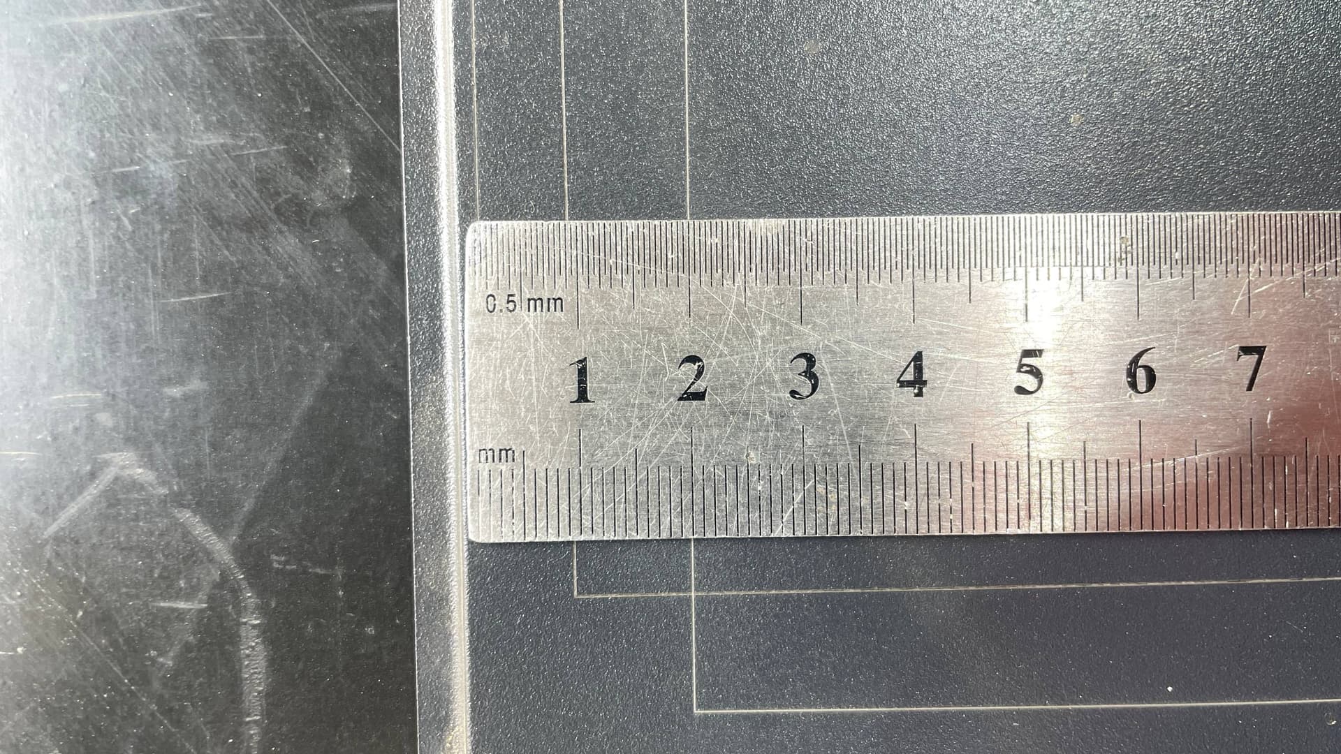

Y axis
Start:
Finish:
Entire area:
Y axis is perfect.

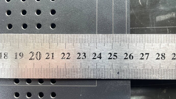

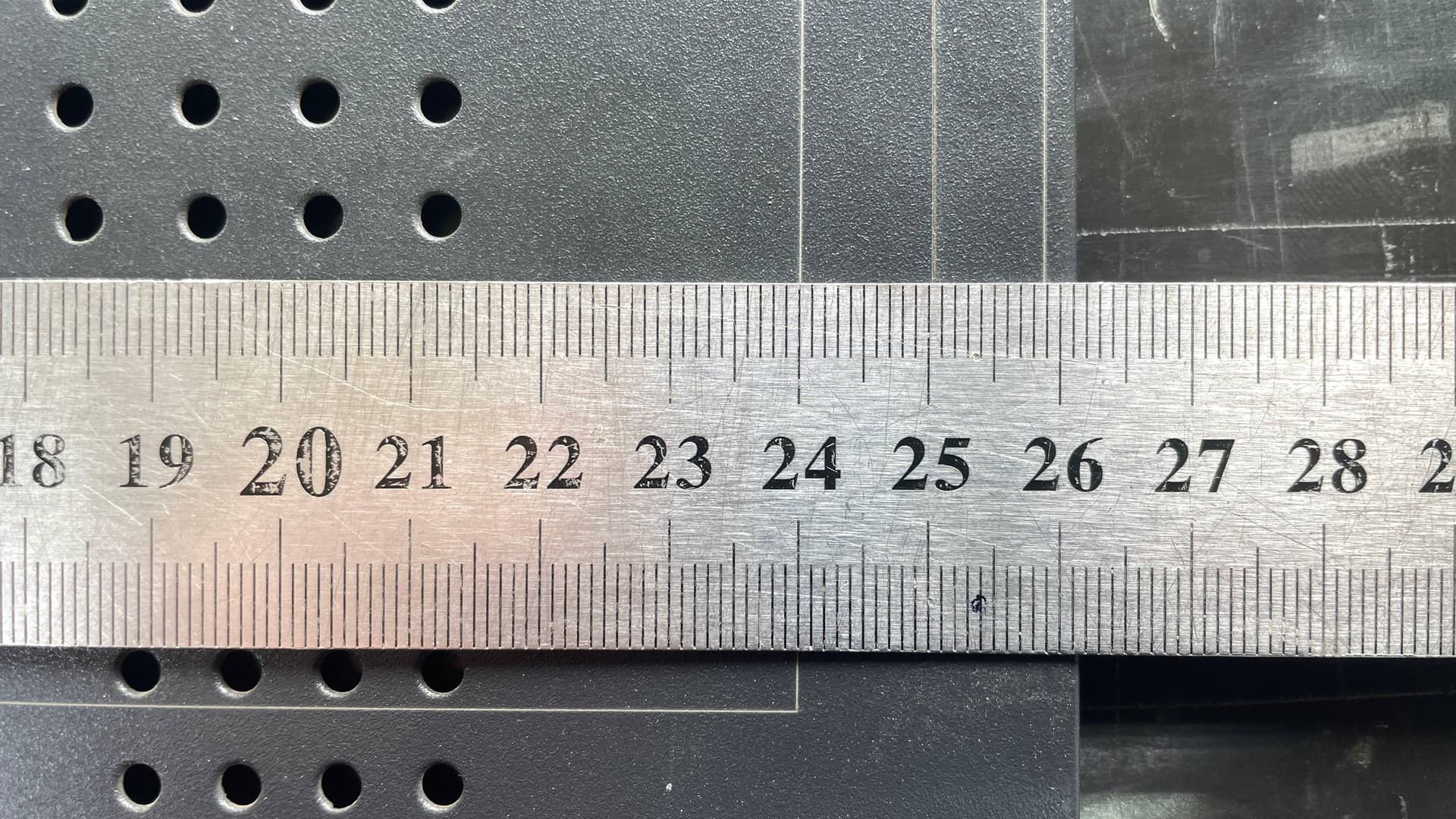

X axis
Start:
Finish:
Entire area:
The ruler here is centered, so there’s a small 1 mm difference across this working area (22 cm).
There was also a slight bulge, so I made some adjustments:
However, the result is still not valid — there’s still some issue present:
I don’t understand what could still be wrong…

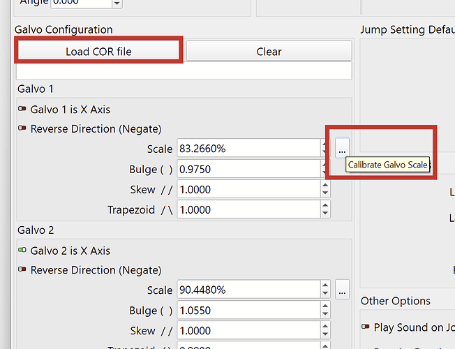

Aaron.F
(Aaron)
October 14, 2025, 3:44pm
54
rsx2007:
Y axis is perfect.
Nice!
rsx2007:
X axis
Did you adjust this by calibrating the Galvo scale in the Device Settings?
From your image, I can see that “Galvo 2” is your X axis.
rsx2007
(Yura)
October 14, 2025, 4:46pm
55
Yes, and test mark of ruler is the result of marking AFTER calibration.
Aaron.F
(Aaron)
October 14, 2025, 7:13pm
56
Was this measured before, or after calibration?
As far as I can tell, it’s almost a millimeter off.
rsx2007
(Yura)
October 14, 2025, 11:42pm
57
On this image if you treat it from 1 to 23 cm → so yes 1 mm off, i mentioned that earlier:
But 1mm for 230 is pretty much small in comparison with 1 mm per 10 mm (each repeat element) as you can see on ruler.
