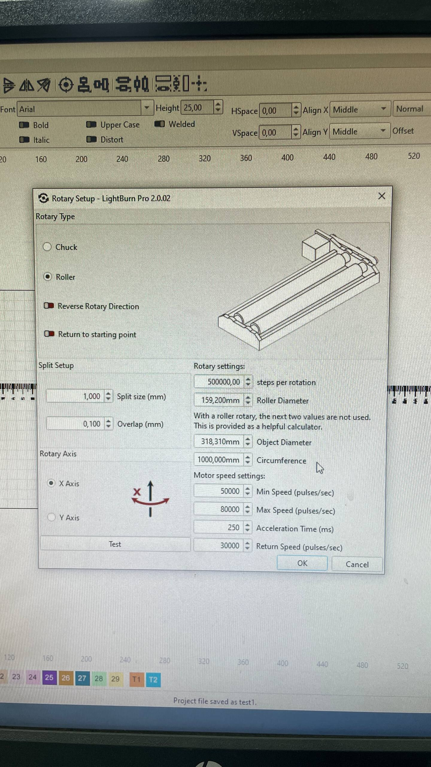

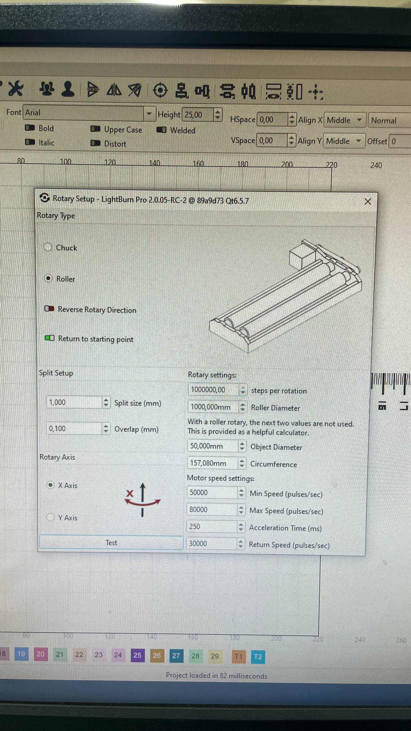

Well i have tested some logic and here is feedback:
  1. In some cases buttons to save parameters are missing:
Version 2.0.02:
Version 2.0.05:
So in this case we cant save params (its not saving value automatically)…

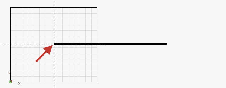

I’m not sure what this means exactly, but it’s worth noting, that the zero point that you set is here on the workspace:

Rotary Setup:
  • Split size = 1 mm
  • Overlap = 0.1 mm
Working Area Settings:
  • Type = Roller
  • Steps per rotation = 500,000
  • Roller diameter = 159.2 mm

Earlier in version 2.0.2, we used a long “table” of 5-meter length, but the problem persisted. So honestly, I’m not sure we need to change WORKING area of laser as its not the same as working area of table? Right?

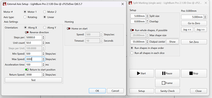

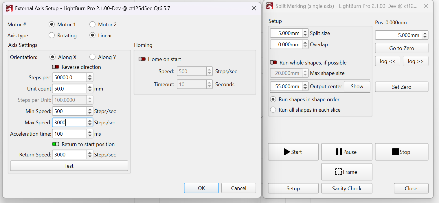

What I have is a “Unit count” and a “Steps per unit” - So, 50,000 steps per 50 units is the same as 100 steps per unit:
The table length is just implied by the size of the job itself, but I plan to add length limits as well as homing.
None - I need time to finish implementing it correctly and test it. It’s nearly functional as is.
