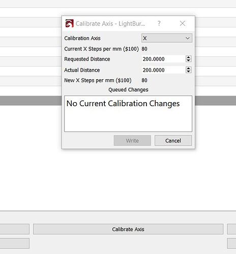

Im from Germany and I have a Atomstack A5 pro+ and Im using Lightburn on my macOS Sierra Version 10.12.6 and my English is not so good. My Problem is that my units of measurement are incorrect. My Atomstack has a maximum of 400mm on the Y axis and a maximum of 410mm on the X axis. This is my overall workspace. if I enter these values in Lightburn, the laser moves across the workspace, so I have to constantly convert while burning. If I want to burn something with a length of 1cm, I have to enter 3,197mm in Lightburn. So the values are never correct. What should I do?

Draw a Square start with 100 mm x 100mm then engrave it measure the actual size , go to Edit machine settings and then Calibrate Axis, enter the Requested (100mm) size selecting for each axis required and the Actual size of the result.
And Write, do this a couple of times, the larger the size you use the more accurate results you will achieve. starting small and increasing size of square until the results match.

i don’t think 250.000 in $100 and $102 is correct. Act like @paulcw suggested you to make calibration of axis
This is almost certainly the cause of the problem. However, I thought that Atomstack did not allow GRBL changes to be saved so not sure how this would be resolved.
Try setting these to Atomstack defaults and see how it works. Enter into console:
$100=80
$101=80
Thank you very much!

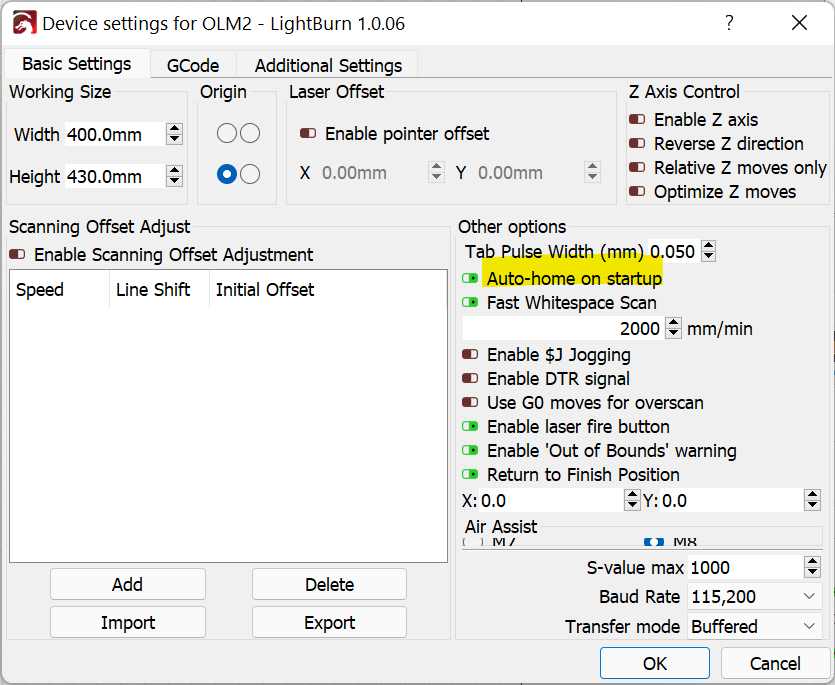

And there is a second Problem now. I can’t work on my workspace. Normally I made something for example a square and this square I want to begin at the end of my workspace (not by x and y 0). I did this by putting the square and move it to a place I want, but wherever I put it now, it always begin by x and y 0.
(Thank you all for your help, really!)
I believe your machine does not have limit switches correct?
If correct, then disable “Auto-home on startup” in Edit->Device Settings.
