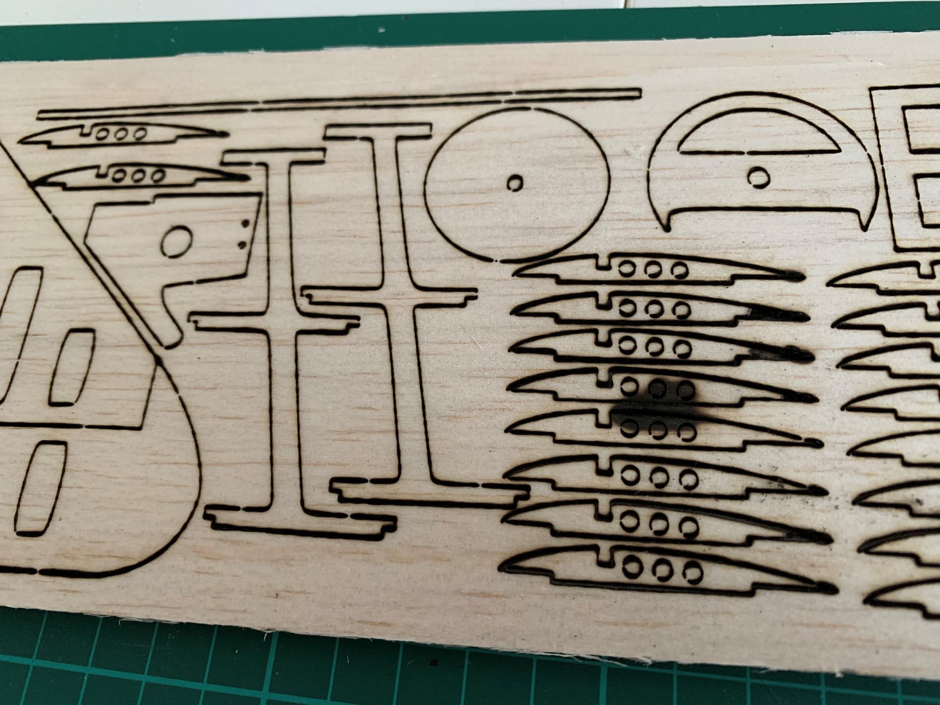

I have a simple Sculpfun S9 diode laser and have used the minimum power feature up to now. Without it I am getting burns in the corners and on small parts

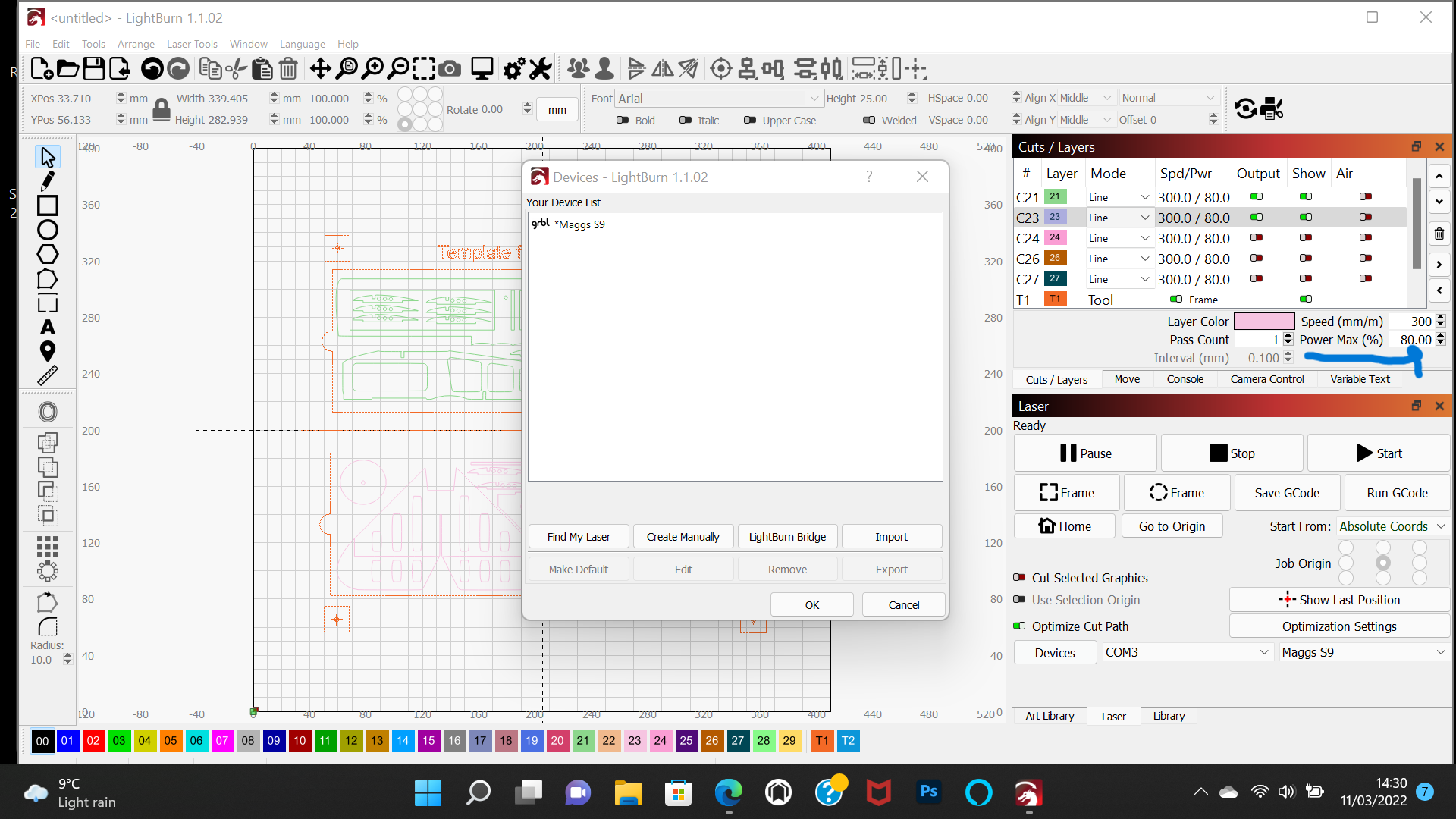

Also, can you confirm your device type by clicking the Devices button in the laser window and taking a screenshot?

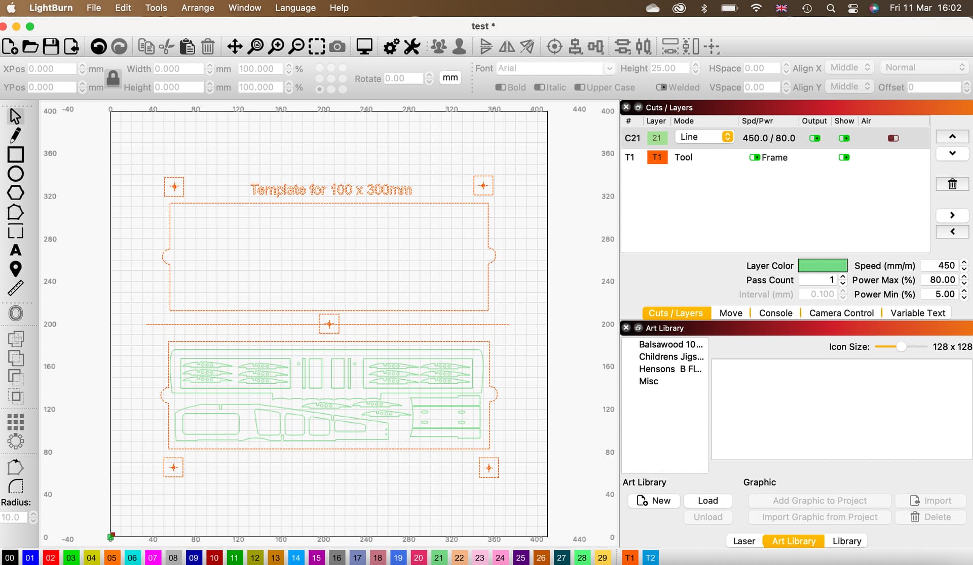

The blue line is where the min power adjustment button used to be

I have also included a screenshot showing the min power button
Okay. I was able to review the files. I assume these came from different project files as they looked fairly different and one had 2 layers.
I see no difference in the way power is handled. However, the main difference in the file that you identified as burning is that the speed is configured much slower (450 mm/min vs 300 mm/min). This would for sure cause more burning in general.
Could this account for what you’re seeing?
Oh no sorry I was testing different speeds to try to eliminate the burn and forgot I’d changed it. Should I change it back and send again ?
Did you see the screenshot with the min power button ?
Yes. I’m aware of the button. It was considered a bug that it was showing since it was confusing. It appeared a few releases back.
