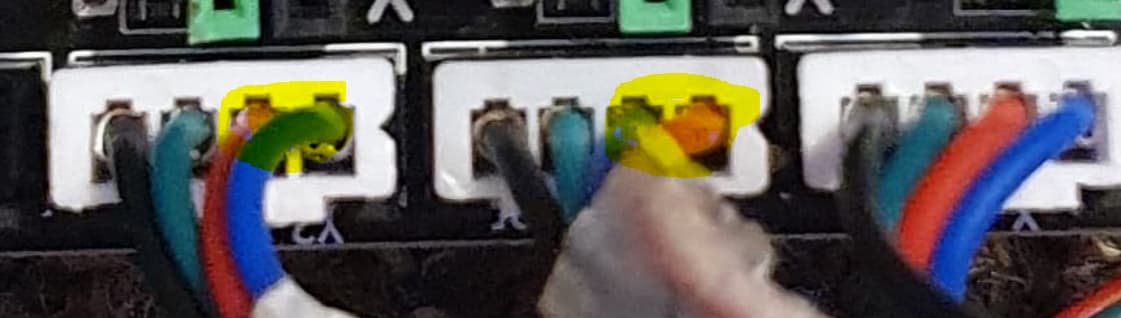

The Y motor on the right side works synchronized with the Y motor on the left side but in reverse, so the move of the gantry is in the same direction.
One Y coil pair reversed.

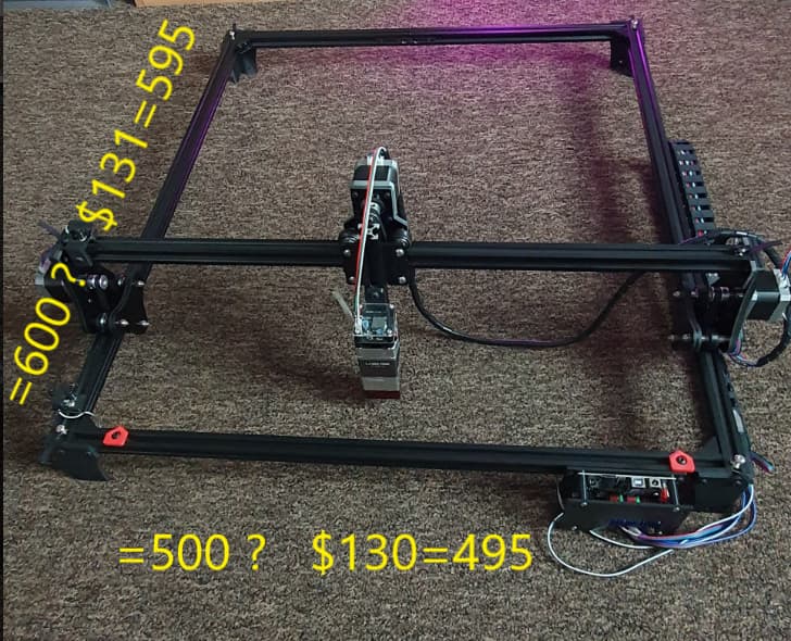

I found Vref calculator online. I adjusted Vref to 0.64V…DIP switches = high-high. Centered and stretched belts…I did tests and everything was perfect…Everything is solved. Thank you to an to Parsec for all. if it is necessary to post pictures or something, I will gladly to do…

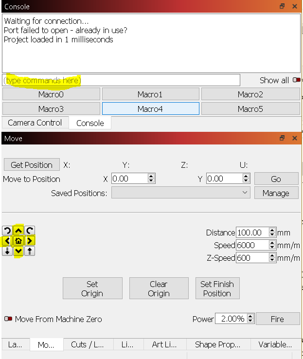

  • .First check if limit switches are working and not triggered.
  • .Check the measures and with laser connected to PC type the corresponding values in Lightburn Console (eg. $131=595) and press enter.
  • .Jog laser head by hand to the middle of working area.
  • .Type $22=1 and press enter.
  • .Run a Home cycle (click home in the Move window).
    ,Then in Lightburn Move window slow jog the laser head to upper right corner
  • .In the Move window check X Y coordinates, when X=495 Y=595 check left distance in the upper right corner.
  • .If there’s any distance left and you want to, you can add the amounts to $130 and $131.

Y-650
X-550
$130=545
$131=645
I tested…now all it’s work perfect
Thank you
