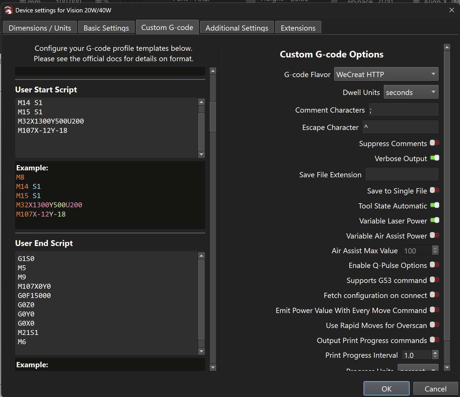

So, it appears to be a GCode device. The “Custom GCode” device type in LightBurn is very flexible. If the laser requires custom commands at start, or to switch between laser sources, those commands can be entered in the Device Settings in the “Custom GCode” tab.
This example is for a WeCreat Vision. They need those start and end scripts at the beginning of a job.
With WeCreat specifically, this was challenging, because they don’t behave according to the GRBL firmware standard as they claim. We therefore created a dedicated “WeCreat Flavor”. Similar to what you saw with the “Creality Falcon HTTP Protocol”
If the manufacturer can’t give you a device profile, can you test this and report back?
