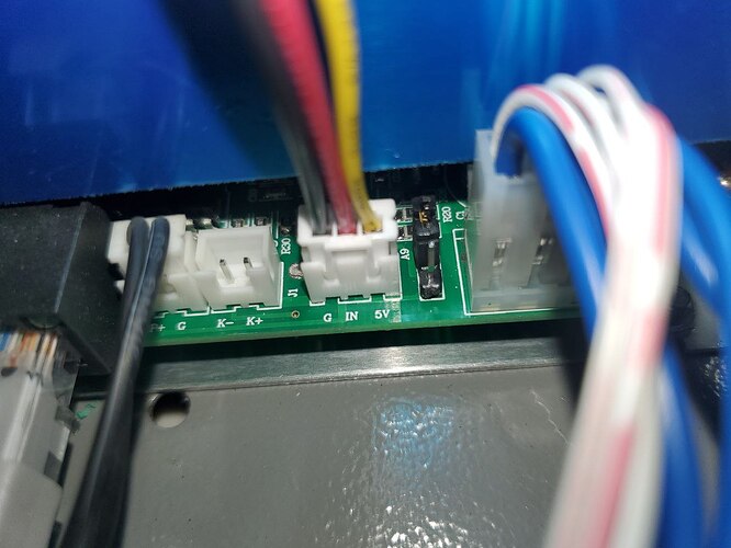

Made this new cable to bring 5v from the power supply to the level converter. I don’t see any useable 3.3v power on the board so tomorrow I’ll use the said buck to convert the 24v pin to 3.3v. (Monport tech support has emailed me saying they will be shipping me out a new level converter, which is what they assume the issue is)

Ok…so I got the buck and self purchased level converter. Pulling up 5vDC from the power supply to the High side of the converter and 24vDC–>3.3vDC from the Monport v2 board through the buck and into the Low side of the converter. Still having the same issue.
I command Lightburn to fire at 100% giving me 3.27vDC on the Board Low Side and 2.84vDC on the board High side. (6mA laser power - Dial set for 14mA max)
At 50% laser power I’m getting 1.69vDC on the Low side and 1.49vDC on High Side

Did you probe the 5V from the LPS to confirm power?
I see a few possibilities based on this:
  1. The level converter isn’t working correctly. Possibly try one of the other channels.
  2. The understanding of your controller working at 3.3V with normal PWM behavior is incorrect. This doesn’t seem likely but it’s possible. Not sure how this could be validated without a scope.
  3. Something is wired incorrectly. Double check the wiring and make sure nothing is amiss.

Ok I just went through these one by one. Used 2 different level converters from the 4 pack.
LPS is supplying a steady 5v to the Level Converter, even while lasing.
  1. PWM —> LV1
  2. LV1 —> HV1
  3. HV1 —> LPS IN
  4. Board Ground —> Buck Ground —> Level Converter Ground —> LPS Ground
  5. Board 24V —> IN + Buck —> OUT + Buck 3.3v —> Level Converter LV
  6. LPS 5v —> Level Converter HV
Ground is not isolated thankfully, that would have thrown me for a loop. I hyperlinked the products purchased in my previous post. :innocent:
Going to try this.
This was a no go. Regardless of channel still same results. It is exactly as if it is just not doing anything.
If you supply a steady 3.3V to one of the low voltage side channels, do you get 5V on the other side?
Just checked, I do indeed get 5v on the high side if i supply a steady 3.3v on the low side.

  1. The level converter is failing at PWM frequency. Do you have another known working PWM device at 3.3 volts that you could test this with?
    $33-$39 have odd values so not sure what these are being used for. Do you have documentation on Monport extended GRBL configuration? $33=1 to mean 1Hz doesn’t seem likely.
  2. Board is not actually a 3.3V device. Board is 5V device but only getting to 66% duty cycle at 100% power. What is voltage at board at 50% power?
  3. Feel like there’s another scenario I’m not considering but can’t put my finger on it.
I was hoping it wasn’t, for the record.
My thoughts exactly, however I don’t have an alternate source nor any documentation from Monport. Going to see if I can borrow a scope. Also, I cant change the $33 value but I’m hoping that it means it’s 1kHz
About 1.645vDC
There’s a clear voltage drain somewhere on the 5v side of the converter, going to try a different converter. Possibly this one.

Have you tried working with the original converter board as well by powering both sides of the convertor?
Yep, same result. A constant 3.3v voltage gives me 5v on the other side but a PWM 3.3v give me 2.84v on the 5v side. At least it has a green LED that lights up to let me know it’s actually on. and I’m pretty sure I crossed wires on it halfway through testing so it is now toast, Monport is sending a replacement,
This is easily checked along with elimination of the control board and voltage translater.
Put a voltmeter on it and measure it at various pwm values. It should reflect that percentage on each… a 50% should produce output of 1/2 of 3.3V → voltage translator and the output should produce 1/2 of the 5V or 2.5V → lps. Check the output with and without a load

Is there an L terminal on these for laser enable? No L- which is commonly labled as a lps return.

OP appears to have this style of LPS but with the addition of the RJ-45 connector. L is at the far right connector and hasn’t been touched thus far.
