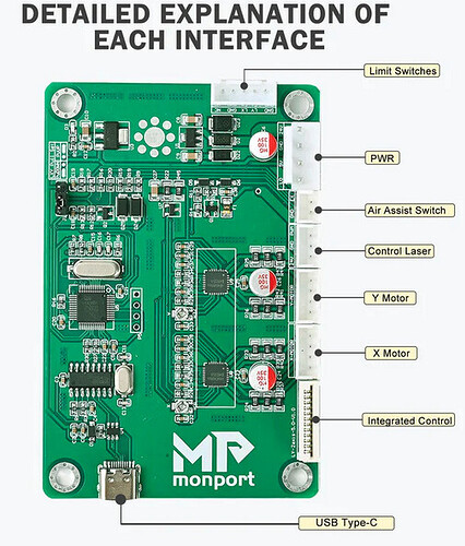

To get this fixed, I think, we need to assume it’s a 3.3V controller → level translator-> lps.
I don’t know what PWM 3.3V means in this context … 100% power should also be a constant 3.3V.
If these are correct, it’s got to be the translator or lps.
I mentioned L because I don’t know how it’s implemented here.
Too bad Monport won’t gives us the pinout or a rough schematic. The installation video is plug and play type instructions.

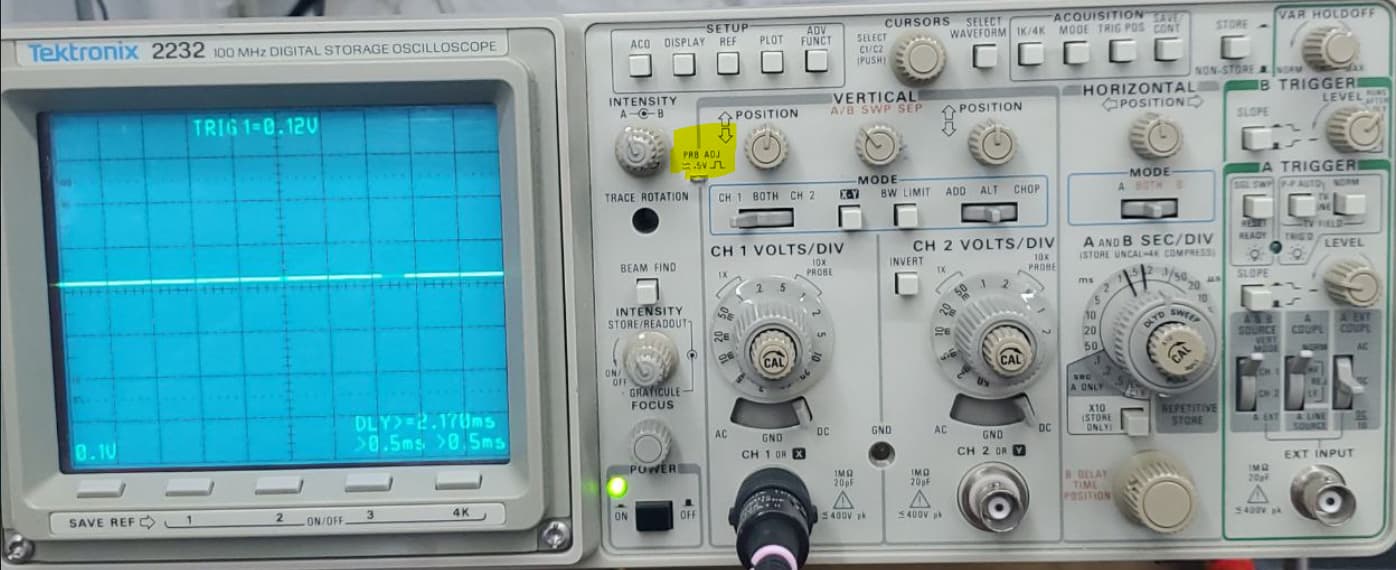

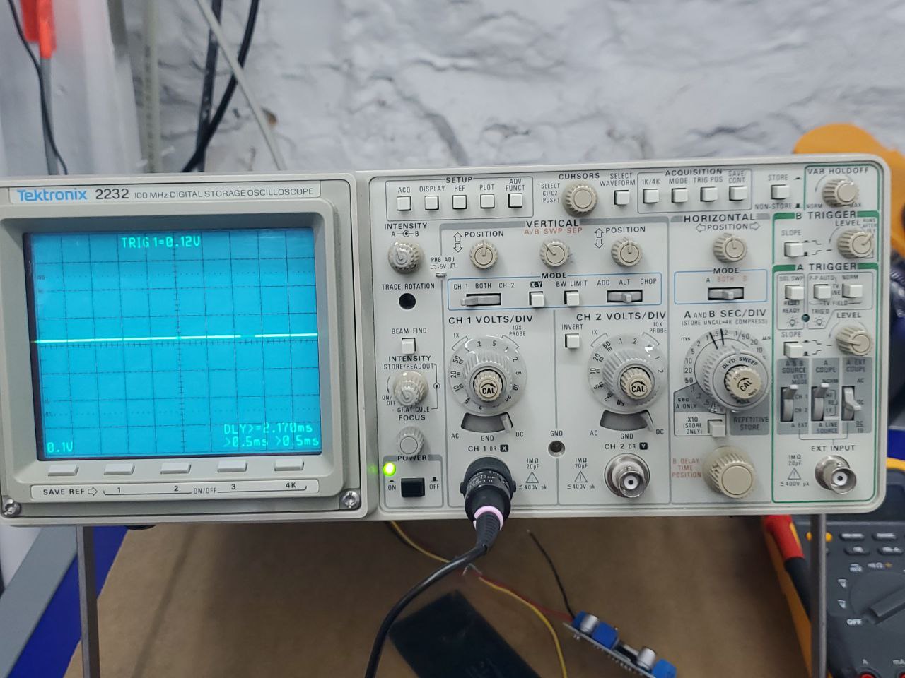

OP is saying that if he applies a known 3.3V to the low side of the converter that he gets 5V on the high side. However, if he applies what’s currently assumed to be a 3.3V PWM signal at 100% duty cycle that he reads 2.84V on the high side.
I see the converter as a potential problem but why the LPS? He’s measuring this before the LPS is in play. As-in on the high side of the level converter.
Note also that using the test button on the remote yields the expected current from the LPS. OP also tested a known direct 5V onto IN of LPS and got the same expected current output. I don’t think the LPS is the most likely culprit at this point.
Given they went through the trouble of a custom PCB it’s seems surprisingly poorly documented and I find it funny that they needed an immediate level converter add-on fix. Clearly something got missed.

The issue seems to come up to the interface between the translator and the lps.

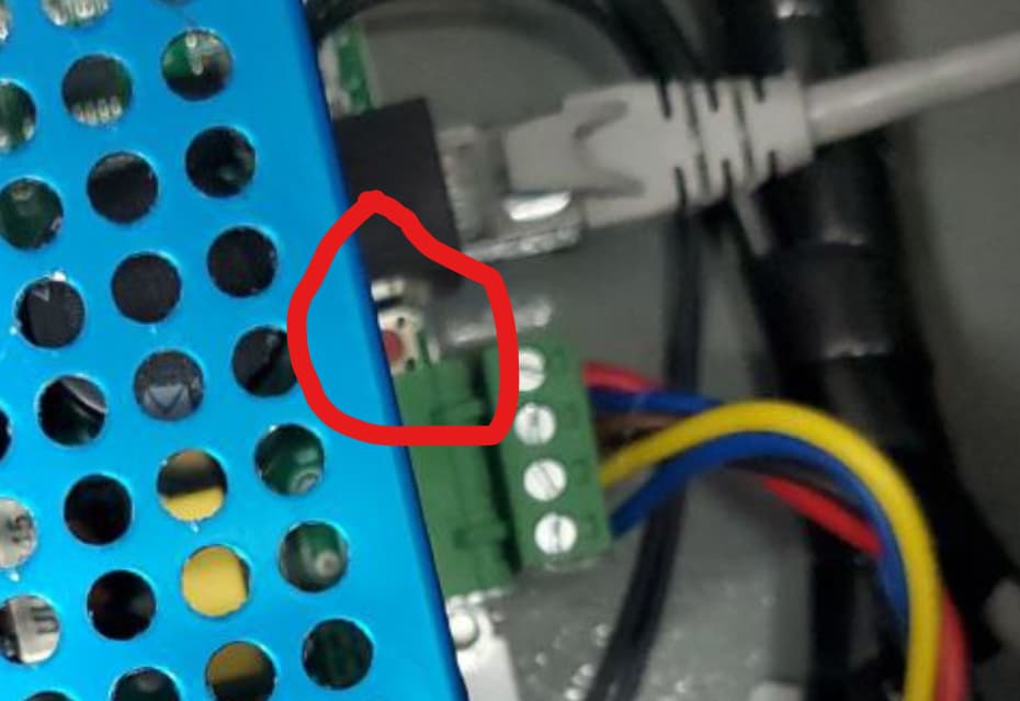

Some of these have a switch on them next to the RJ-45, do you know if his has this?
The first time I saw this was recently with another K40 type. Didn’t realize these could work that way.
Do you mean on the LPS itself?
It appears so:

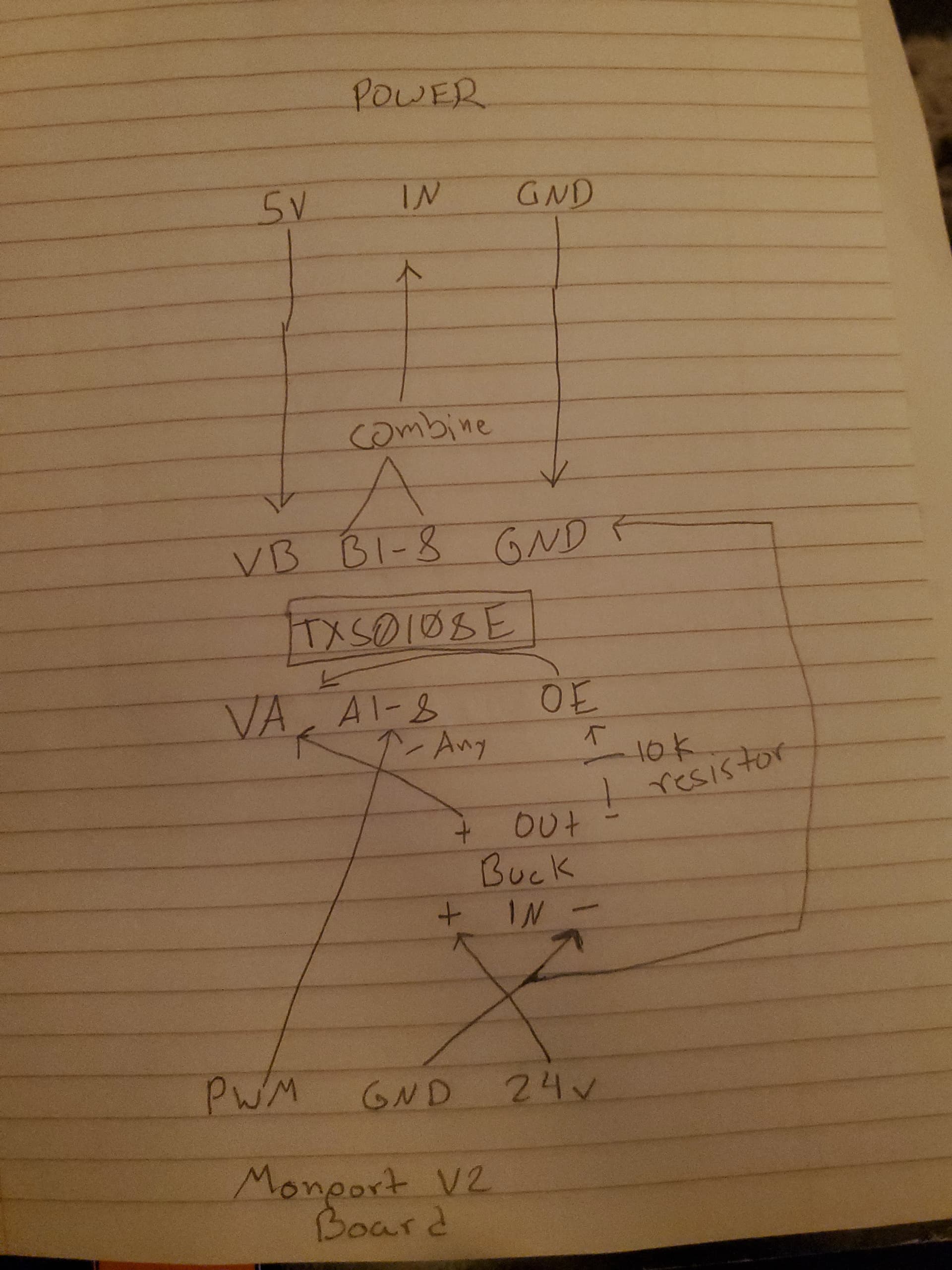

Monport has a board issue that they need to resolve and provide for free to customers that have this issue, of which I assume is everyone with thier K40 Pro w/ V2 Control Board.

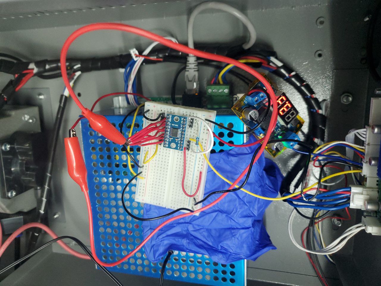

For now, I fixed it for myself. Im going to try to document the montrosity we came up with for the next guy.
V2 Board is supplying 3.3vDC PWM and this TXS0108E is translaying it to 4.49vDC on the power supply IN port which gives me 11mA, after that I dialed the knob on the laser up a bit more to get 14mA. I can get a total of 16mA using this method but not the max of 19mA i get with the test fire button.

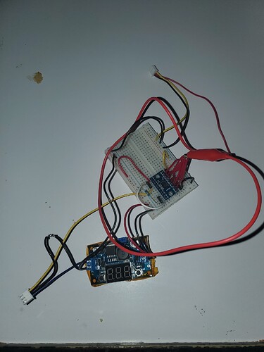

So to confirm, both the original logic converter board and the second converter board were not working correctly? Looks like you have a third board that you’re now using?
That is indeed correct. The TXS0108E, and only by combining all 5v translation pins.
That definitely sounds sketchy. Each channel should function independently as to allow for varying signals to use the same convertor board. But hard to argue with results.
Was thinking the same. But, for some reason, all pins activate and only some pins at 4.9vDC and others at 2.85vDC so I said ef-it and combined them. We’ll see how long this lasts. Only need to last as long as it takes Monport to come up with a proper fix, or I just go ahead and switch boards.
The weird thing is, with all 3 boards, we saw the same result. A 3.3v signal from the board only translated to about 2.85v instead of 5v. No idea whats going on there. The TXS0108E having 8 ports that for some reason all activated is the only things that helped.

Actually seen a sliding switch to disable the panel control… some have said just removing it will work…

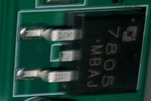

Just received my new Monport v2 board I had ordered (at the same time as this Monport K40 Pro) for my old Omtech K40. It is revision 1.1 and outputs a 5PWM signal.
So, true solution, order a new board. Though, they should still be shipping these out to customers.
Looks like they added a voltage regulator to provide 5V.
