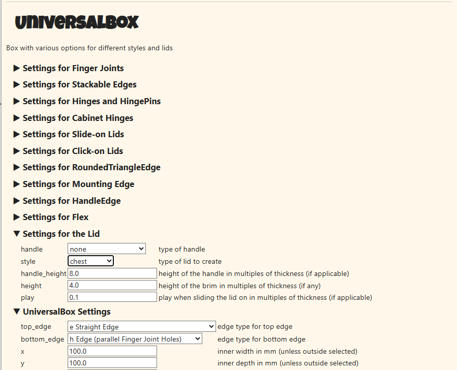

sorry for trashing this topic, but it’s kinda related to the boxes.py generator. I am trying to create a chestbox. Tried out the pirate box on boxes.py, but for the size of my box (about 10cm x 14cm) the lid is way to big (arc to high) and it results in a weird looking box. Then I played with their universal box, which has also the “chest” option as the lid. But it generates a box, with “rounded” lid sides and a flex lid top - but the lid is without hinges. And the lid sides are the same as the sides of the box - so also not meant as “over the top” lid. Has anyone ever tried this out? How should I mount the lid onto the box?

I used the universal box and lid type = chest

That looks like a “lid sit on top” box with no hinge. Did you mess with the Settings for Hinges and Hinge Pins option?
Yes, tried and played around, but didn’t find an option where some hinges would appear :man_shrugging:

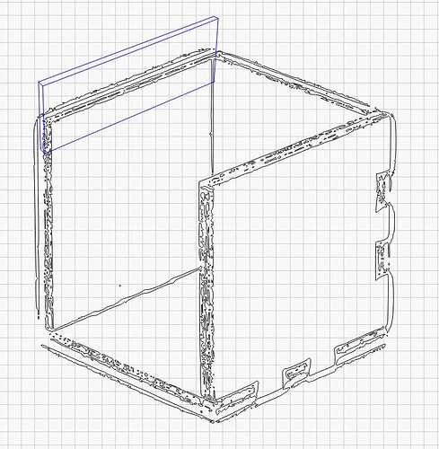

Don’t understand? What should I do with the cut out flat without the flex? I tried to cut my svg and the lid sits perfectly on top of the box. Maybe it was meant to use some duct tape to hold it in place? :astonished_face:
With a lid that just sits on top, you can add some strips inside the bottom section that stick up a little above the sides. Forgive the quality of my artwork, but Lightburn was the fastest for me.
Correct, and I’m also using Lightburn for such sketches last years - habbit. And cool, thanks for the tip. Also had that as an optional solution - also tried such solution once with another box. It would be an option but it’s not what I’m looking for this time. I’ll close the topic for now. Thank you all

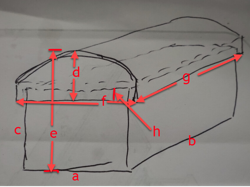

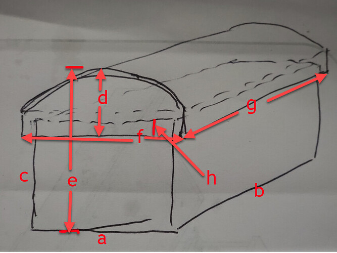

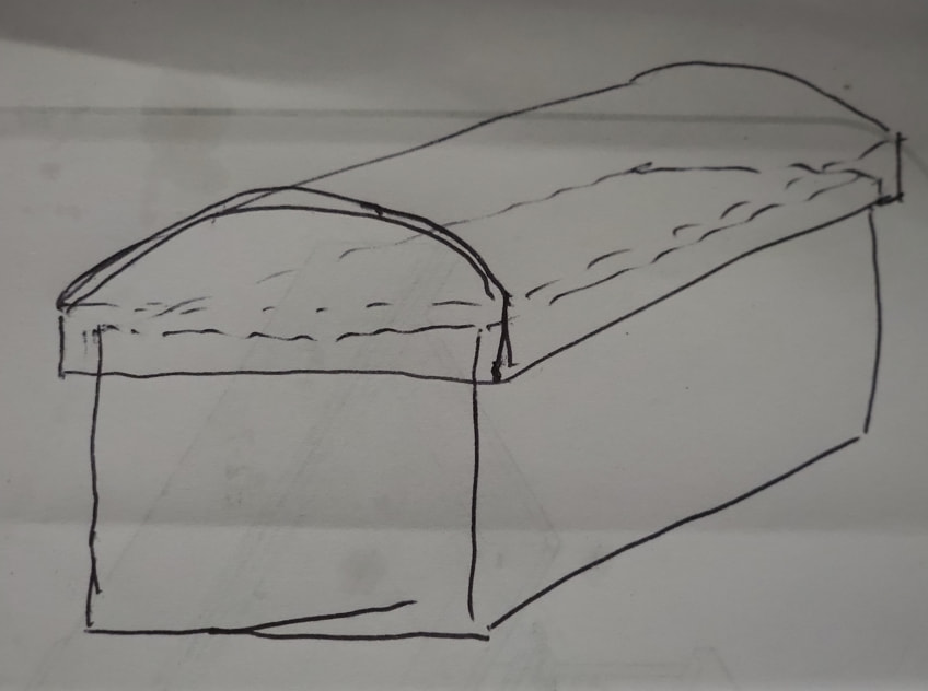

Were you looking for a box like this? … but with a hinged lid?
I was and still am looking for a pirate/chest box which would have a lower lid (not that high) - because it really looks weird when creating a smaller box (about 14cm x 10cm and height around 4cm). In that case I get a box with 4cm in height and a lid which is 8cm high.
Please give your dimensions and material thickness?
You want the lid over the edges right? by how much (h)?
Material thickness is what?
And needs to be hinged but doesnt matter how? and needs to hold open at about 110degs?
