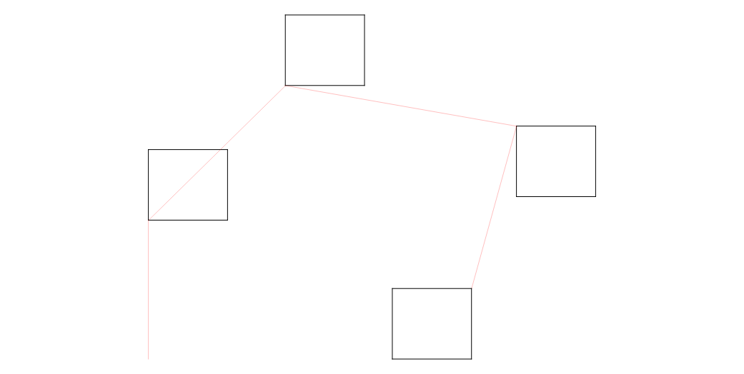

Could you please do the following test:
_tranverse_move_test.lbrn2 (3.8 KB)
  • Before testing confirm the job preview looks like the below picture

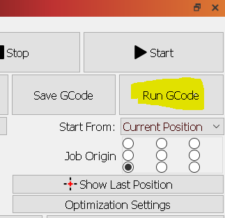

  • .Run the above file with 6000mm/m speed and 0% power.
    *Then Run GCode the follwing file.
_tranverse_move_test.gc (397 Bytes)
Tanks.

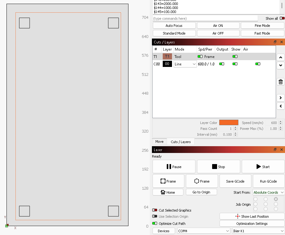

Here is a basic example. Just two layers. One is a tool layer assuming some random pre-fab blank that need four holes cut in the corners. Maybe a bottom side table shelf. It doesn’t matter.
I tried a few things I could think of.
  • It’s not traversing at the cutting speed. It’s a fixed traverse speed regardless of cut speed. Cut at 4000 and traverse is slower than cut speed. Cut at 600 and traverse is faster than cut speed.
  • It’s not traversing at the framing speed. I tried several from 2000-30000mm/min
  • It’s not traversing at whitespace speed. I tried it disabled and enabled with the same speed range as the framing speeds tested above.
  • It’s not traversing at home seek speed. I tried a few.
  • Maybe a few others …
    None of those had any effect whatsoever.
Note: I typically run in “standard” mode (see post linked in earlier reply) which has max rates of 30k(x) and 20k(y), X accel at 2000 and Y accel at 1000. Near as I can tell with a stopwatch, it’s traversing at around 2500mm/min in that mode.
Since I know Ikier is playing a little loose with grbl, I decided to see what happened when I changed to “fast” mode. This mode substantially increases max rate and X accel. Y accel is unchanged.
***In “Fast” mode, it FLIES around the bed. Far too fast, IMO. I adjusted the parameters for both fast mode and standard mode. Traverse did not change, so it’s not a simple multiple of the max rate. It seems to be a fixed speed determined by the mode selection.
I poked around the parameters and didn’t see anything obvious that would control rapid motion.
I tamed down the fast mode settings some and got it traversing in a range that seems reasonable but testing must be done to confirm no corner ringing has been introduced.

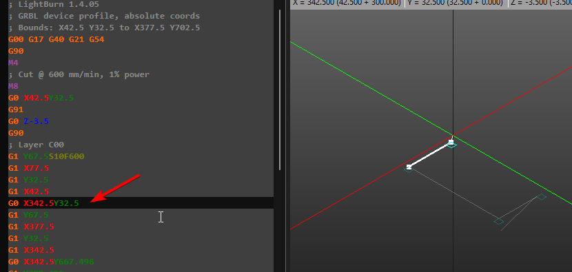

As PY requested:
slow traverse.gc (500 Bytes)
I can confirm that G0 is being used for the traversals.
Your findings corroborate that this is being firmware driven. My guess would be that it’s a fraction of the max speed. So if Fast mode attempts to run at full max speed then perhaps “Standard” is 10 or 20% of max.
Check to see if you have any non-standard GRBL parameters that could potentially represent a multiplier or percentage value.
Interesting no F value is given on the G0
So it defaults to the Layer C00 initial F600
