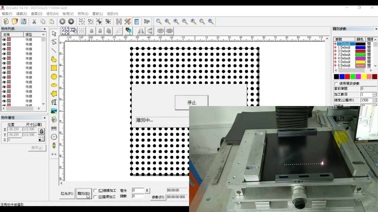

EZCAD2 has a relatively little-known feature accessible from the calibration page using the Ctrl+E key combination in the F3 menu.
It allows the user to create a dense calibration grid and specify an offset correction along the X/Y axes for each point.
For example, a 21×21 grid contains 441 points:
Each point has only:
ΔX
ΔY
For example, if the desired coordinate is X=25.00 mm, but the optical system actually places the mark at X=25.50 mm, then the correction for this point will be:
ΔX = -0.50 mm
There is no need to create any new complex optical models.

Below, I’ll share a video demonstrating how to use this in EZCAD2 or other controllers if I can find one:
Ezcad2 (I only found promotional videos on youtube for the calibration software, but these are the only references to the Ezcad functionality described above):
“watch?v=BMYxHhlZeMc”
“watch?v=wrYFkPA0RL0”

Here are the full links to the videos:
The examples use something similar.
In one, they measure distances using an already calibrated camera and some software. In the other, they use a printer scanner and some kind of recognition software as well.
But to start with, it would be great to have local correction capabilities.
As for a quick method (like the one in the video), that’s a different matter—one that everyone can do in their own way.
