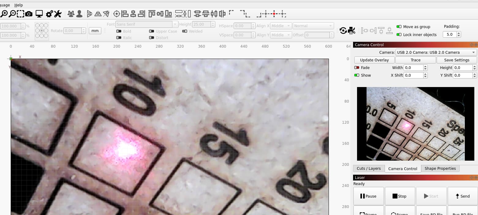

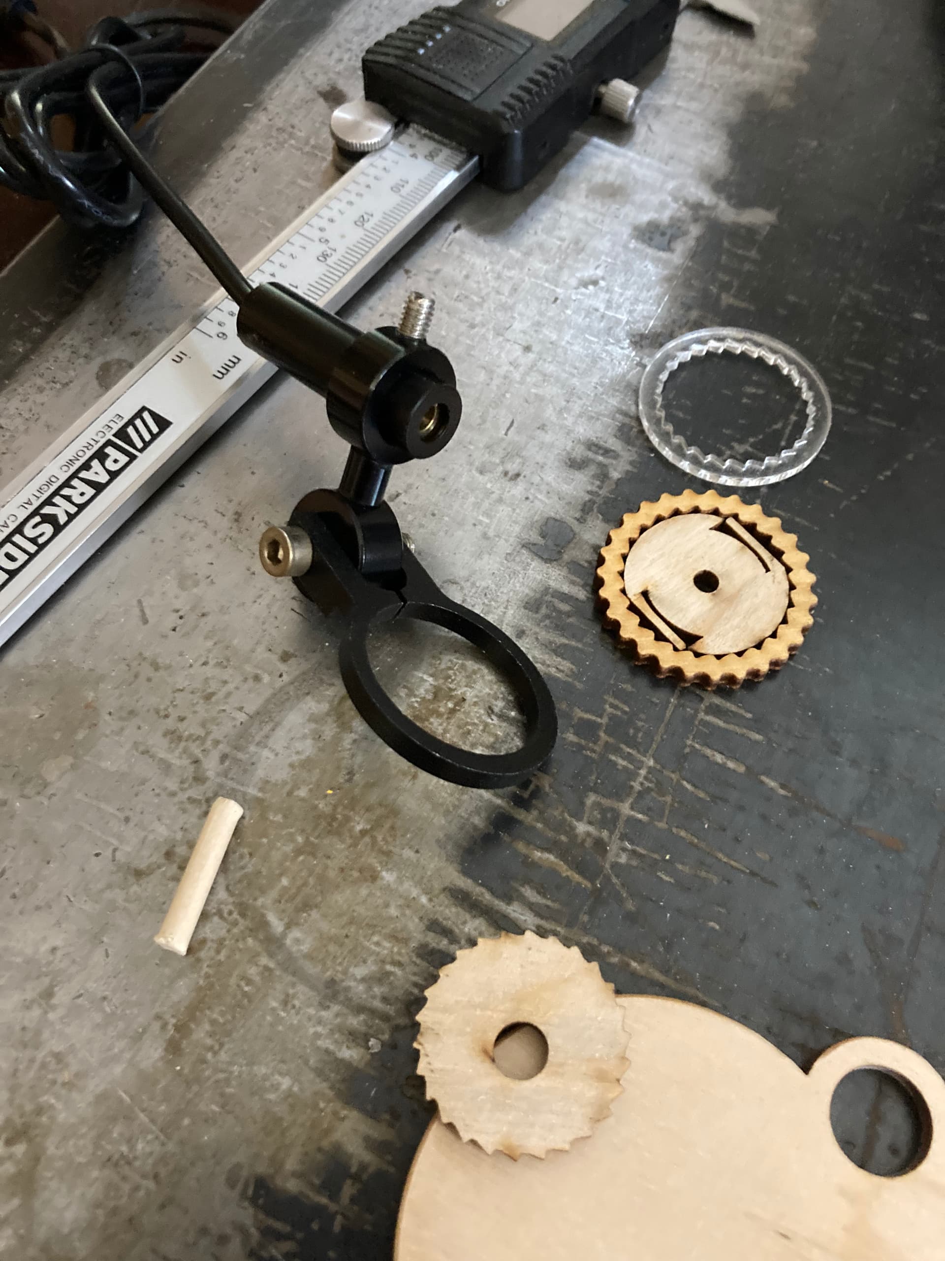

A few years ago I made a holder for a camera that was mounted directly at the nozzle. As a camera I used a small cheap endoscope camera. I got the result you are looking for and could use it further for laser placement.
The problem this time was that during glass and stone engraving and possibly laser reflections, this camera was destroyed - but it worked, almost like a live microscope.
See also Head-Mounted Camera Alignment - LightBurn Documentation

There are many … mine is in the style of it from photo.
This is what it looks like with such a camera
It’s the modified, last holder, the first one was made in MDF and also worked fine.

I’ve never used a phone app for it, i use it directly per USB and select this camera in LB.
(Linux, Mac OS and Windows)
That is what I’m glad to hear. I going to get one, thank you !! No matter what kid of camera you have, (like you said) reflecting that bright light into the lens will kill any camera, unless made for that purpose or good filters.
