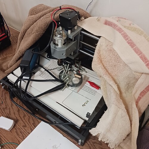

I learn something new everyday. I have a cnc router that I bought back in 2021 shortly after I joined L.B. It’s one of those SainSmart 3018. I think its working area is 9x12" maybe !! I set it up / hooked it up, with out a bit in it I ran the test program just to watch it move back/forth and up/down. I thought --well thats cool and then I covered it up with a couple of towels and never went back to it. It was to small for what I wanted to do. I even ordered a nice set of bits for the thing.
One of these days I’ll get back to it. I hope !!

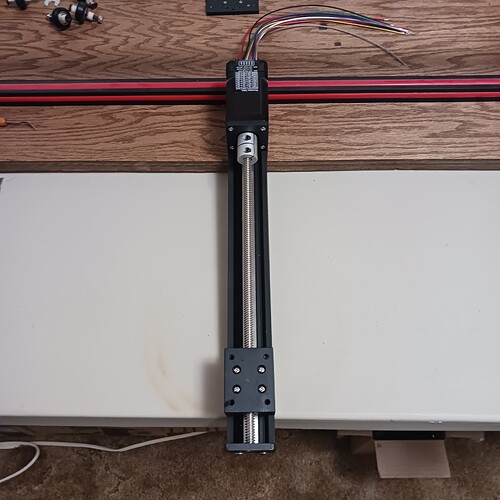

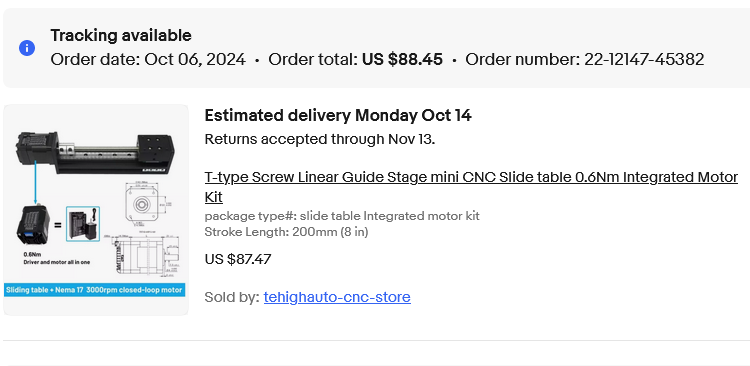

Great news turned out not so great! My plan for putting a nema 17 on my z lift replacing the Nema 11 that’s on it. The z lift that I bought appears to be pressed together and I can’t swap out motors . So after several hours of searching I finally found a z lift linear actuator that is the same size as my first one and the new one has a Nema 17 motor and it’s 12v !!! Another 10 to 15 days before it gets here.

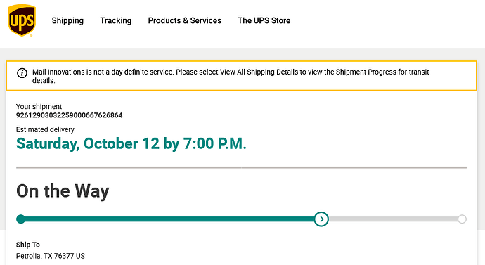

Well there has been a shipping problem with my new actuator. New arrival date is 10-9 thru 10-12. Oh well, better late than never. I didn’t want to leave people hanging up in the air on progress. So bare with me for a short time more.
Randy
New arrival date. I’m starting to get tired of waiting !!!
Randy
Well now UPS says I will get it on Sat. 12th.
At least this time they say it’s going to on time, the first due date.
Randy

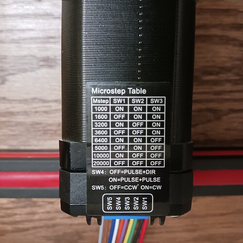

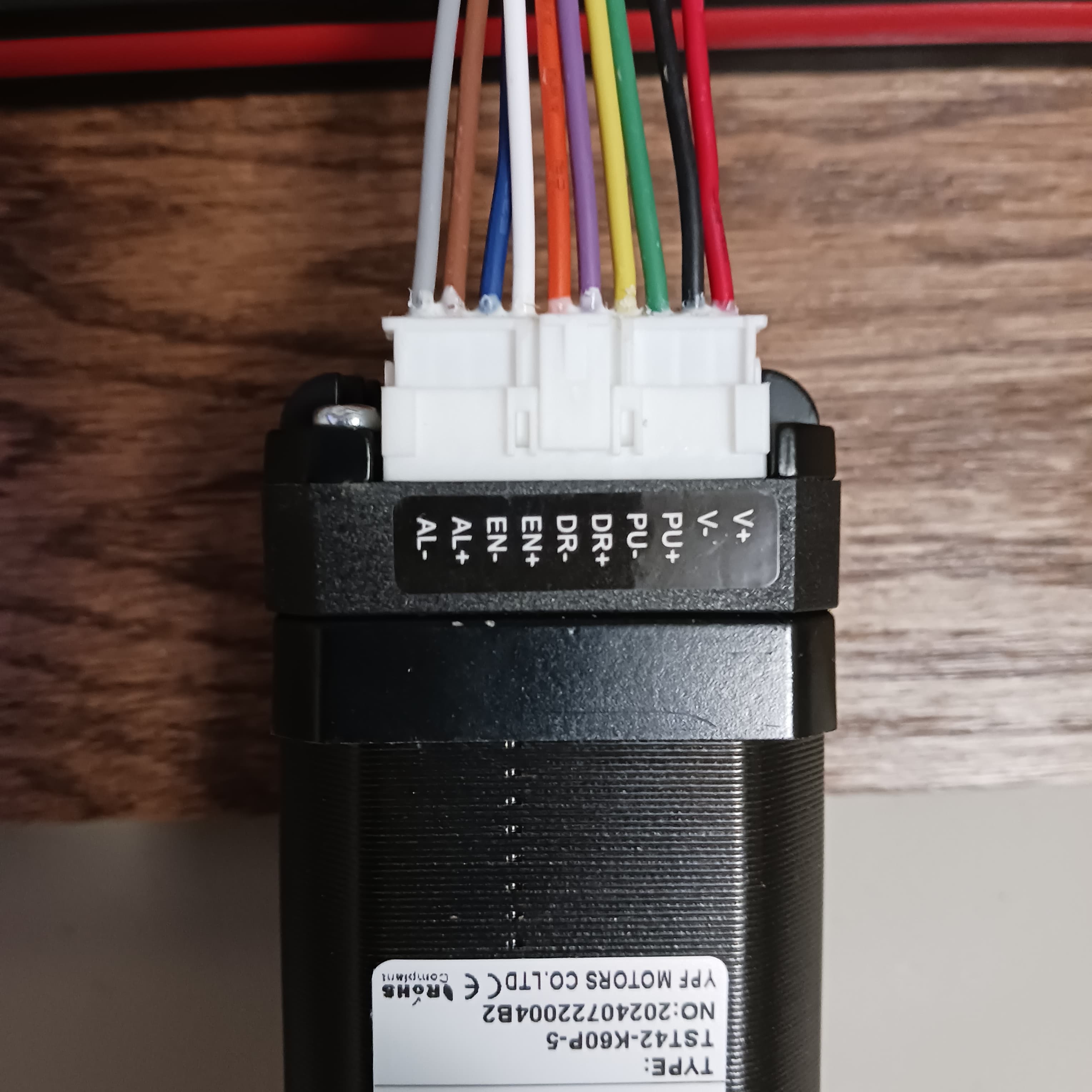

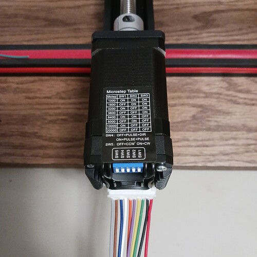

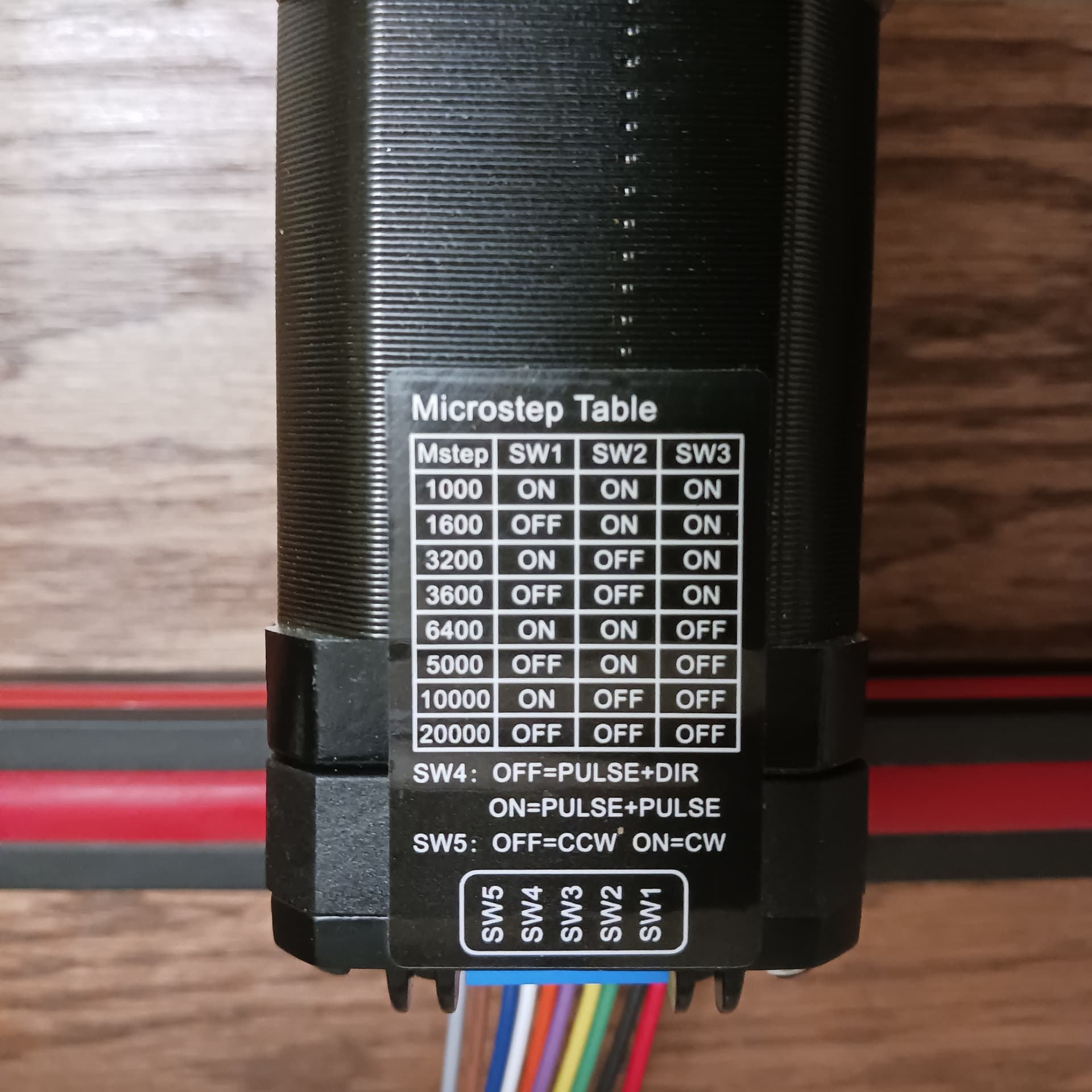

I got my new actuator in last Sat. I didn’t get a chance to open the box until last night. I love it !!! It’s going to work just fine !!! 200mm travel with a nema 17 hi torque motor with 5.2 kg of vert. lifting power/force. It has its own controller built into the top of the motor. Just one little problem, at the present moment I don’t have any wiring schematics to this thing. Ok, whats so hard about wiring up 4 wires? Nothing to it !! Only what do you do when this thing has 10 wires coming out of it ? Does anyone out here have a set of schematics to this thing ? I could use some help with this thing. PLEASE !!!

Been following along. I haven’t seen AL+ or AL-, rest are typical microstep driver abbreviations/ connections. My guess AL is ALARM? for limit switch. EDIT: Closed Loop Driver. I know nothing about closed loop microstep drivers. :sunglasses:
I see the typical Pulse, Direction, Enable, Alarm, and Voltage outputs. The motor driver is attached to the back of the motor, rather than on your controller board itself - but one of our company 3018s has step/direction breakout pins, so you could be fine.
You’ll likely want to set SW4 to OFF

Yesterday I went ahead and ordered another motor, Nema 17 hi-torque, 4-wire with a short shaft. Short shaft as in 15mm long. I liked to never have found one with that short of a shaft. I have a couple of 17s, but they have 20mm shafts. I was thinking about using one of those but I don’t think it be that easy to cut 5mm off. And they are not hi-torque. As for this 10 wire jobber, I never could get any ohm readings for the phases. So I think this one goes into the “what not” drawer.
I’ll have the replacement in a few days, it’s coming from the “Kentucky Hills” by way of USPS. Kentucky to Texas, about 7-10 days. I’ll give you another U.D. in a week plus a few days. Right now I’m laying the new holes to mount the new actuator block to the carriage front plate.
