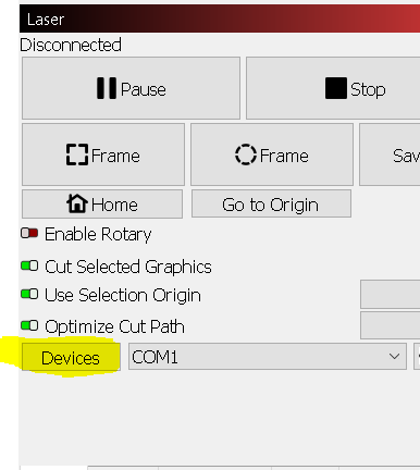

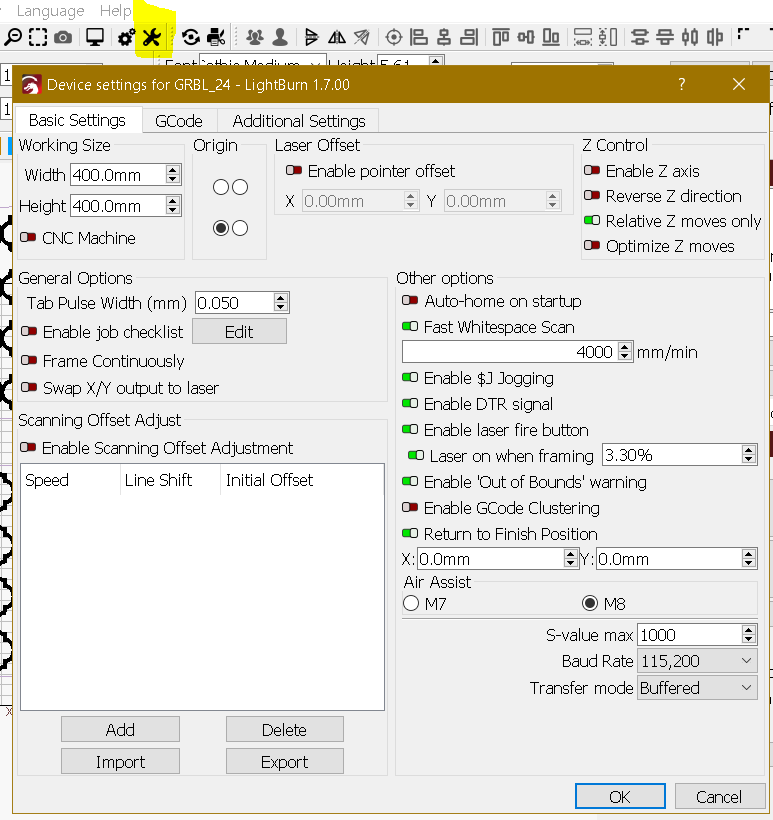

Paste here an image of your device settings.
Click Devices button an past here resulting image
Type $$ in Lightburn console and copy/paste here the output.

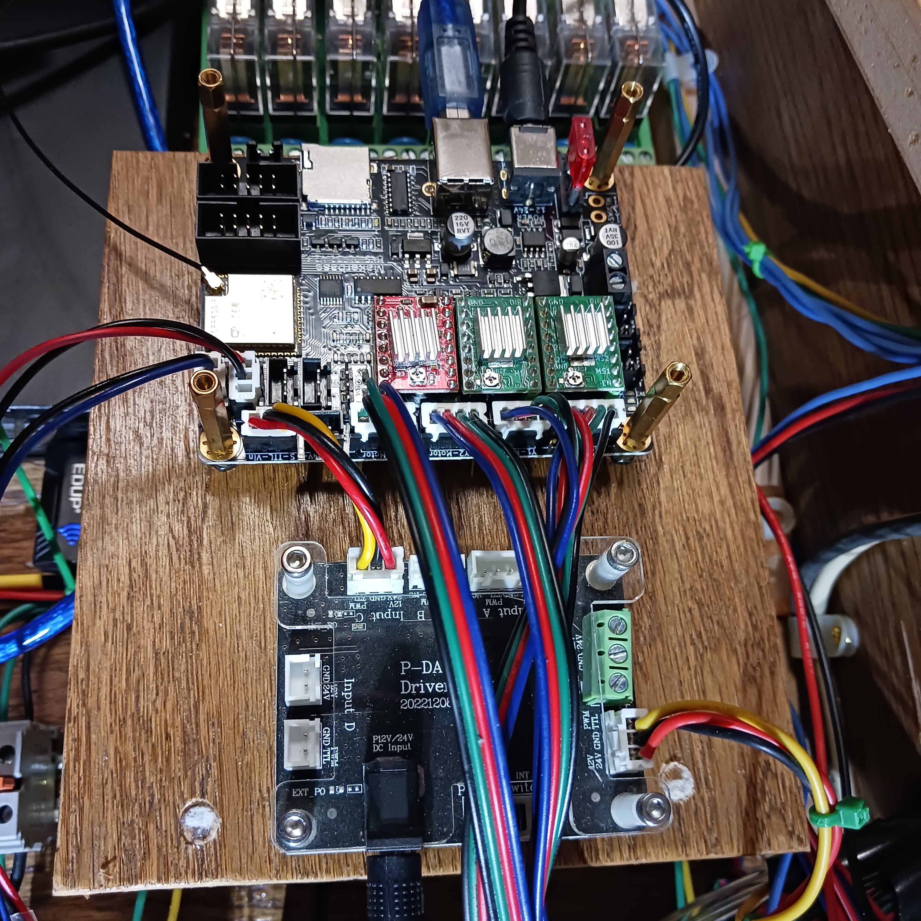

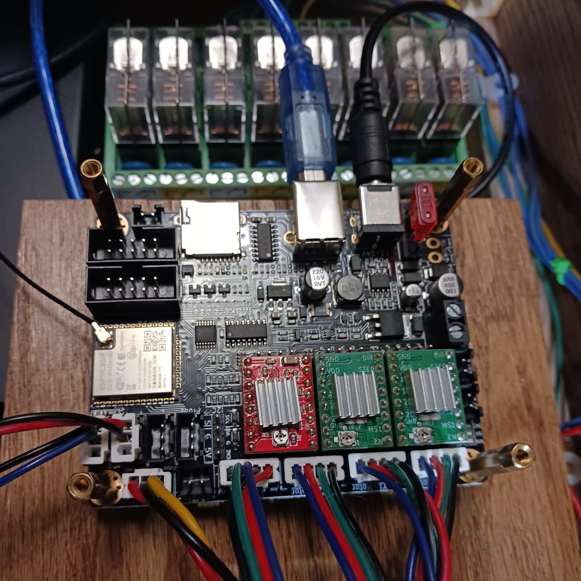

Your Lasertree LT-4LDS-V2 came with an adapter board, are all plugs well plugged and the switch in the right position?
The LEDs of the adapter board are lit (power Led ON, PWM ON when running a job)?
Hello Parsec - Yes I did, even had to manually create my g-code. Everything works as it should, only still has same problem with the laser itself. I even hooked up the controller to a second PC with LB and again everything works as it should, but it still has the same laser problem. I have tried the laser with and without the driver board, same problem. My MKS is powered by a 24 volt - 20 amp power supply so I don’t need the driver board. At this point I think the problem is the laser itself. I finally found an email to support at Lasertree and sent them a note requesting electrical schematics to the laser. Now the waiting game.

A new update: The problem is the laser itself. I unplugged the 24v. power and unhooked the lasertree laser, then I hooked up an old 12v ortur laser and its power supply. Ran a test and EVERYTHING works perfect!! So far I have contacted Lasertree three times now and still not a word back from Lasertree support team. I now feel that lasertree is a fly by night trashy company. Screwed me out of 300 bucks!

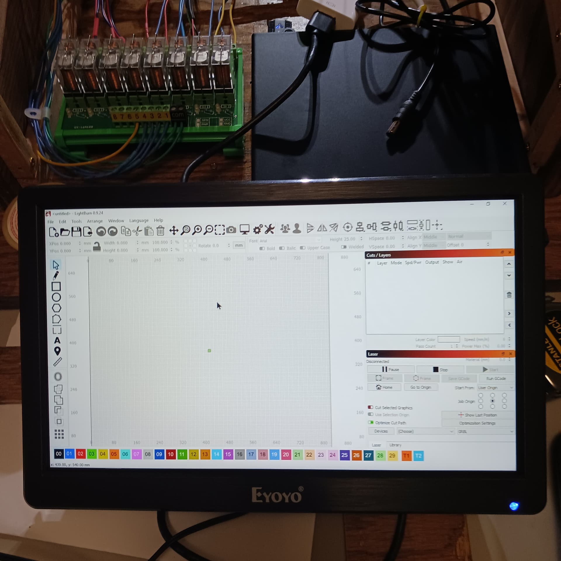

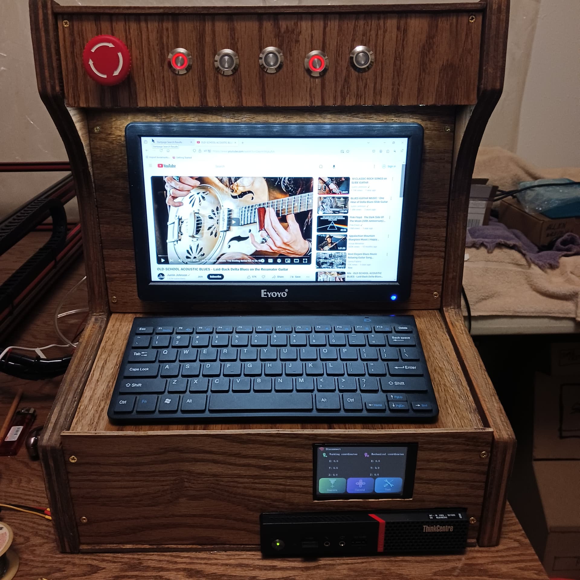

Hello All: I got my screen size problem solved. I went from an 11" to a 12" screen.
Everything can now be seen. I’m happy. I found a 12" screen for $45 plus tax and free shipping. ------ After 4 emails and 16 days later I finally got an answer from Laser Tree. In fact I got 5 or 6 emails and they are bending over backwards to help me. I told them in one email that I wanted to fix this one and not get a replacement. So they sent several pics of the guts and they even sent me the schematics to my K-20 as well as some disassembly info of laser, press here, press there, pull here and get a bigger hammer!! Anyway, here is a shot of the new screen and everything can be seen now.

WOO HOO !!! I got everything working right , FINELY !!! What was the problem?
It turns out to be the USB to Controller board cable was faulty. That was the only thing I failed to check and that was it. I have a bad habit of buying one to use and one to loose.
When I thought about the cable being bad, I got the cable out the spare controller kit and that one worked. I feel really stupid sitting here thinking how I spent 4 to 6 weeks crying and trying to fix this thing and never thought of checking the usb/controller cable “UNTIL” tonight. Yep! Tonight as in a couple of hours ago!!! Now its time to mount the new screen and button things up for now. I’ll post a pic or two after I button it up.

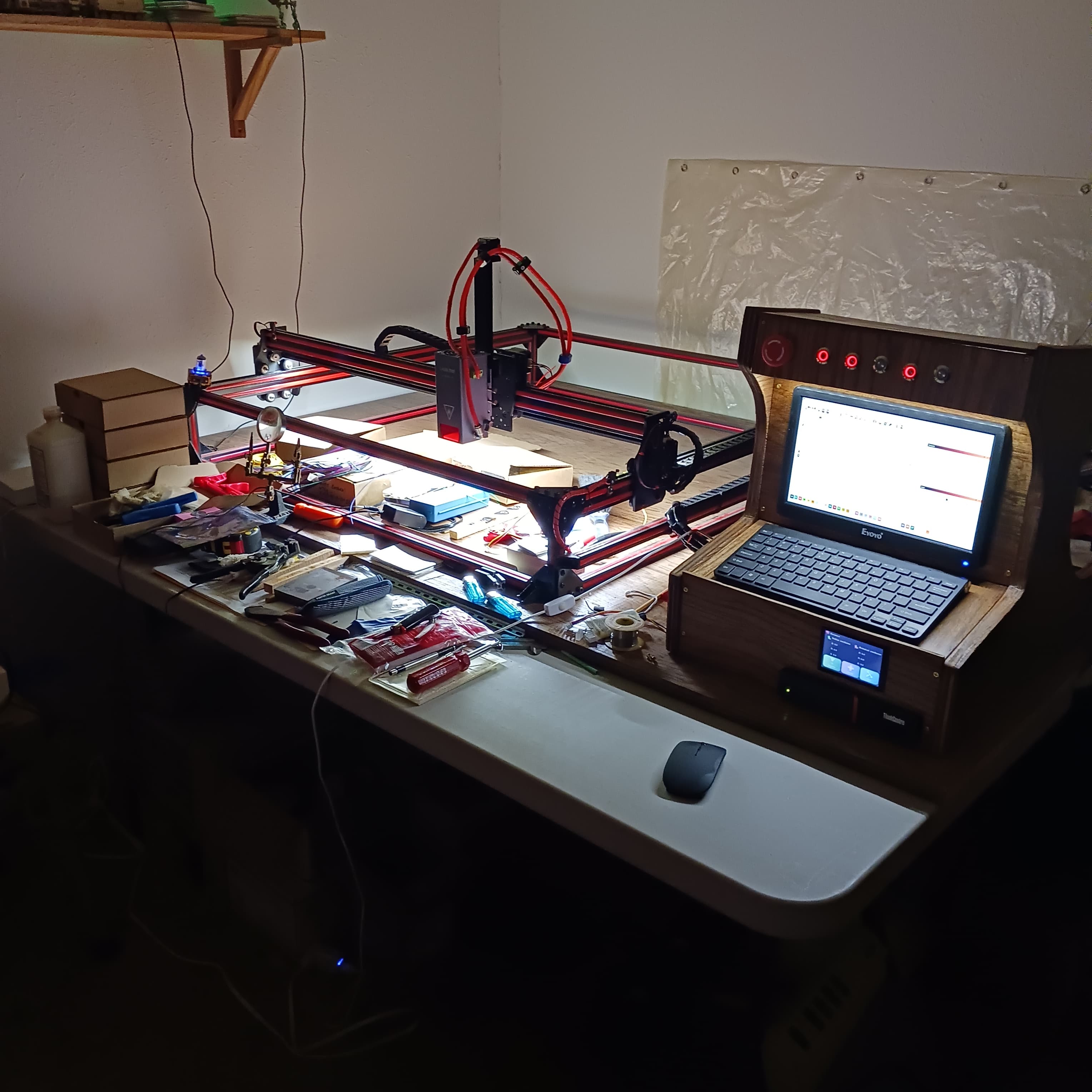

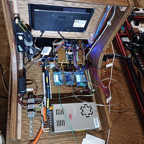

Ok – here is the console buttoned up from the front.
Next is back side, there are 3 pair of wires hanging right now that come from 3 spare relays plus another pair for 2 console cooling fans. Also you will see the air line coming from the laser.
and last is a pic of the whole thing mounted to 4’x6’ sheet of 3/4" stained red oak. Just over look the tools and parts still laying out!
More info coming later, I’m starting to order parts for the gas evacuation box which will be a big box. (46" W. x 45" D. x 21" tall) If I’m lucky I might be ready to make my first cut/etch project in time for Xmas.

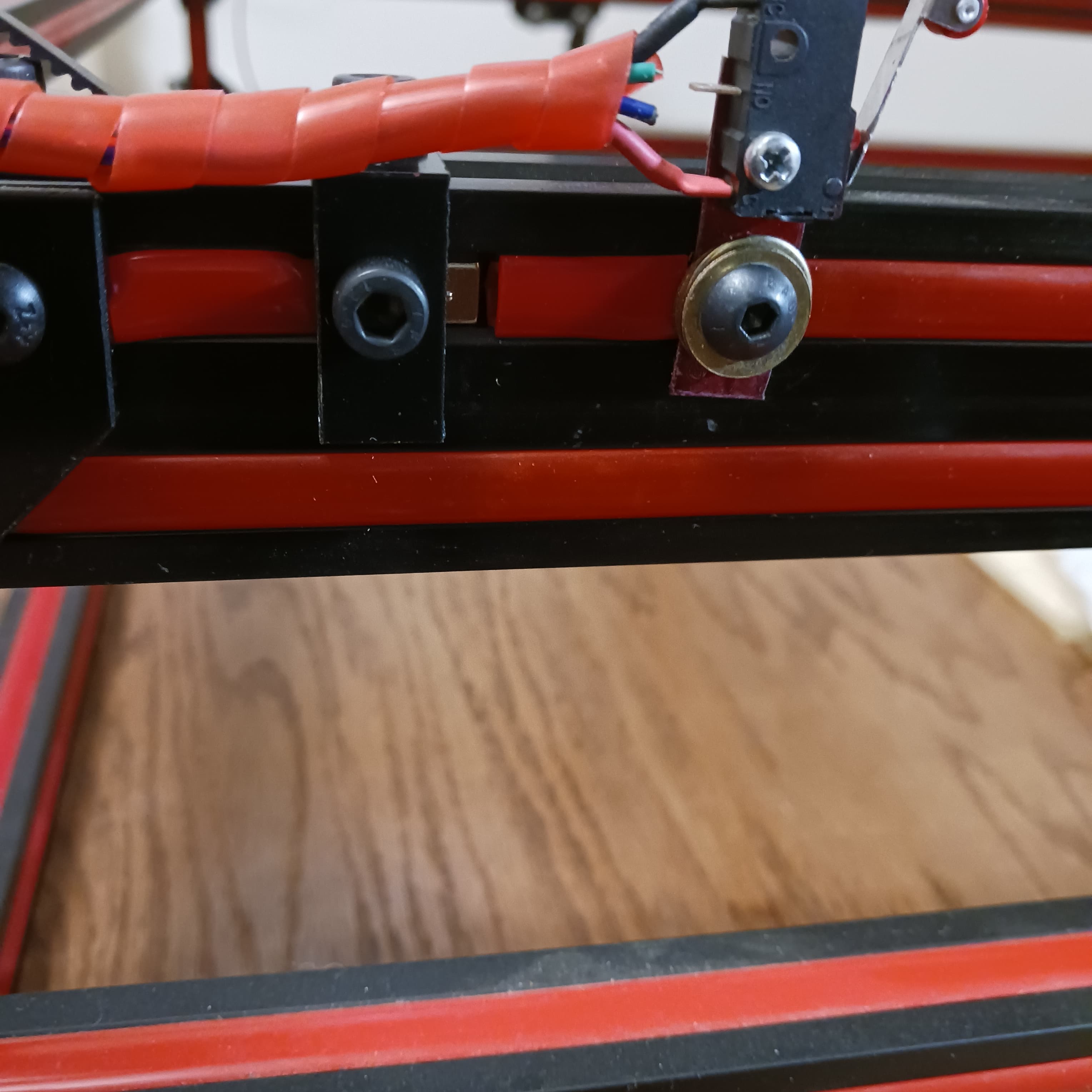

I got my “X” drive cable install, works good. Now for clamping down the two “Y” drive cables. I cut four pieces of 1" x 1" x 2mm aluminum angle iron and drilled one hole so an M5 screw would slide through on one side and drilled a smaller hole on the other side and tapped out that hole to M5 screws. Looks good, I thought it wold work great. Then I ran into a problem, I discovered that there were only and barely 3 threads in the alum., (2mm thick) for the screws to grab onto. When you tightened the screws tight enough to hold the drive cable, (timing belt) secure it would strip out the threads in the alum. Time for another drive to big city for another piece of alum. at 1/8" thick. That should work!
Anyway, here is a couple of photos to show what I’m after.
And I was going to make test runs tonight also.
Not now, maybe tomorrow night!!

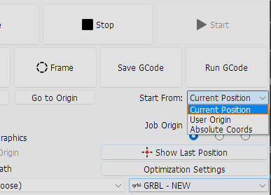

I need help PLEASE !!! My problem is this, I make box/square in light burn and I place this box/square in the center of my grid and I click frame. Works great, now move that box/square to another location on the grid and the laser should move to the new location and do its frame thing. Well it doesn’t do that, it just keeps framing in the center of the grid. If I change the size of the box/square, the laser does not frame the new size, it only frames in the middle of the grid and still only frames the original box/square. If I trash that box/square and draw a new one in a different location on the grid, the laser goes to that new location, does its frame thing just fine. After that it only does the same thing as I mentioned above. One more thing is that no matter how small or big the the image is, Light Burn keeps saying the image is out of bounds. One more thing, when I move “Y” axis to the front of the laser bed and tell the laser to move to the back end, the laser only moves about 75% of the way back and then acts as if it hits an invisible limit switch and stops and you cannot force it go any farther back. Does anyone have any ideas on to correct this problem? I also found nothing so far in You Tube pertaining to this problem.

What is your ‘Start From’ set to?
If ‘Current Position’ or ‘User Origin’ that could explain framing in the same central location.
Colin:
I have been using “User Origin” for 3 years now on 4 different lasers. Set Origin is like telling the laser this is your starting point while Set Finish Position is like telling the laser this is home now and this is where you go when job completed! I keep both settings in the center of my grid so my laser always starts for center of grid and returns there. If I set a project off from the center grid and I hit frame or start, the laser runs over to project does its thing and then runs home (new home).
