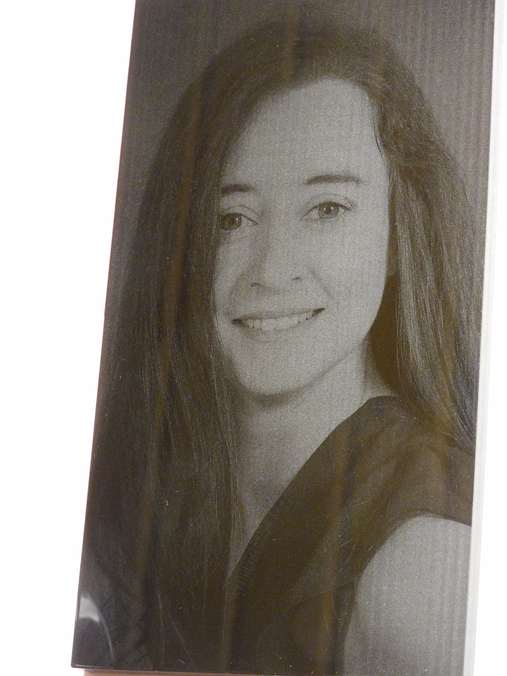

My first try with a photo on black Acrylic /445nm /Ruida
450dpi jarvis 1 pass at 25%, 1 pass at 35%, 110mm/s, (5.5W 445nm), just gotta find out where the curtains come from
Looks great… :+1:
I think the ‘curtains’ may be due to ‘DPI’ if you adjust up or down you’ll see they disappear from the ‘preview’…
no it comes from the machine, nothing in the preview
How did you do 2 passes at different settings
I let it run on 25% and as the result was not white enough when it was finished I changed the max value for this file on the controller to 35% and let it start again.
I hope you can get rid of the annoying lines, your result will be even better, great work.

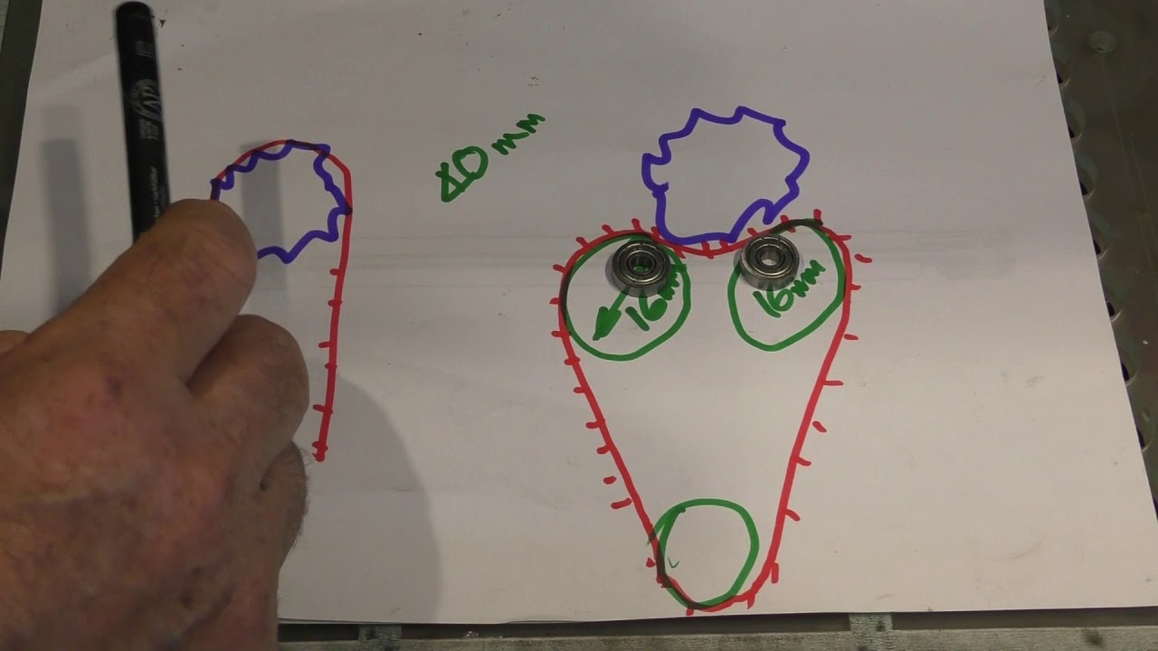

I remember seeing a video on youtube, the guy had similar problems with curtains,
He changed the stepper cog shaped bearing on the stepper motor for a larger one to get rid of the curtains, not sure if he replaced just one or all of them.
It’s an Rdworks vid, don’t remember off hand but if i see it again i’ll let you know.
It’s RDworks learning lab 189.
I have changed the pwm and it is way less I think, unfortunately the backside of my acrylic had some kind of finish which… you can burn through… :frowning:
unfortunately because the rest did not look bad at all.
Shame it was looking to be a good pic…
Looks like you cured the problem though. :+1:
it is still running but more dpi helped making it more white,
running at 250mm/sec now

There it is, the curtains are still there but hardly visible
I would be perfectly happy with that (Great picture) :+1:
(can always find fault in your own work)

It is a Kehuilaser “50W” 300x500mm Co2 with a 5.5W Diode laser mounted next to the Co2 head, this was done with the diode laser @ 250mm/sec

250mm /sec it was 900 dpi, 75% power of 5.5W,
plate is100x180mm, distance from the body of the laser to material is 38mm
Ran it once, about an hour, would have to look on my laser.
