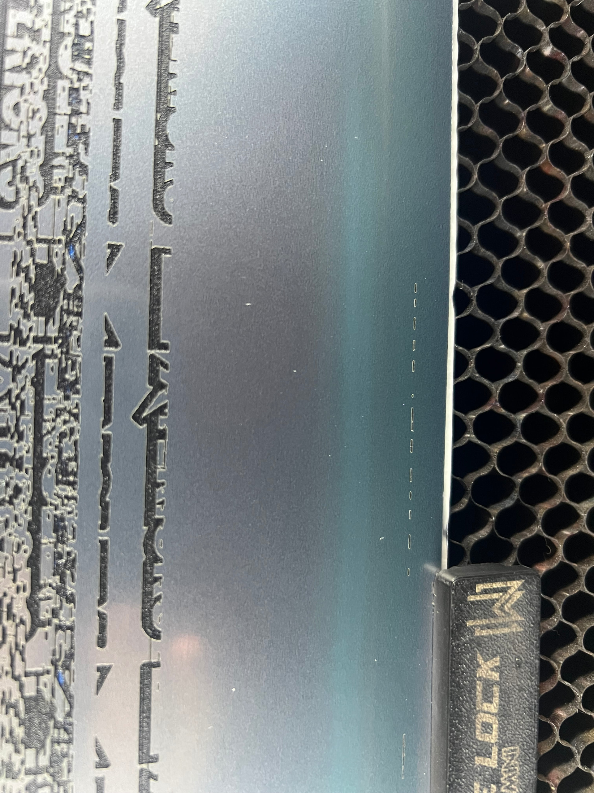

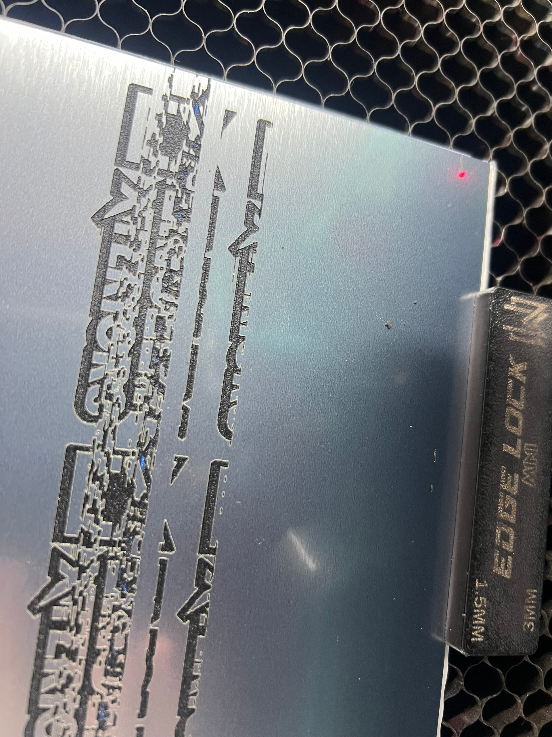

My laser is doing something insane and I have no idea why
Laser just started doing this today, no clue why but any ideas would be greatly appreciated. I can’t upload the video but it is randomly moving up to places in the workpiece that it shouldn’t also like the controller is malfunctioning

Yeah booted up, framed fine and ran okay for the first bit
As a rule of thumb, if you haven’t changed anything in LightBurn, don’t change anything in LighBurn.
Assuming the PC is connected to the controller with a USB cable, most likely the cable / connectors have worked loose or failed.

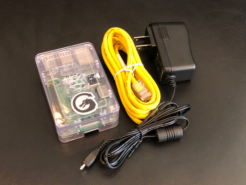

There is also the Raspberry PI…
It’s discontinued, but you can still build your own. All it takes it to load their software on an SD card and boot it… The article explains how to do this.
