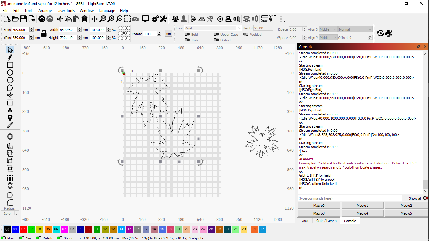

thelmuth:
ok
$h
ok
[G54:0.000,1030.000,0.000]
[G55:0.000,0.000,0.000]
[G56:0.000,0.000,0.000]
[G57:0.000,0.000,0.000]
[G58:0.000,0.000,0.000]
[G59:0.000,0.000,0.000]
[G28:0.000,0.000,0.000]
[G30:0.000,0.000,0.000]
[G92:0.000,0.000,0.000]
[TLO:0.000]
[PRB:0.000,0.000,0.000:0]
ok

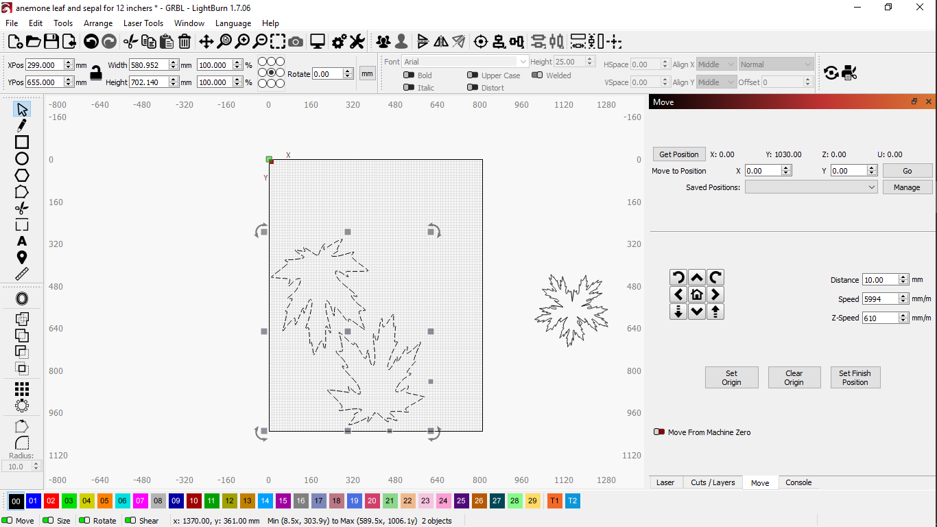

lol!! so, now I home and it says this position,but when I tried to frame leaves it framed in the middle of the plot area. AAAhhhh!!!

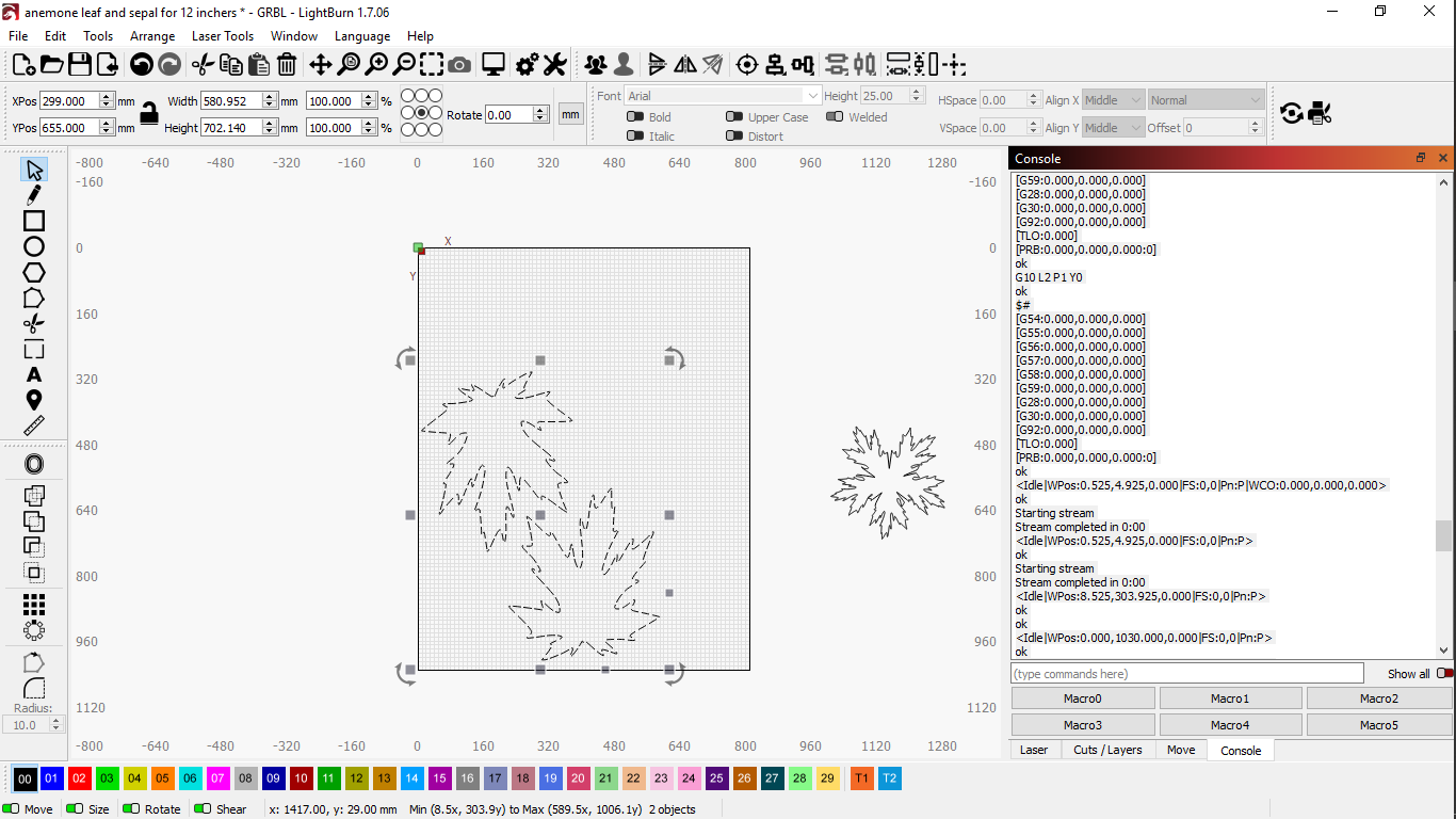

That’s ok. Now enter $# again.
If you see [G54:0.000,0.000,0.000] , enter G10 L2 P1 Y0 and $# again to verify G54 didn’t change back to 1030

Are you reading 0’s for position? What happens when you move?
the only thing is that it thinks the leaves are in the back part of the area. Instaead of starting on the bottom of the plot area, it starts a little bit up
this is the home coordinates
but it still goes the other way when I hit the button to go down, I have to hit it to go up

You entered G10 L2 P1 Y0?
yes, I entered that command

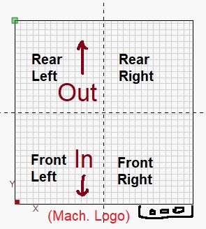

You are now in Quadrant II. Lightburn works in Quadrant I.

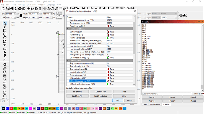

thelmuth:
$3=2
that went bad. when I hit home it hit rails and woudlnt stop grinding
MikeyH
(Mike Hembrey)
February 10, 2025, 10:35pm
99
Go into the Machine Setting s window and reverse the direction for $3 Yaxis there. That should give you what Tim was after.
that one, do I toggle it?
