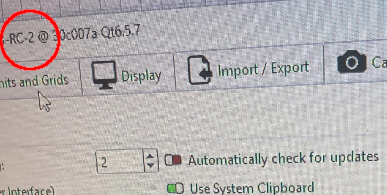

Not quite: you’re running a Release Candidate:
RCs, as it turns out, intentionally ignore that switch so you can’t inadvertently run an old RC after a new one comes out.
If you install whatever the most recent full release that your (expired) license covers, then that switch does what we both expected.
