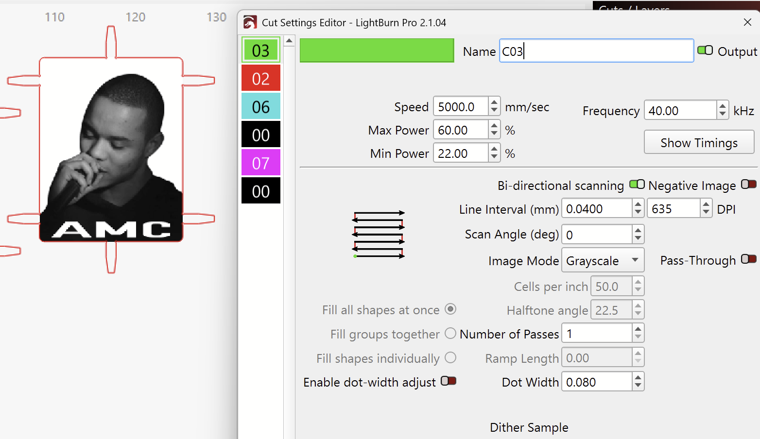

I also have the Gweike G2 Pro, but the 30W version with the 150mm lens.
I made this memorial plaquette out of brass, and got decent results using these settings
For the best contrast in an image on brass, you want to use Grayscale.
It took me a while to dial in the Min- and Max Power, but it’s definitely doable.
“Min Power” what’s being used for White pixels, and Max Power is used for true black pixels.

Your 50 Watts is more powerful, but the larger 210mm lens has less power density. So, my settings are probably still a good starting point. (Maybe slightly increase the Line Interval, because you have a larger spot size with your lens)

The darkest parts of the image (the hat) could be darker. You can get some pretty good blacks on brass.
It looks like you could go higher on the Max Power.
Or: Leave Min, and Max power and slow down the speed to 4000mm/s.
This will result in the white parts also leaving a light marking, which will remove the shiny parts on the cheeks and the shirt. That part makes it look a bit unnatural.

This is looking better! I used the settings above and created a second pass. 1st pass is 45 degree angle and second is 90.
I know it’s hard to see with that other image there, I’m recycling coins (so so many bad burns, so so many coins wasted lol).
What are your thoughts?
I did the 2 layers with varying angles because I noticed lines in the image preview. This is what was suggested to remove those.

Do you mean the scanning lines when zooming in on the Preview?
Your Line Interval at 0.025 is already quite small, possibly larger than the actual spot size of the laser with the 210mm lens. (I recommend doing an Interval Test if you want to know for sure)
If you can see the lines in the engraving, you could lower the Interval.
Note, that if the lines are overlapping, you also increase the power density, which will change the color of the oxydation.
I still believe, that the goal should be to do Grayscale engravings with only one pass, but your results prove otherwise. :wink:
