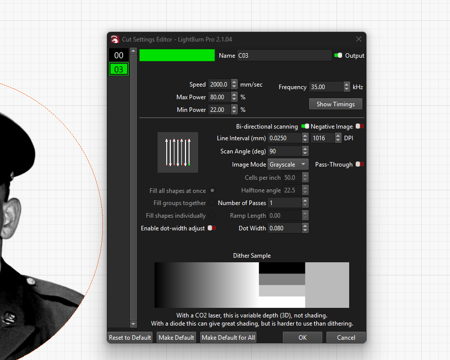

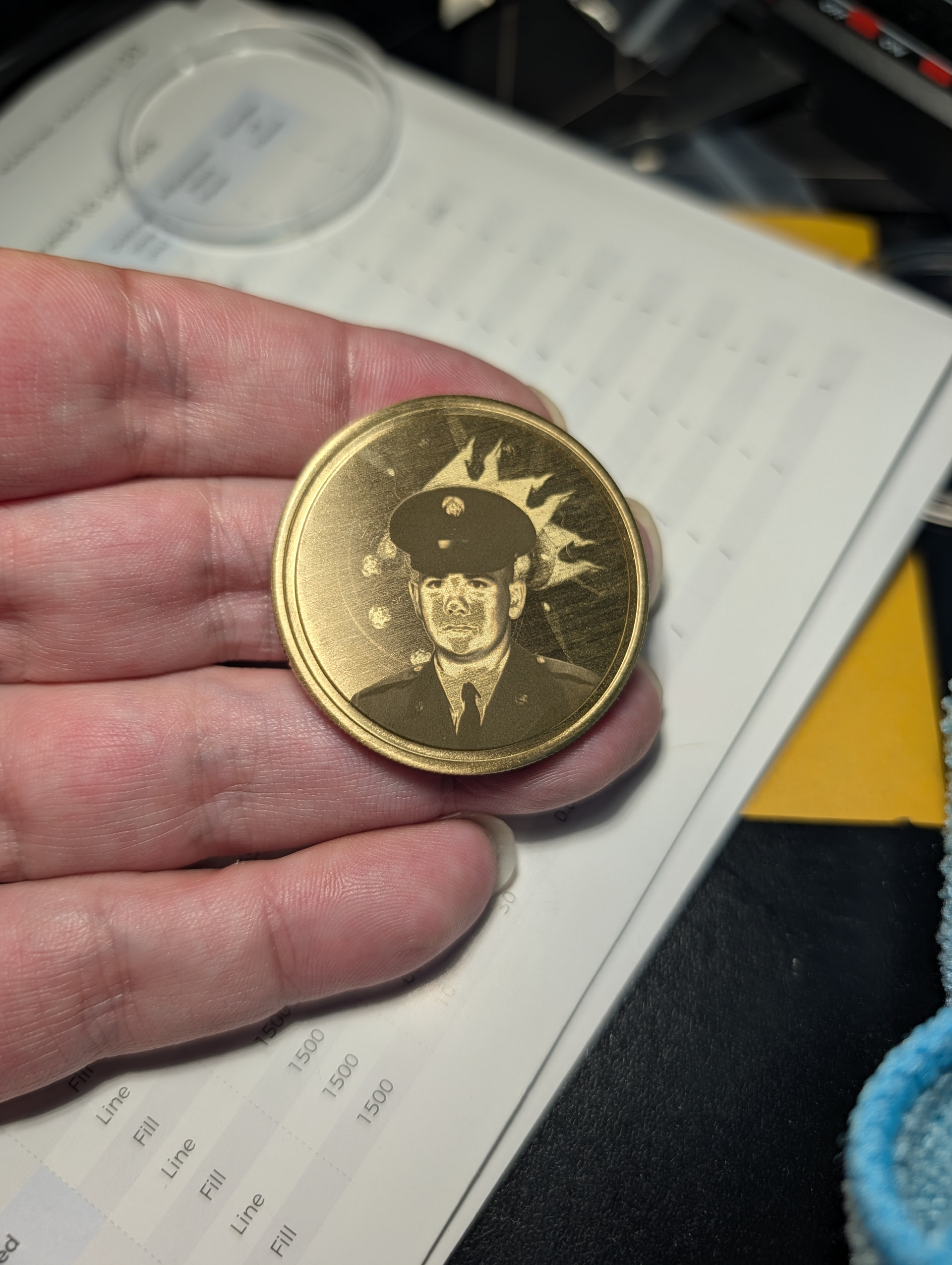

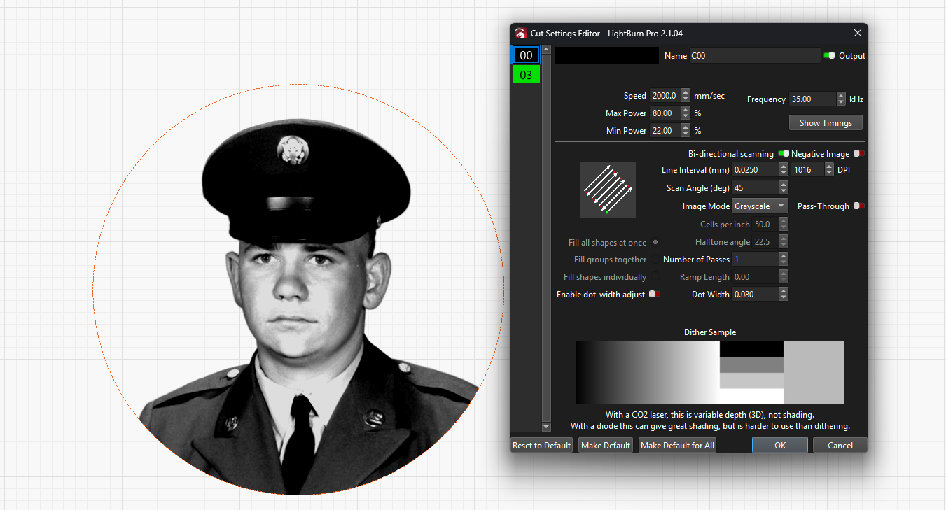

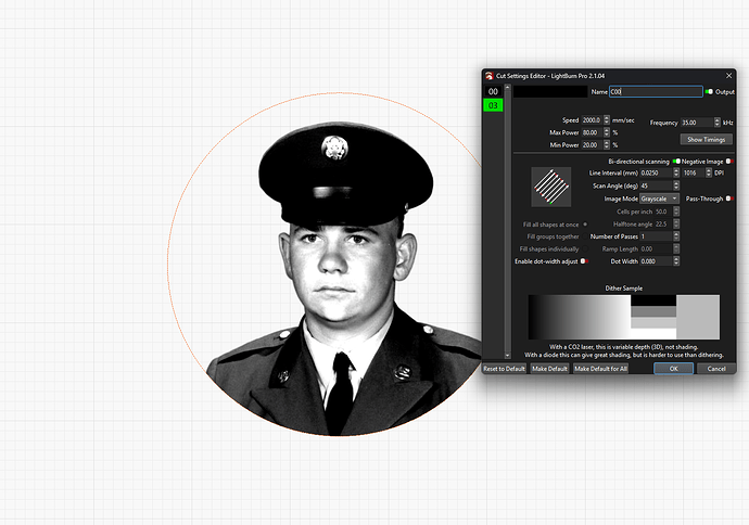

Let’s see if I’ve learned anything today lol - I re-ran it with some different settings, you can see a sort of white in the face. That’s caused by the minimum power change correct?
Definitely looking how I thought it should. I can’'t believe they told me no grayscale, I could have saved so much time (and money) coming here first lol.
What would you recommend tuning next?
Thank you again, I was ready to hawk this thing on e-bay or something lol
I think those grayscale images are great… better than I would expect. Copper is one of the most heat conductive metals.
@HavenFusky

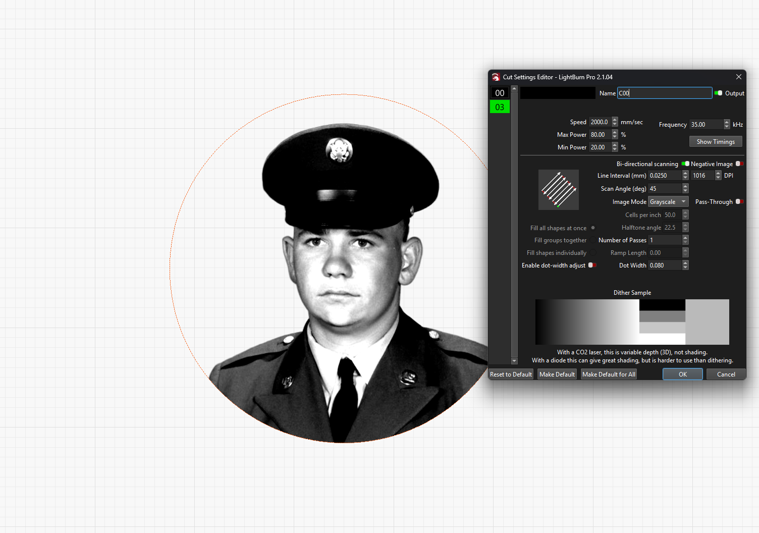

The last one you posted doesn’t look bad at all. Noticed you turned off invert image.
Looks like you’re on your way… have fun and don’t forget to post some of your work. :smiley:

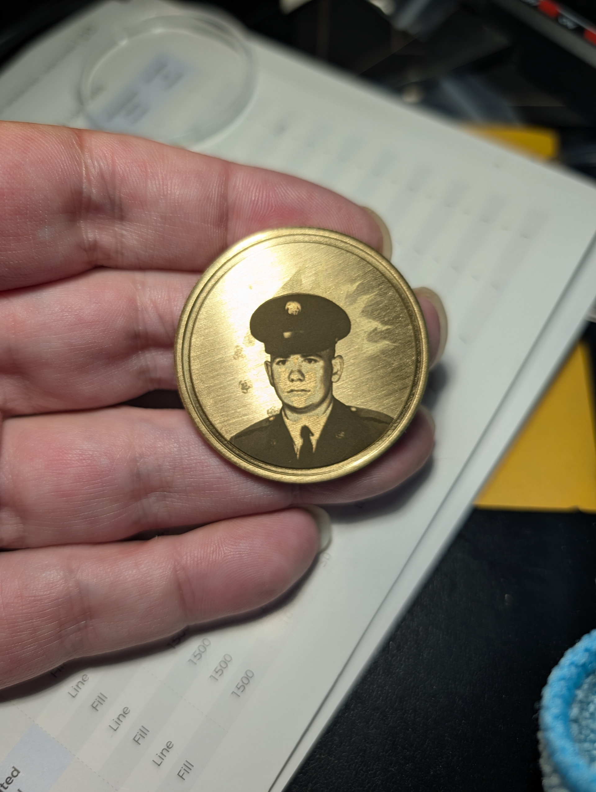

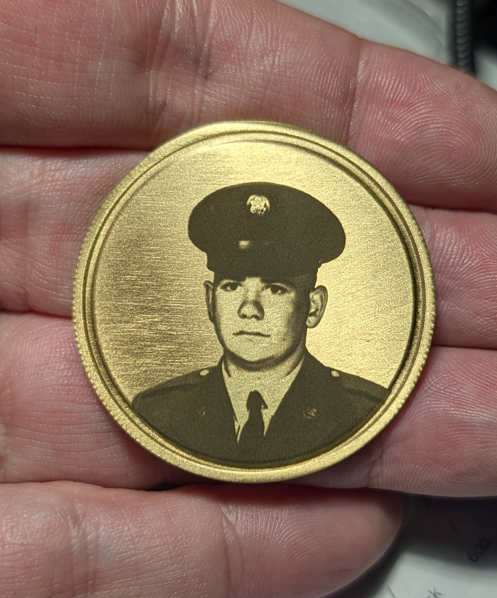

The results are in! I ran 2 pass with the same settings but changeing the scan angle between the 2. First is 45 degrees, second is 90.
I lowered the contrast slightly on the image inside LightBurn so it didn’t look washed out in the face. You can actually see the definition in the cheek now!
Next steps are going to be to add a background texture or something (maybe). Then I’ll work on the other side of the coin. I’ll be sure to post the end results here as well but for now just know you’ve made me a very happy camper lol
I cannot express my gratitude enough, I know it was basically saying "it’s ok to use grayscale (I was told to not use it) lol but I’ve been working on this for weeks now and have spent close to $200 on blanks. I’ll be repurposing the ones I can for the 3d engraving stuff.

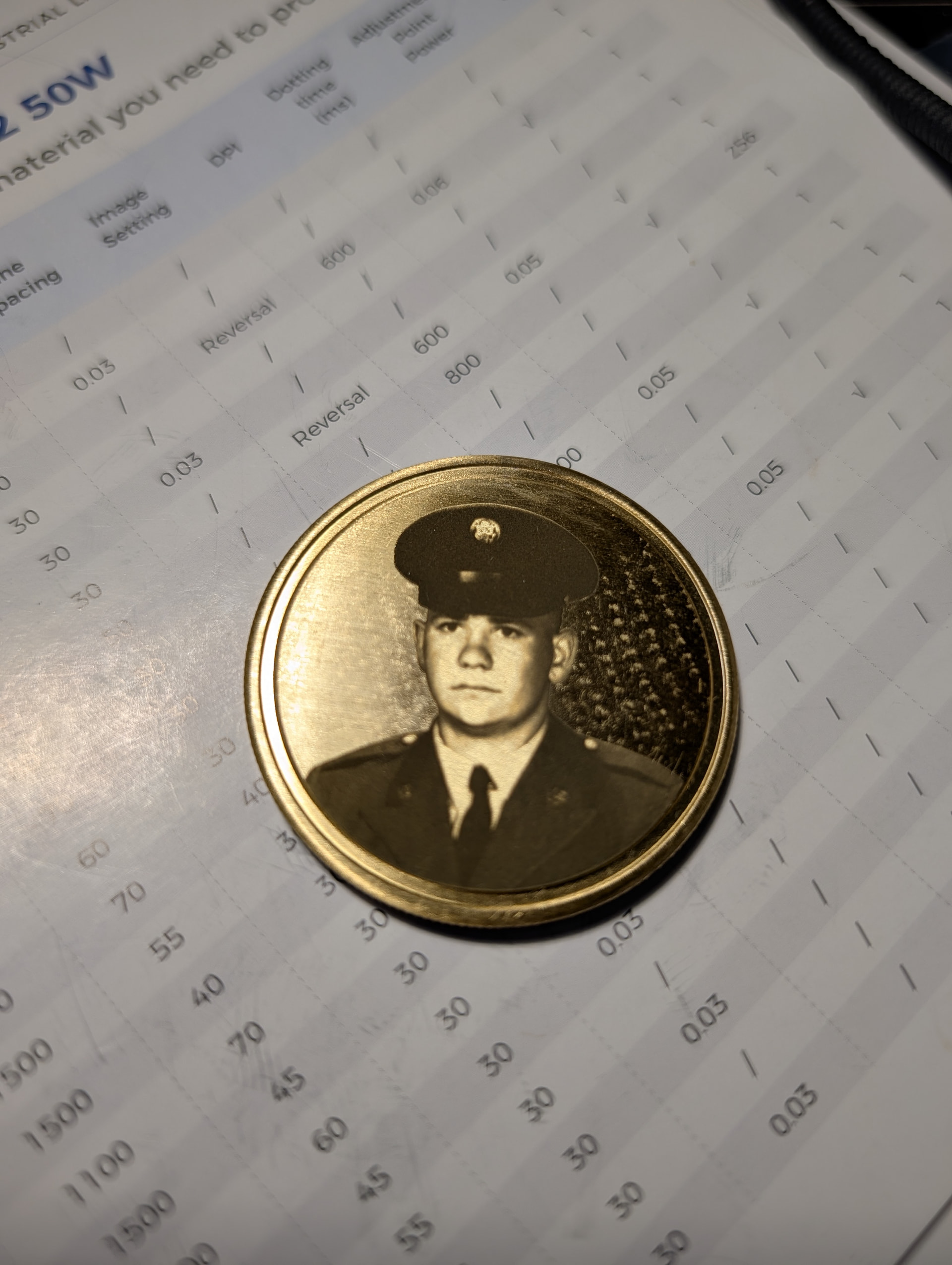

The issue still goes back to the photo goes from pure white to pure black. You’ll never be able to produce that big of a range. That’s one of the things that make this stuff very tough. I have a friend who lost his daughter. The only photo I have is poorly lit and detail in the facial area is pretty lacking.
The result, in any case, look pretty good. :+1:

I ran this image through one of those upscalers and then did the rest of the work in gimp. I still had to turn the contrast down slightly in lightburn, but it eventually made it there!

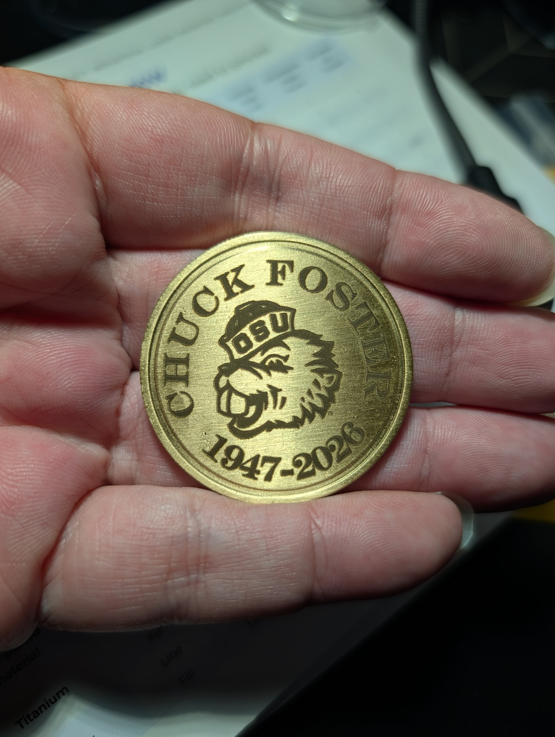

Figured I share the full results of todays work.
I’m not sure what that odd texture is around the main portrait, I’m still figuring out how to engrave a background around it but right now I’m happy with the results.
I’m going to polish it and try some brass black to see how that turns out but this part is at least done and satisfactory!

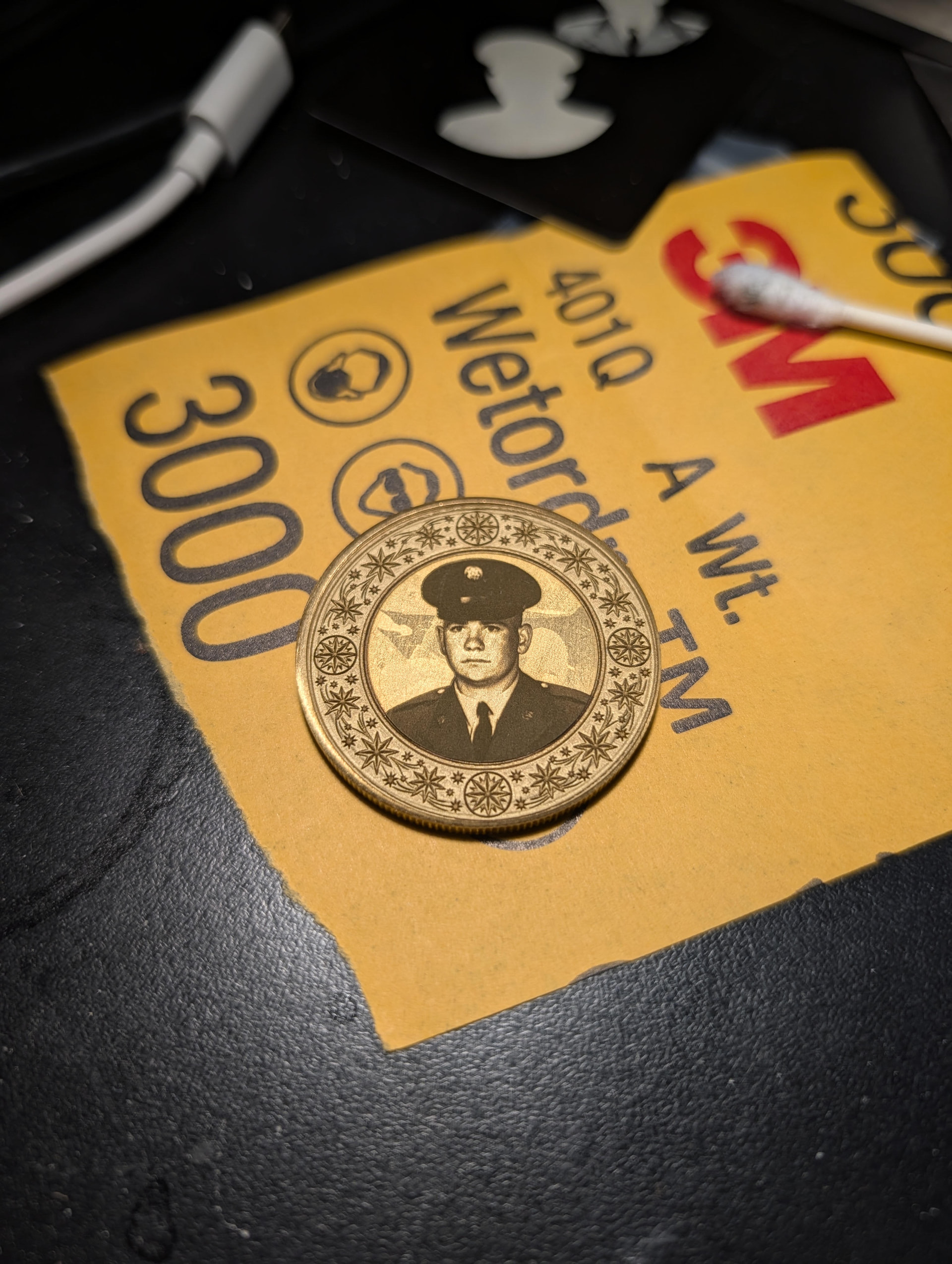

Today I’m getting fancy! I went to bed last night thinking the original coin was just too plain so today I downloaded a few borders to test out.
I think it really ads another level to it.

One of the issues with photos and trying to reproduce a grayscale is, as in your results, you lose the defining areas that are dark such as the detain in the hat band. You’re doing great and I believe you could be better results, but we love seeing them under any conditions.
Usually the strange patter you are getting a related to interval, especially when it appears as a Moiré Pattern. This usually occurs from crosshatching.
It being on one side could be the table and galvo head isn’t square with each other. Focus is critical and not being square could be an issue.
Focus is so critical people don’t realize it’s actually working.
You can look at your spot size, related to your interval and the pixel size of the image. The rabbit hole does go deeper, but that’s most of the issues.

Did you manage to remove the shine on the cheeks?
As far as I could tell from the pictures, it was just bare brass, and the Min Power setting had to be increased so that a very slight ablation would take place there, roughening the surface.

I did! And yes, reuping the min power did the trick perfectly.
I’ve been playing with “clean up” layers at the start to see if I can smooth the coin out a tad before the big jobs start and that seems to do nicely. Of course, leaving it bare brass also adds its own special something too.

The grayscale is working well and I added a border that gives it a nice depth and pretty decent look.
I’m waiting on new blanks to put it all together and finalize it. The friend that asked me for it really liked how it’s turned out :slight_smile:
