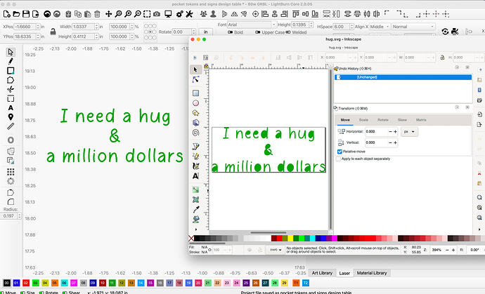

Hello,

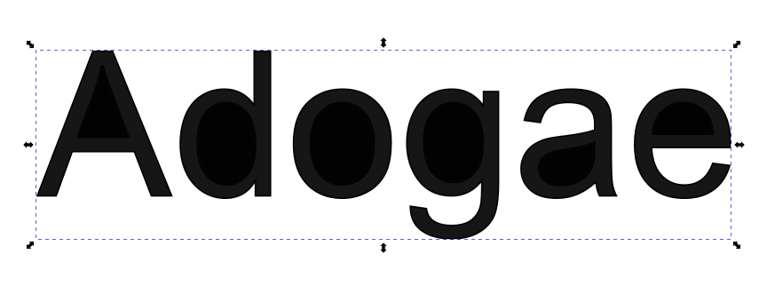

This seems super basic yet I cannot figure out what I’m doing wrong and I’ve been using LBRN for years. When I create a text design in a font that others may not have, I have always converted it to a path and welded it. I can then export as SVG. When I do this, it looks and acts as expected in Lightburn but when I upload the SVG to either Inkscape or Cricut Design Space, all of the counters (holes) in the letters are filled in. I have tried welding all the counters as one group and the rest of the text as another and then subtracting but that doesn’t work either. I feel like this should happen automatically with weld. In the screenshot, you’ll see LBRN on the left and Inkscape on the right. What am I missing or doing wrong? Is there a setting somewhere? I’ve searched for this issue online but I only get results for all other font/text related issues and tutorials and nothing about this. Help please.

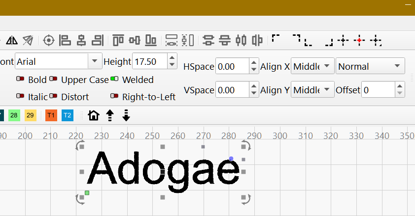

I repeated your steps and don’t have the same issue. Try it without converting to path or welding. I don’t believe font info carries through from Lightburn when exporting to svg.
See if using the GROUP command gets you different results from the WELD command.
If I understand correctly, when you convert to path you make the text into Vector graphics, which would disconnect the inside shapes -“counters” from the outlines of the letters (which are now shapes. There are subtle differneces between Weld and Group that I do not have the technical expertise to elaborate for you. Give it a try, see if I got it right :wink:

When you perform the weld command, it groups it as well.

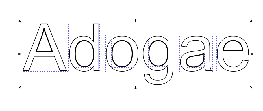

Upon further investigations in my example the inner paths are independent from the outer paths maybe yours’s too.

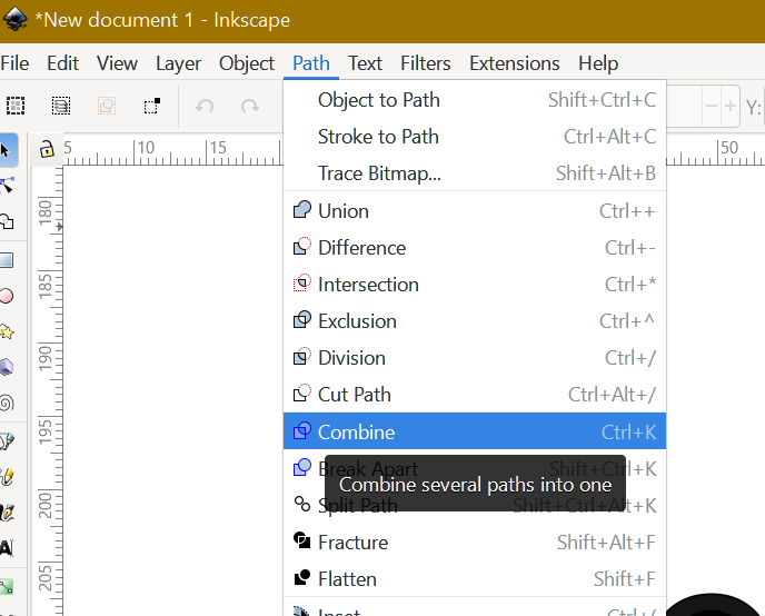

Try this select your “filled” paths and select Path > Combine
Thanks for the idea. Ideally, I don’t want to have to go to Inkscape for any reason (we don’t get along well) aside from checking my files to make sure that buyers can upload them without issue. Having to add this step would be a big pain and time consuming for me BUT it did lead me to discovering how I can avoid it. First, I wanted to make sure it was across all fonts so I tried it in another and had the same outcome. As I often use offset fill for my filled text, that is what I had the cut layer set to when saving to SVG. When I tried it in fill mode, it came out just fine! Thanks for helping me out and leading me to a workable solution. Now I just have to remember to change modes before exporting.

Well, the font in my example is plain Arial filled welded and converted to path then into Inkscape.
Could you share a simple .lbrn2 file with just two or three letters where this happens?
So we can analyze it and detect what went wrong.

My original example shows the text (not Arial) that has been welded while in offset fill mode in LBRN2 (shown on the left). On the right is that same file in Inkscape that was converted to SVG from that LBRN2 file. When I switched the original to fill instead of offset fill and repeated the convert to SVG, the Inkscape file was correct and looked exactly As the original. I’m at work for the rest of the day so I won’t be able to provide much more until I’m home tonight. Thanks for your assistance all.

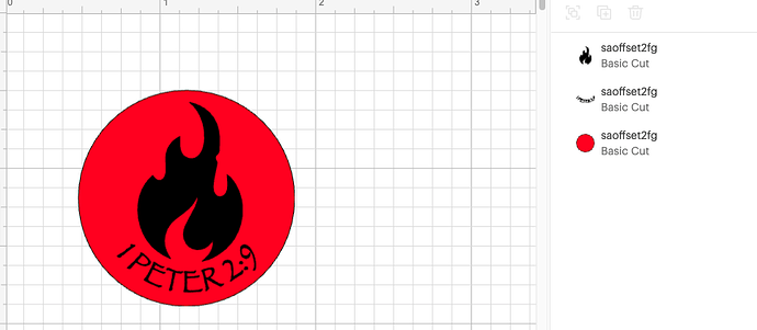

Here is an interesting find. I took a vector with text, exported from Lightburn as svg, opened in Affinity, added a word and exported from Affinity as svg with text enabled(not convert to curves). I then opened the file in Lightburn and everythin was there and the text I added in Affinity was still editable text. The text I exported from Lightburn originally was a path, as expected. I then uploaded the same file to Cricut Design Space and the text created in Affinity was not there. Apparently Design Space cannot import fond data in an svg.
The file I exported from Lightburn.
The file exported from Affinity after adding ‘test’.
Same file uploaded to Cricut. No Text Imported.
