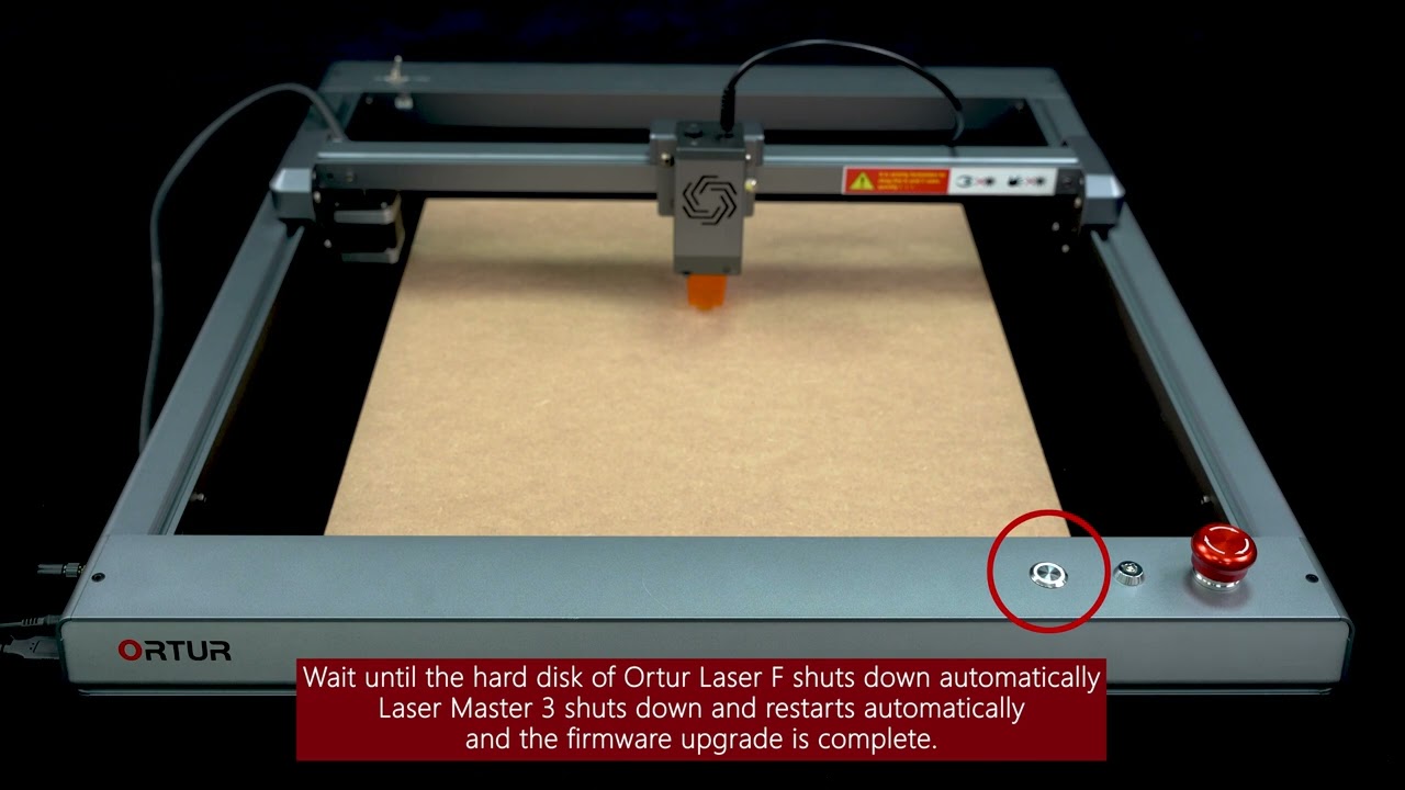

RC25 is an early firmware.
You may wish to update to RC38.
You can download the new firmware here:
https://ortur.tech/firmware/OLM_Series/ESP_OLM3_205_RC38.zip
The firmware update technique is shown in this video.
