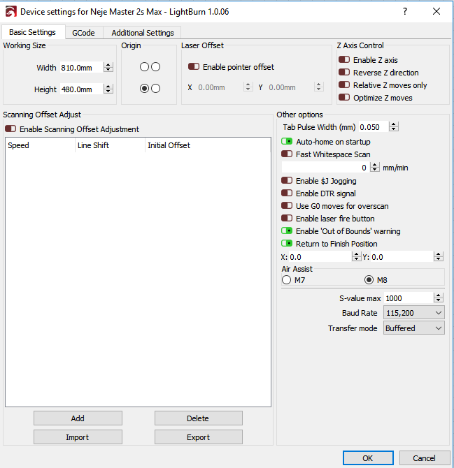

I am trying to laser my project. If I push a button to set laser in to go to the spot on working area positioning seems to match perfecly. If I push burn project it goes into wrong spot usually like 10cm lower from working area and starts burning. If I reposition the work under laser again it goes lower and lower etc…
I tried press homing it but it didn’t help.
Neje Master 2S Max should have X are 810 and Y 480 so it seems I’ve set correcly. Homing laser didn’t help.

How to overcome this I can’t continue my project…
I should have no electric noise issue I’ve read on some forums it might be for a laser not to function properly.
This strikes me as being the key to unlock the problem.
Some of these numbers are fairly… unorthodox?
I’ve set start point to absolute coordinate that seems to work!
