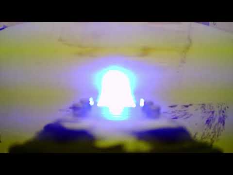

In my opinion it has to be a software/hardware problem, because when I use a a DXF file, the project runs without any problem on both Neje Software as with Lightburn, but using a PNG for example or a simple text/qr-code in Lightburn it makes problems:
Neje software
Lightburn software:
But when I use the same file as a PNG, the problem starts (and I used a lot of different formats with the same problem):

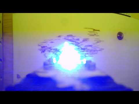

Neje software: (problem starts at 21:00 min)
Lightburn software: (problem starts at 6:22 min)
