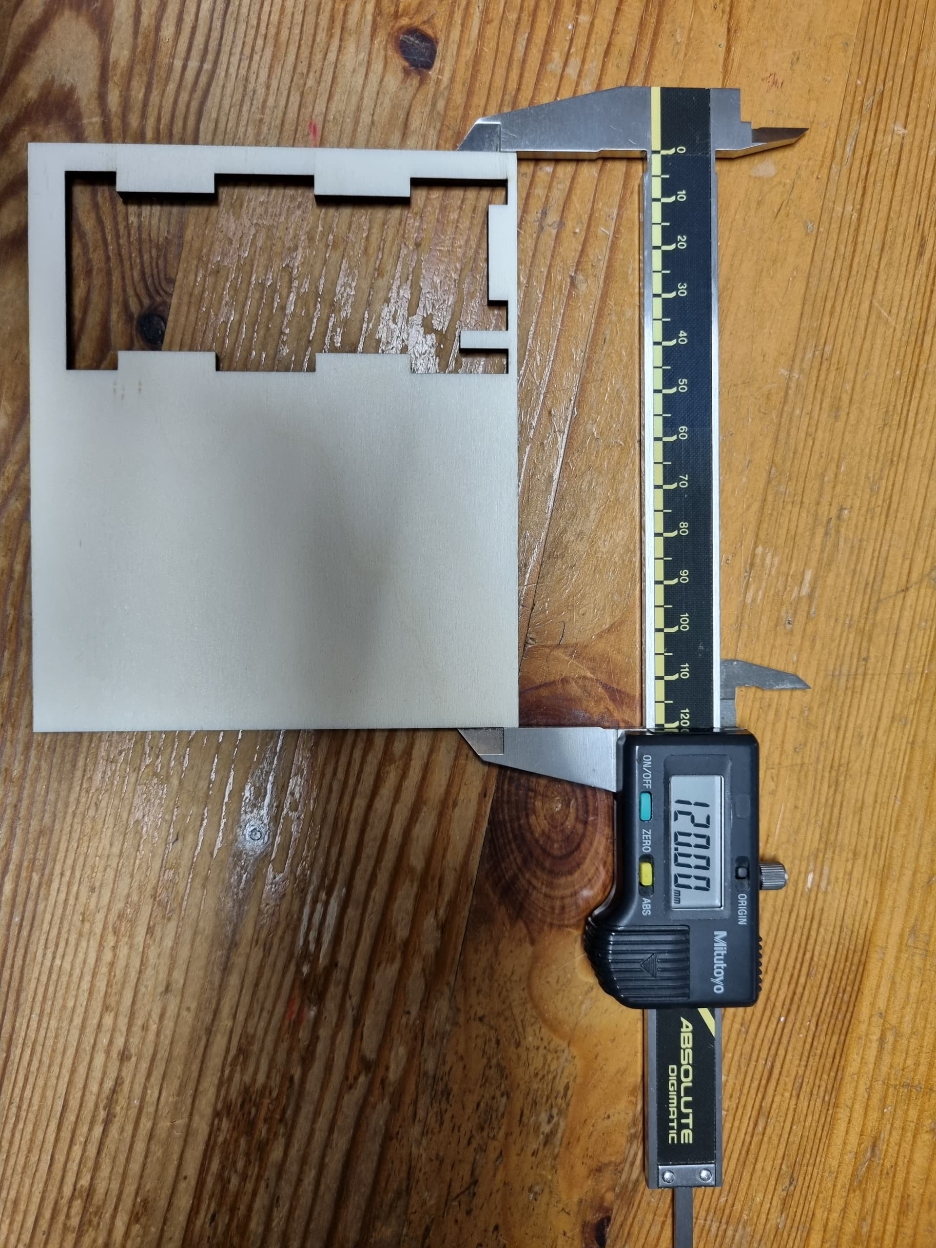

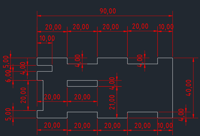

I then cut out the part with the following dimensions:
Strangely enough, the overall width of 90 mm fits pretty well. But not the 20 mm wide recesses. Furthermore, the overall height is too low, but the height of the recesses is again greater than 4 mm.

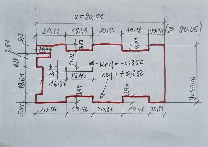

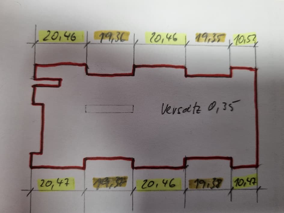

I have now carried out further experiments. According to your instructions, I recalibrated the laser with a rectangle of 100 x 100 mm. In order to get the exact outside dimension when cutting, I had to insert a KERF = 0.35 (2 passes when cutting). The result was then X = 100.07 and Y = 100.4 mm.
Here are the results of my test part:
To me it looks like Lightburn isn’t applying the KERF correctly. Could this perhaps be due to the drawing? Maybe vectors are in the wrong direction and Lighburn is adding or subtracting something incorrectly? What is striking is that all the incisions are uniformly narrower.

Things look different when cutting. Here the elevations and depressions each have the same dimensions with slight tolerances. It doesn’t matter whether I work with a Kerf or an Offset. I can’t explain the reason for this:
Normally all 20 mm wide cutouts should be of a similar size.

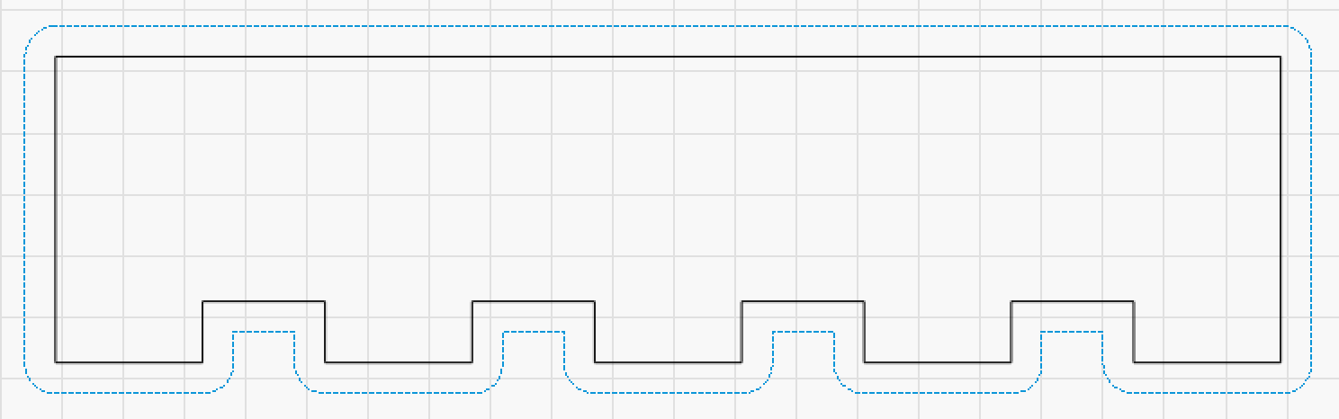

Whether using offset shapes or kerf you’d want to use half the kerf size as the offset value.
The outset on the outside of a closed shape will have it grow. The result of this is that tabs will get bigger and slots will get smaller. You can see this if you exaggerate the size of the offset. This is why it’s important to apply the correct amount of kerf/offset.
Check this example. Black represents the original shape, blue the offset shape. Notice how tabs grow and slots shrink?
@berainlb
I understood the offset with half the width of the laser beam.
But the fact that the tabs and slots should have different widths doesn’t enter my brain. In principle, I compare the laser spot to a milling cutter on my CNC. The cutter moves along the contour at an offset of half the cutter width. This has never had the effect that the tabs and slots had different widths. Well, the diode laser spot is not exactly round like a milling cutter. But the lateral removal in a tab or slot would have to be the same because the laser beam does not change direction.
In my opinion there is a bug in Lightburn. Or I don’t understand the system yet.
I will continue my experiments and try to optimize the cuts so that they fit my laser.
Thank you everyone for the support.
I don’t understand how that could be the case. Perhaps because there’s little variance in measurable kerf size using a solid bit.
Did you review the diagram I included above? You can visually see how the slots will become narrower any why getting the correct kerf adjustment value is important. Having too large a value will result in tabs being too large and slots being too small… Having too small a value or no value will results in tabs being too small and slots being too big.
I drew the outline and gave it coordinates. Now I understand what you mean: If I follow the blue contour, then the tabs are wider than the slots.
