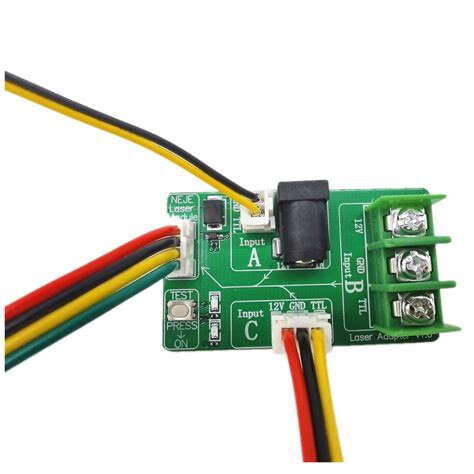

If the issue is in the laser adapter board then much simpler. The one that looks like this:

There’s no reason that a functioning Neje module can’t be made to work on the Ortur. The only problem in this case was the voltage difference. The laser adapter board can be used to provide the correct voltage. Just make sure you’re only getting PWM/TTL and Ground from the Ortur.

So how I should connect the neje module and ortur together is by giving the direct supply to this board through a 12V 2A adapter in the socket marked in blue and connect the white TTL wire from ortur to this pin marked with yellow, right sir ?

You will also need the ground wire. Make sure to exclude the Power line marked with “12V”.
Alternatively you could plug ground and TTL to Input A or input B. I’m assuming that all inputs A, B, C are interconnected with no logic.
