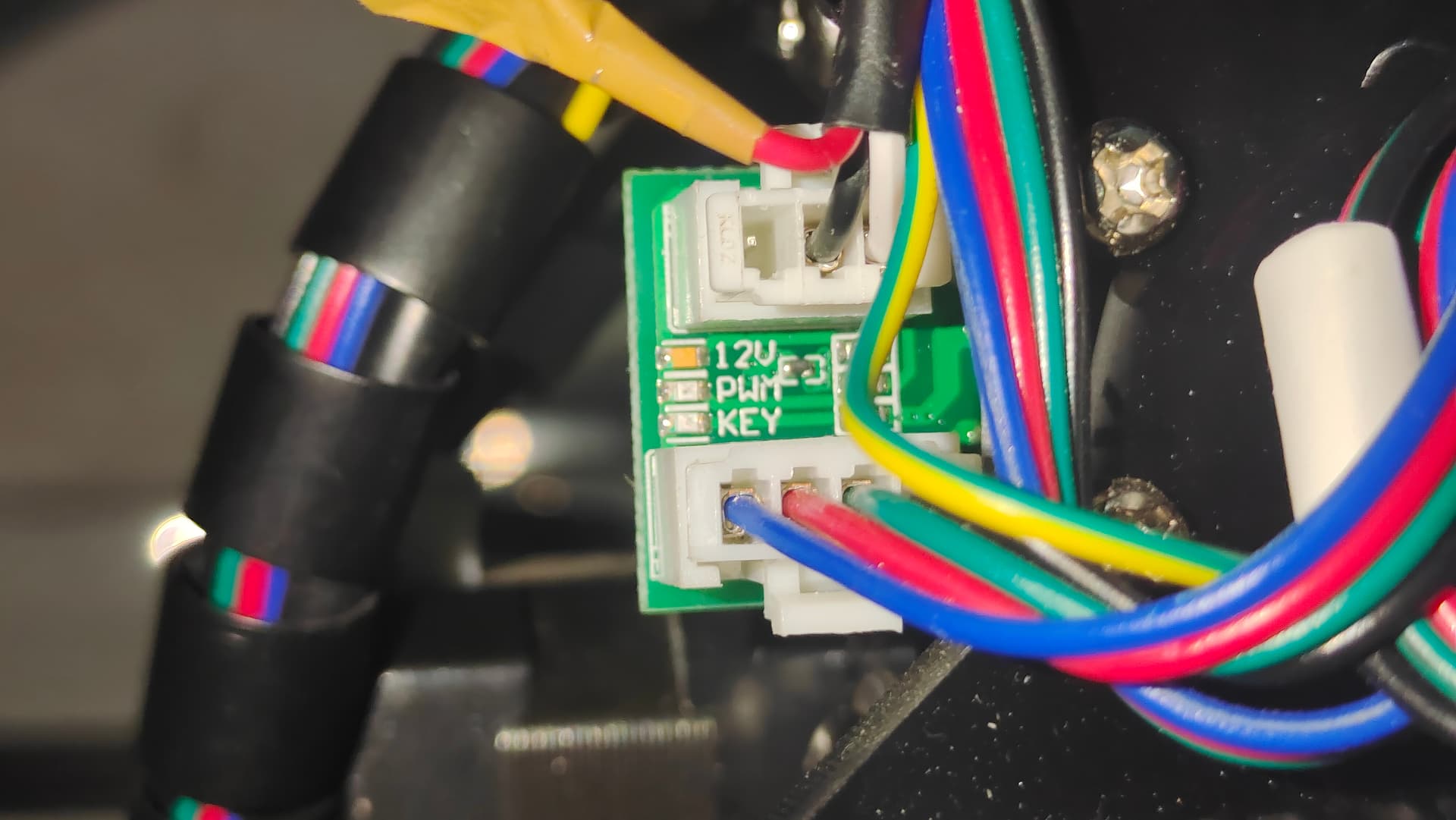

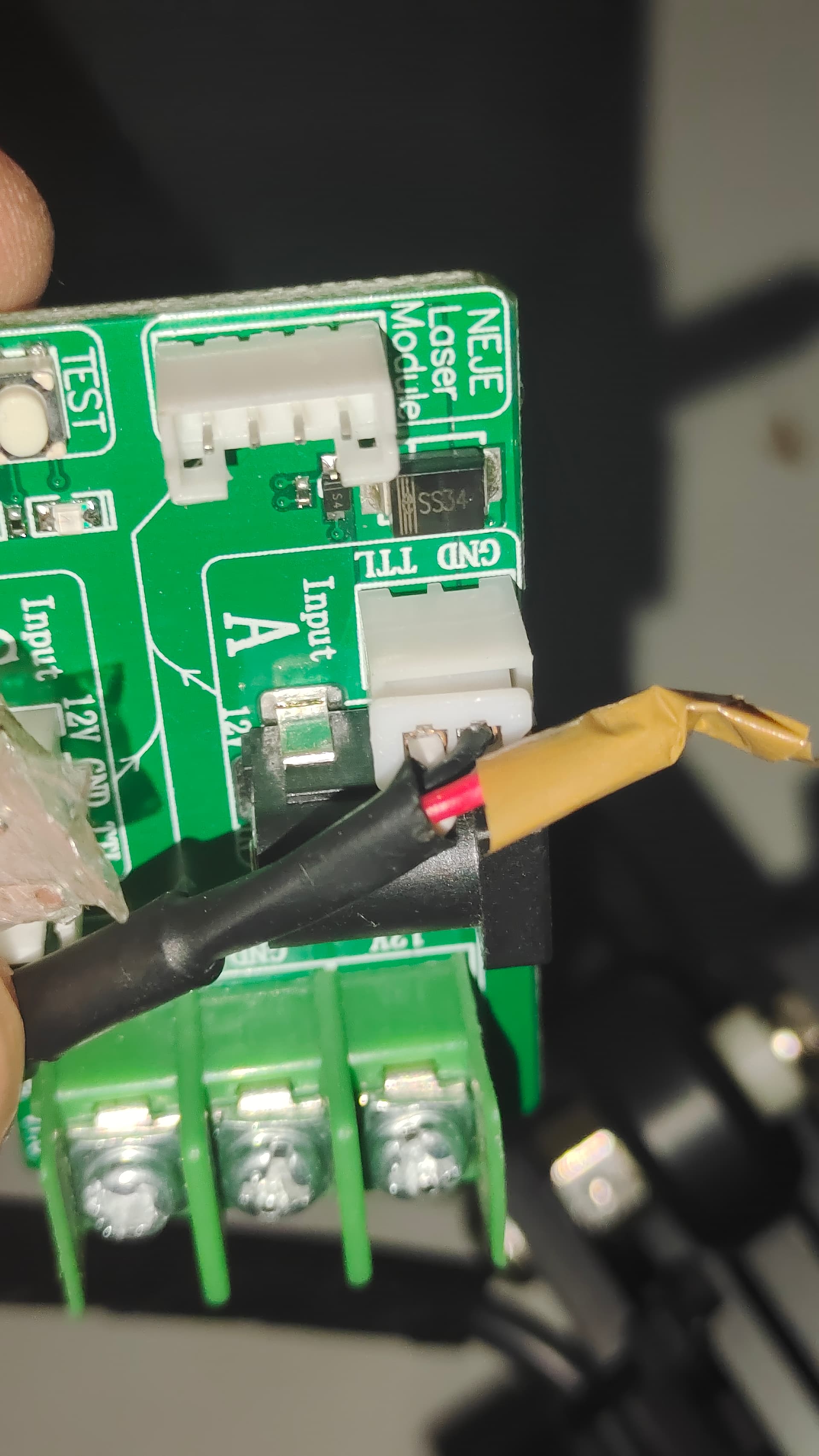

This is the final connection, as you can see red wire has been removed from both ends and only ttl and gnd is connected to the board.
So should I connect the laser and turn on the machine ?

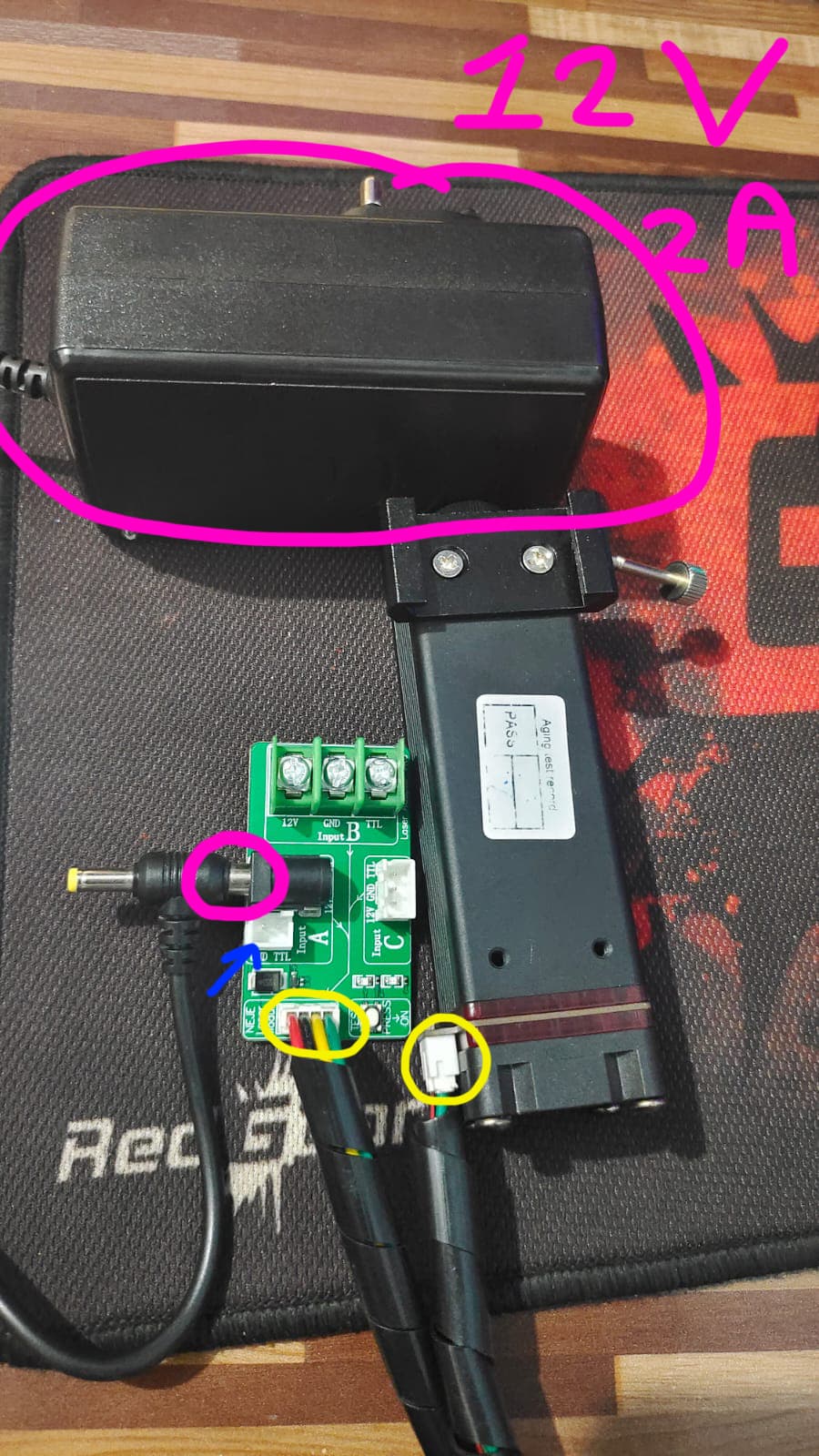

with this connection how do you power the laser head? you use the 4 wires cord to the laser? and a different power source connected to the 12V near GND and TTL?

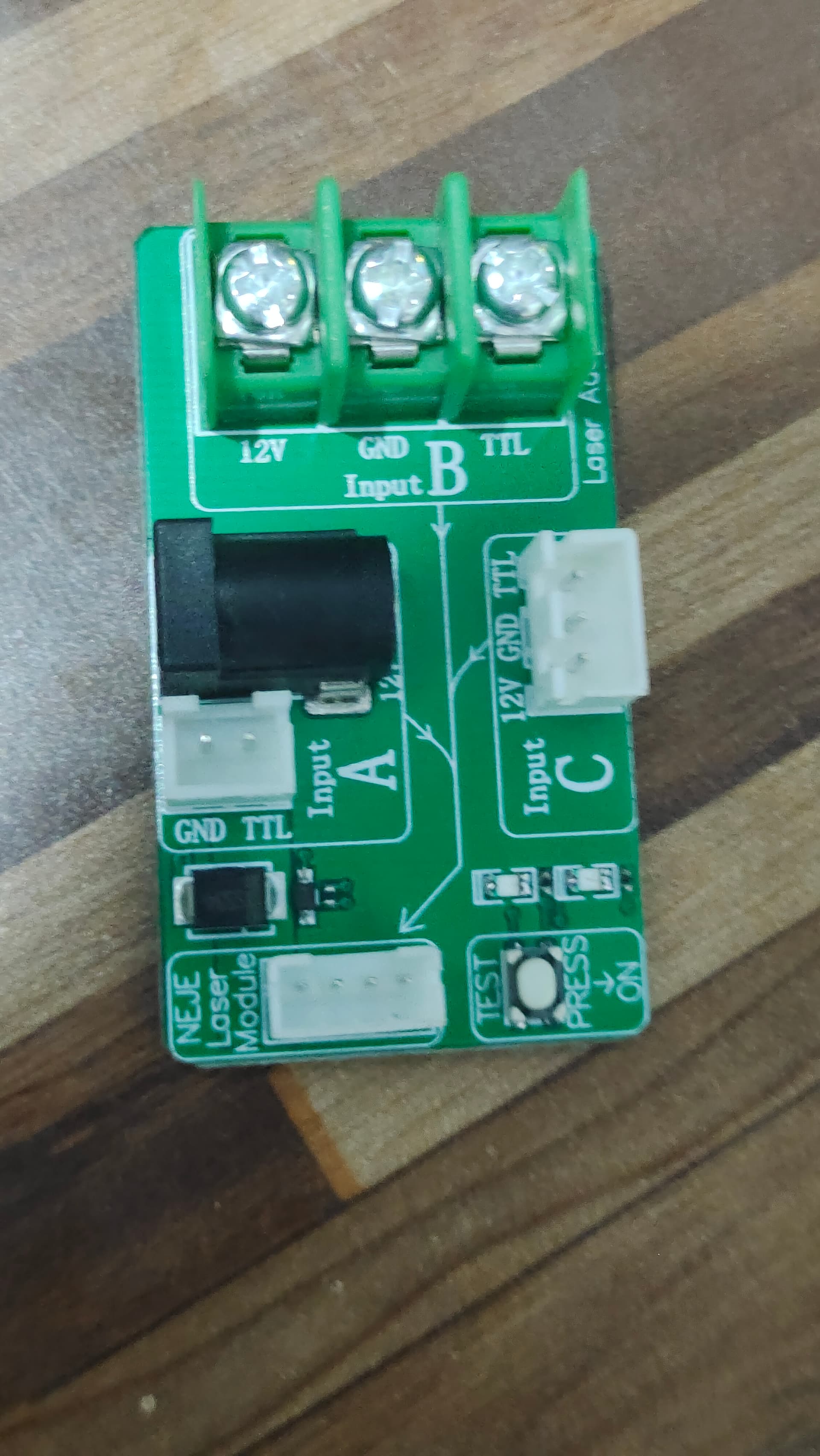

I didn’t realize you moved to input A. I can’t see the labels on the other side but if you’re certain black is ground and white is TTL then you should be fine.
This! The laser is connected to the board (yellow marked) and the gnd and ttl wire from machine will go in the blue marked socket.
ok this is the rigth way :wink: quite exactly like my Neje module
Yes, in the machine’s board , black wire is plugged in to the gnd port and white to the ttl.
