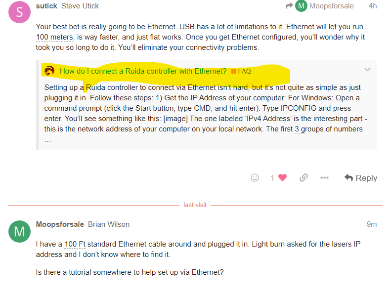

Your best bet is really going to be Ethernet. USB has a lot of limitations to it. Ethernet will let you run 100 meters, is way faster, and just flat works. Once you get Ethernet configured, you’ll wonder why it took you so long to do it. You’ll eliminate your connectivity problems.
I have a 100 Ft standard Ethernet cable around and plugged it in. Light burn asked for the lasers IP address and I don’t know where to find it.
Is there a tutorial somewhere to help set up via Ethernet?
Edit:nevermind! I see you FAQ post above. Thank you so much!
They quite literally linked to it above.
