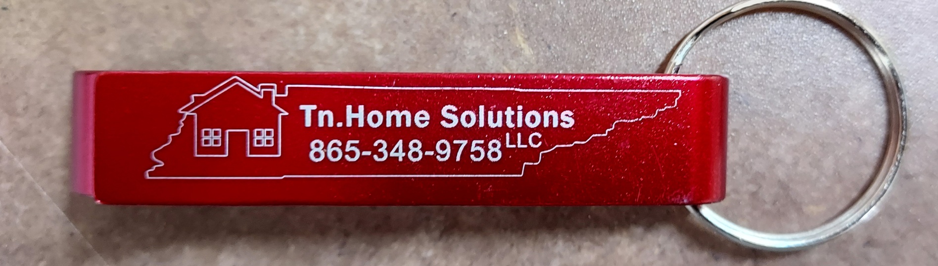

I watched the focusing video listed above. Did it exactly. Found the focusing sweet spot, so I figure lets knock out some anodized alum. keychain/bottle openers I still had to complete.
I put my jig on the bed, and knocked out 1 keychain every 4 seconds. I used the foot pedal but pressed it with my right hand. That was really sweet.
My cardboard jig will hold 4 of those things, but I figure the field size might prohibit that, so I opted for 2 of them. BUT, when I did a frame, I only saw one design. I moved the 2nd piece in Lightburn closer to the first one, but never saw it in the framing outline.
Wasn’t a show stopper, so I opted to do one at a time.

I would never have the time, knowledge, or patience to do something like that… Just a lot of stuff going on here on the farm. Anyhoooooo, here is the keychain that I’m doing. I put a pile of them to my left. Place one, press the pedal pad, remove with my right hand and place another with the left. Rinse / Repeat.
