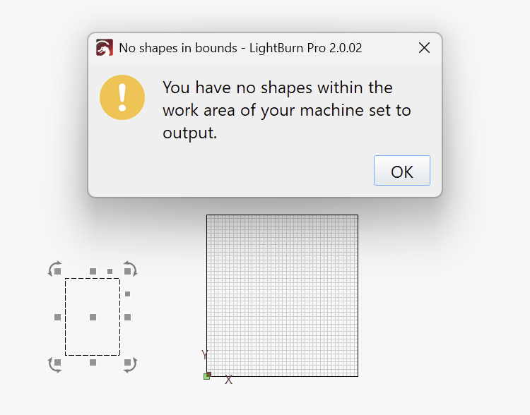

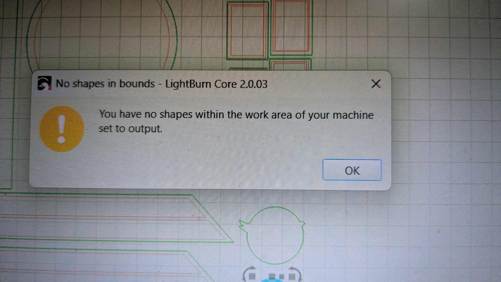

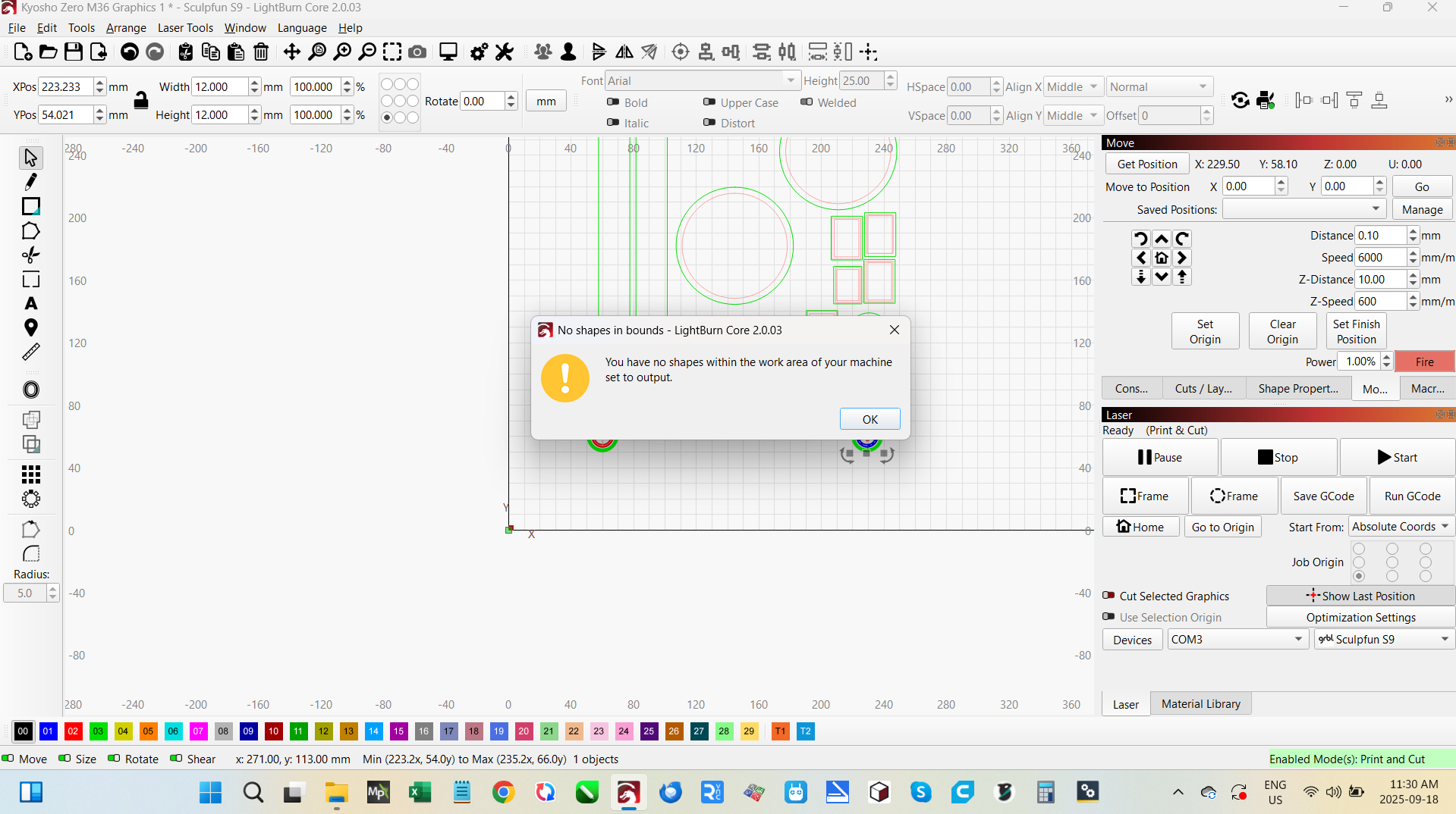

Is this the error you are describing?
I recommend this documentation page on the topic.

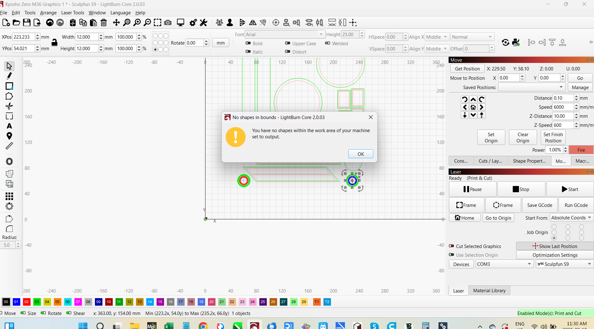

this is the error I am getting.
Move the object on your workspace until it’s fully within the workspace boundaries and let us know if that gets it sorted for you. Your screenshot looks to show that the selected objects are partially in the workspace and partially out of it.
actually the part is sitting with its origin at 0,0 so not off the workspace. Whats odd is I changed the layer to a different cut profile and it worked fine. Not sure why.j
When you run into errors like this, check your Preview Window to see if it adds any additional context, especially if you’re near the extents of your travel area.
This exactly!

Oh and if I hit preview it gives me the message there are no shapes. So no additional data can be found there.
man I wish I had never upgraded. My machine is for the most part useless now. I am trying to cut decals and no joy. I just can’t see anything wrong. Other then if the drawing is in the lower left and the machine origin is lower left as it has been for 2 years or more. Then I jog to the first alignment point and then tell it to jog to the second it hits the rails. IF I manually jog to that point and set it. It goes into the rails or tells me there is nothing to cut. There is some change to the way it deals with the artwork in the workspace that I have not figured out yet.

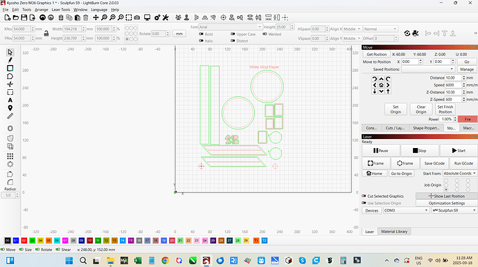

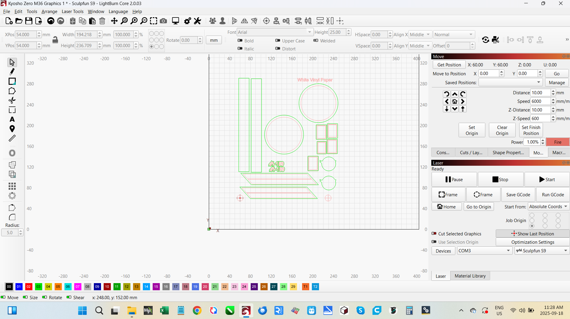

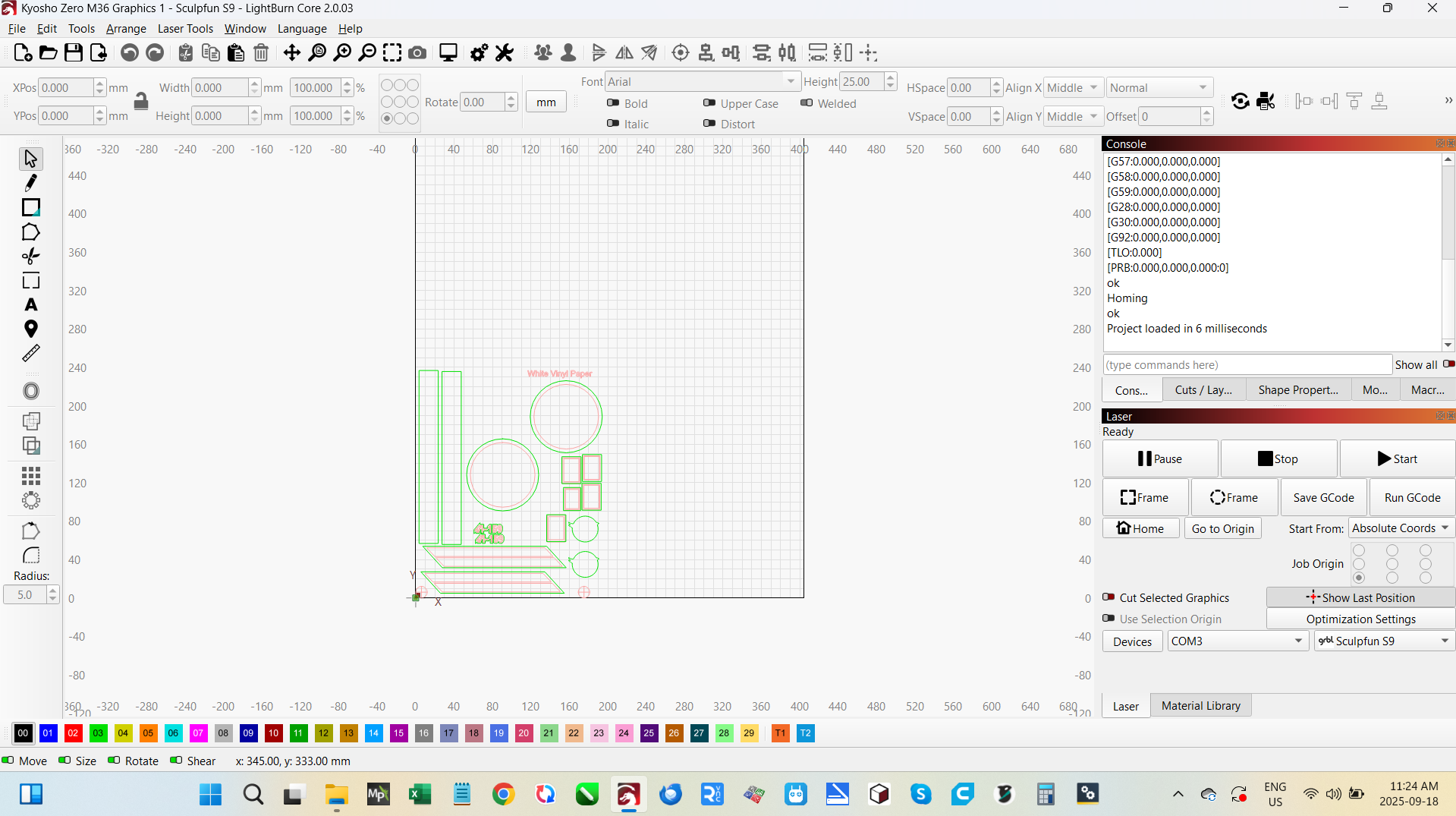

ok here are some screen shots.
In this case I loaded the file.
Homed the machine.
Jogged 50mm x 50mm from the home position.
I lined up the laser dot with the cross hairs on the first alignment position and set it.
I then jogged to the second position dialed it in and set it.
I then clicked on preview and it said there are no shapes in the working area.
I have tried every thing I can think of.
I have jogged direct from the home origin to the first alignment point. With the drawing at 0,0 the first alignment point is 100mm off so disaster.
If I drag the laser head over to the first alignment point and physically line it up. Then set the second and hit frame. It may frame closely but not correctly.
And in almost every case it says it’s got no shapes to cut other then if I set it manually to that location or it races off in one direction or another and hits the frame. Even the stop switches are not honored. It just crashes and grinds away.

just tried again.
Homed the machine.
Standing in front home is in the upper left corner.
I then jogged the machine 50mm to the right and 50mm to the front.
I then moved the graphic to line up with the current laser location and set the first print and cut alignment position. I then moved the printed item and lined it up with the laser dot. So not the laser and the print are in the same spot.
I then jogged to the second location, lined it up and set the second position. So now the print is in theory lined up with the laser and with the image in the work space. So in theory I am good to go.
I hit the frame button and the laser raced off to the left hitting the railing and grinding till I hit stop.
I know I am missing something just not sure what.

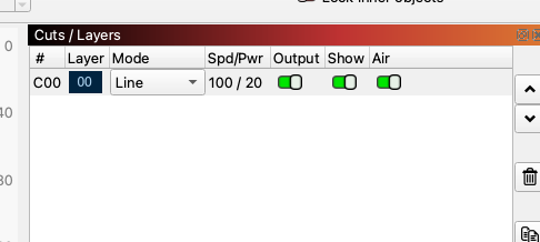

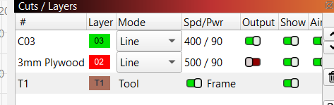

You don’t show your cuts/layers panel. Make sure output is enabled for each layer you want to use’
yes all the layers I want to cut are enabled.

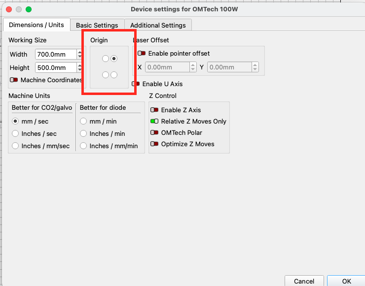

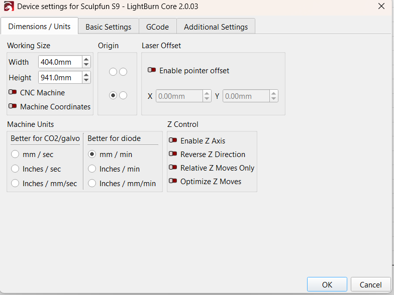

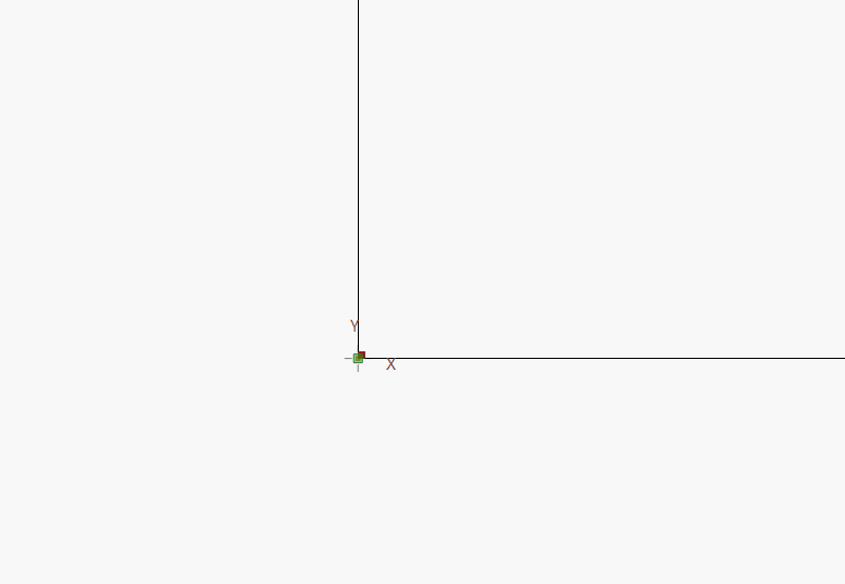

But your machine origin is set to front left, not back left. the red square is where your machine origin is set. The green square is your job origin.
What corner does your machine home to? Does that correspond with this setting in Device Settings? It must.
standing in front of the machine.
IT homes to the left upper corner. Has done for years.

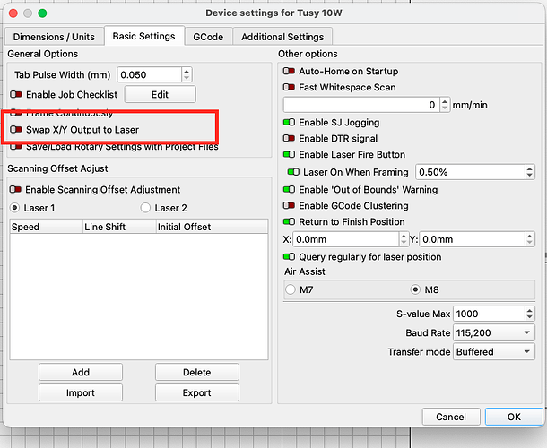

THe location in the settings is attached.
When standing in front of the machine is it wide or tall?
the machine is wide left to right and short back to front.
Have you done this?
