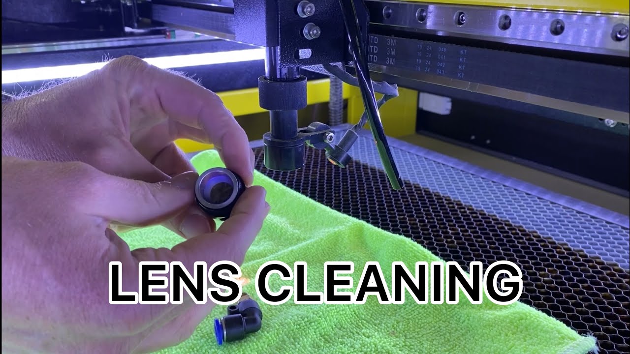

Decent video cleaning and reinstalling lens. About the 2:45 mark he talks about reinstalling.
