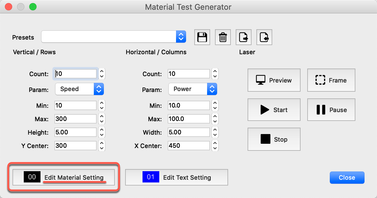

Will there be a tutorial or some sort of help for this? I seem to be having a hard time getting the letters to be lines and the squares to all fill at once.
There will be, yes. Please remember, we are a very small team, so we wanted to get the code in your hands as fast as we could. ![]()
At the bottom-left of the ‘Material Test Generator’, you will see edit buttons where you can change the layer output from line to fill and also set how the fill is produces, just like all other work defined in LightBurn, but just for that test.
We appreciate all your hard work and thank you for getting it all packed into a nice neat upgrade. I look fwd to the help sections. I have been playing with the edit buttons but they are not working for me the way I want them to. I may uninstall and reinstall. Thanks again.
If you provide a bit more detail about what “not working” means, we may be able to assist further.
What are you wanting to do, exactly? What steps have you taken, and what did you observe? What did you expect and what did or did not happen?
I think you have got the settings the wrong way around.
The black layer is for the material, which in your example should be set to fill and ‘fill shapes individually’, the blue, for the lettering should be set to line
