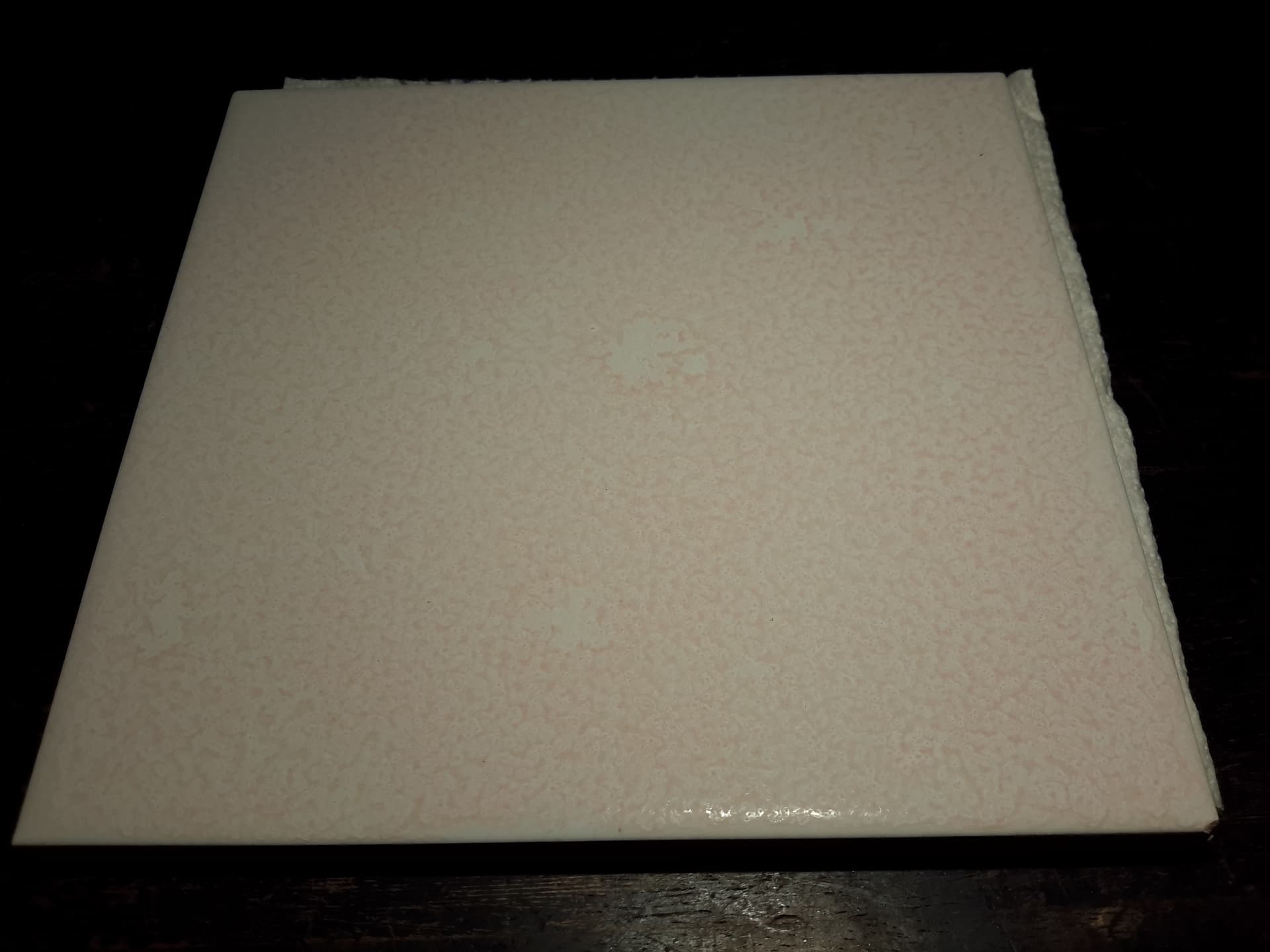

My first spray not so good. I washed the 6" tile with 91% IPA and flushed the spray gun with 91% followed by a water flush. I am not a spray gun person, other than spraying latex on the walls, and I really need help adjusting the gun air and liquid metering. Water & TiO2 ratios would help. IPA in the mix is too problematic. Gum Arabic was about .007% in the mix.

I tried a foam brush on the tile and got poor results with that, I think the alcohol evaporating caused the liquid to move and puddle. I think the spray (image above) did the same thing, only finer.
Bottom line is I do not think all these additives are worth the trouble. I believe @jkwilborn said it best+ Water, TiO2, and a dash of food coloring.

Definitely use cold water (I’d worry about the gum denaturing at high temps, it’s a natural product after all). And Mickey, that’s definitely way too much gum. Get your liquid gum arabic (either pre-mixed e.g. by Winsor and Newton, or powdered and mixed with water to roughly the viscosity of vegetable oil). Then add a few (say 4?) drops of this liquid to a tablespoon or so of pigment, then add water to form a thin paste/paint of your desired consistency (again, I’d say roughly the viscosity of vegetable oil). I’d also leave out the clove oil, for fear it will mess with the surface tension. Just let the paint dry out in a shallow dish (watchglass, saucer, etc) between uses, and reconstitute with water when next needed. This should keep it from getting mouldy. If you have a 3D printer, you can speed up evaporation by placing the dish on a warm 3D printer bed (say 60c or so).
spray it again. I keep it flat and spray it to the point that it would run if it were normal paint. that is the way I get my best results. It does not spray out well and you need a lot on the tile to flood and get a level material application. I typically do two sprays. I know it is not the quickest and the easiest but it has given me the best most consistent results.
also always do a test tile. I spray in batches and if I spray them all the same, hopefully, the test will be a good representation of what the other tiles do. to not waste a tile I usually make something that is a fill and not a gradient so i cant see if the black is nice and solid and deep in color. If it is I know that I have good tiles to do my more complicated burns.

That was my mistake. I tried to coat the tile as if I were using normal paint.
Just one this time to lock in the spraying part.
Thanks to ALL for the feedback! I am going to leave out the gum until @jkwilborn says it helps. @BillieRuben 's suggestion for cold water makes sense. And Spray Like a Beginner looks like what @james.myatt is suggesting.
