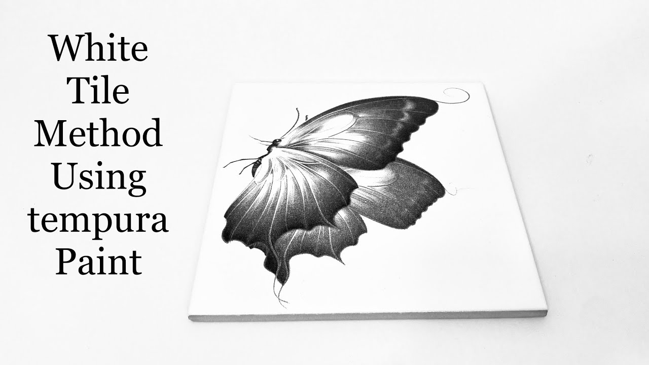

`I have gone through almost 100 tiles perfecting my method and I have discovered it’s a combination of the quality of the coating and the exposure/speed combo.
I was looking for a water washable yet quick drying medium to mix with the TI02 I tried Acrylic but a PIA to remove, the school glue was a joke, and alcohol didn’t keep the pigment in suspension and was extremely fragile, but I finally selected white tempera (school grade) which was ALMOST perfect. After realizing white pigment mixed in white tempera on white tile was pretty lame, I broke open the piggy bank and purchased a quart of some green tempera for a few bucks
 Perfect! It produces enough color to indicate the coverage and quality of the coating.
I tried foam brushes, foam rollers and finally dragged out the air brush. One of my brushes is a Patriot 105, which is perfect for laying down a moderate coat. I have a desktop spray booth with extractor which works for spraying 4 x 4" tiles on a turntable. I have experienced NO CLOGGING running 35 lbs and pinching the tip occasionally. I lay down 2 or 3 coats per tile and then let them set for a few minutes and transfer all 4 to a toaster oven set to 110 F for final drying in 5 to 10 minutes.
I use 1 part tempera to 2 parts TiO2 and use and place in small dropper bottles. I blend for 30 seconds with an agitator and experience no separation during painting. I add the mix to the paint reservoir and thin by adding distilled water til the mix is the consistency of cream, maybe a shade thinner. I stirr with a small paint brush and have been getting repeatable, dependable results.
I tried various spray bottles as well, always clogged and pretty poor spray patterns, and a cheap battery operated air brush which was total junk. I’m afraid the airbrush is a corner you just can’t cut, but you can purchase some pretty inexpensive air brushes and possibly (I haven’t tried this one at home kids) your air assist compressor might put out enough pressure to run the brush.
Bob
i basically do the same thing, you are much more scientific than i am. I use a few drops of black tempura paint to make mine a light gray to see where i have painted. I use a cheap spray gun from harnbor freight. two coats and i am good to go.
here is a very crappy video if anyone is interested.
I tried the same spray gun and I got the same uneven results. The spray is too coarse and produces surface defects. I use 1part tempera to two parts TiO2 and then that mix is diluted with distilled water 1:1 ± and a get an absolutely smooth even coat with no surface defects as you can see from the Gila monster. Not scientific, after 80 or 90 fails, I eventually got it right! To produce commercial quality images, it has to be perfect.
Bob

watching the video above it is 2 Table spoons Paint (40ml) , 2 teaspoons TiO2 (12ml) , 6 Tablespoons water (120ml ) and spray using a spray gun , ill give that a go . The only good result i have had was with a spray gun , brushing was pretty bad , too thick and too many brush marks , probably because i’m 10x better at spray painting
