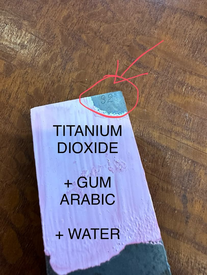

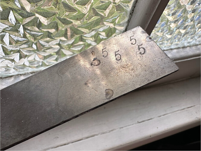

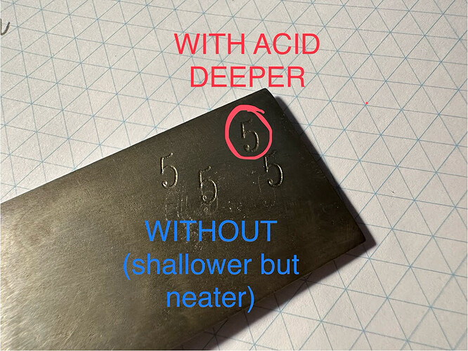

I’ve had some recent success using mustard+TiO2 to deep engrave steel. I’ll finish a write up at some point! Just busy getting ready for LBX :smiley:
What kind of laser Billie?

I’ve tried mustard for marking metal and had poor results but some have said it worked and this is the first I’ve heard of combining mustard with TiO2. Looking forward to read how your experiences went.
I figured because it was red, it would be good for diode lasers. Might smell better too.
A 50w RF CO2 (Gweike Cloud)
(+ food colouring but I want to try graphite powder instead)

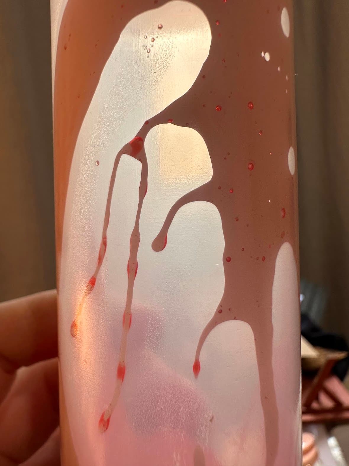

I’ve found the food colouring seperates out and pushes the pigment around as it dries, it’s odd!

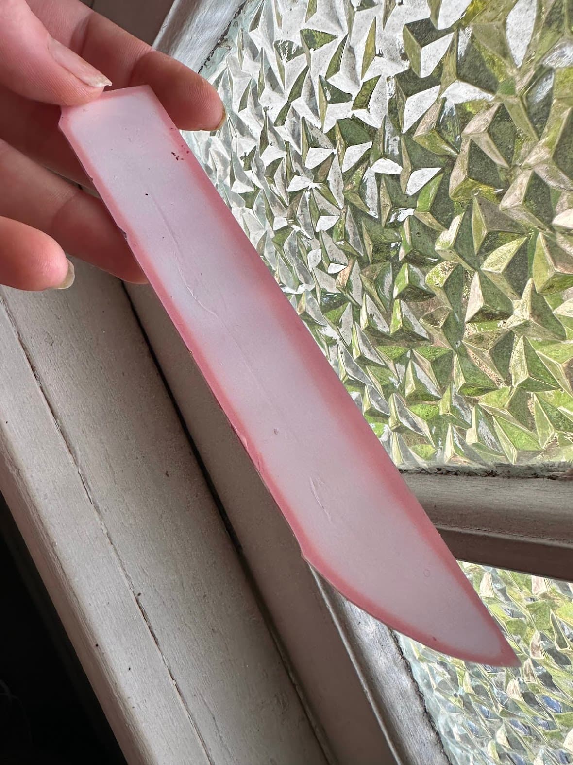

I used a cheap spray gun from Harbor Freight to apply it.
I shook it up with red food coloring… it will separate, just like the TiO2 does. I shook the bottle a bunch and didn’t notice it separating on application to the extent I see in the photo.
Might be different food colour recipes maybe! Not sure. I just figure a safe powder pigment will be more predicable.
I have in the past used a little black tenpra paint. Turns the mixture grey and makes it more visible. I use 1 inch foam brushes to apply the mix.
I’ve seen some things dry at different rates(evaporation rates) and it will leave areas if higher concentration as material seems to pool as other areas evaporate quicker.
I was making N95 equ masks from Zn and Cu solutions on MERV-13 filters and saw this effect where sometimes the perimeters had higher concentrations as it dried first.
