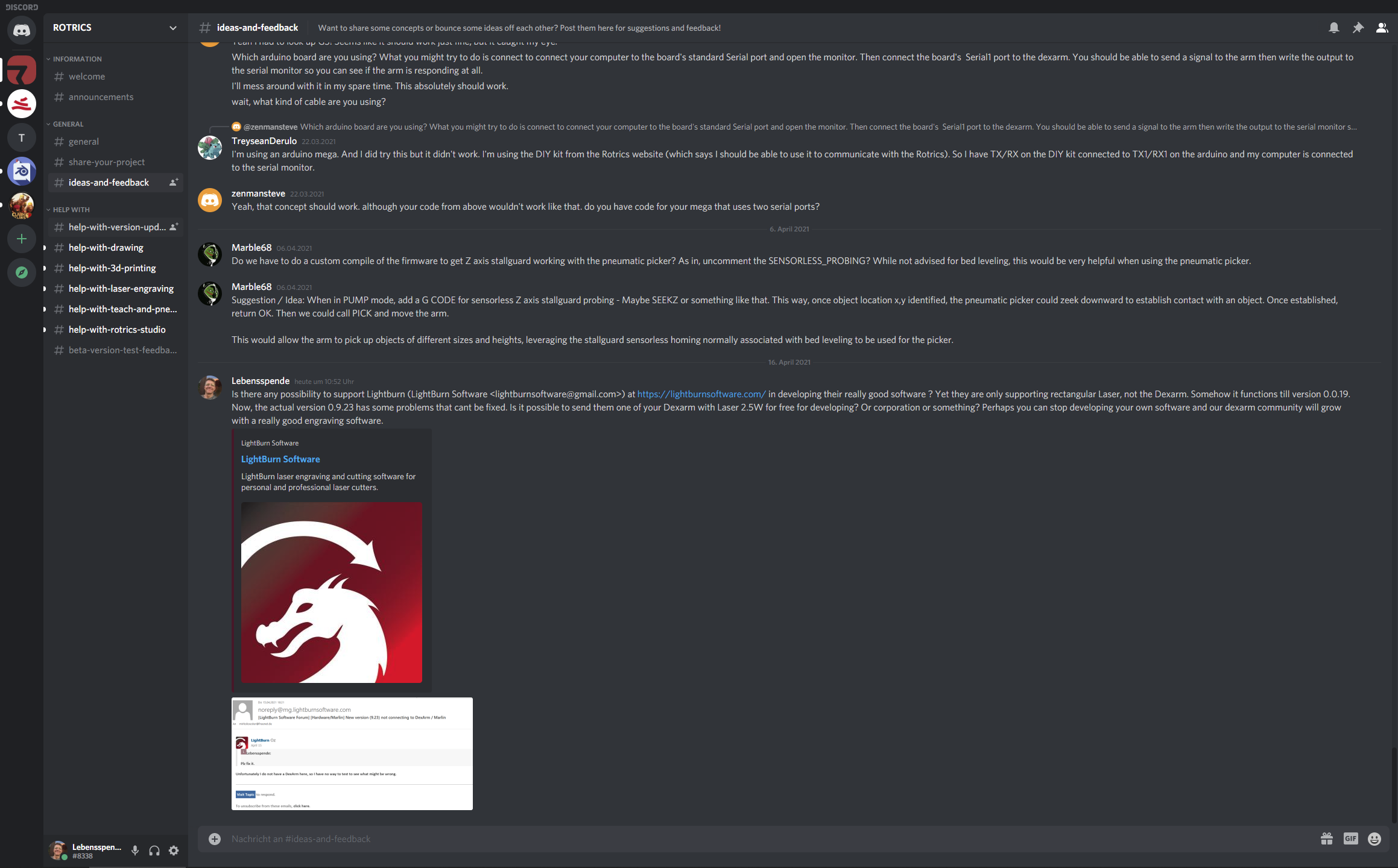

I asked at Rotrics to support you with a free Dexarm to develop your software for “our” laser with Marlin and circular engraving limitations.
Hopefully they react positively. :slight_smile:
