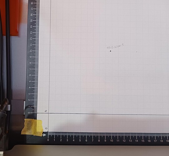

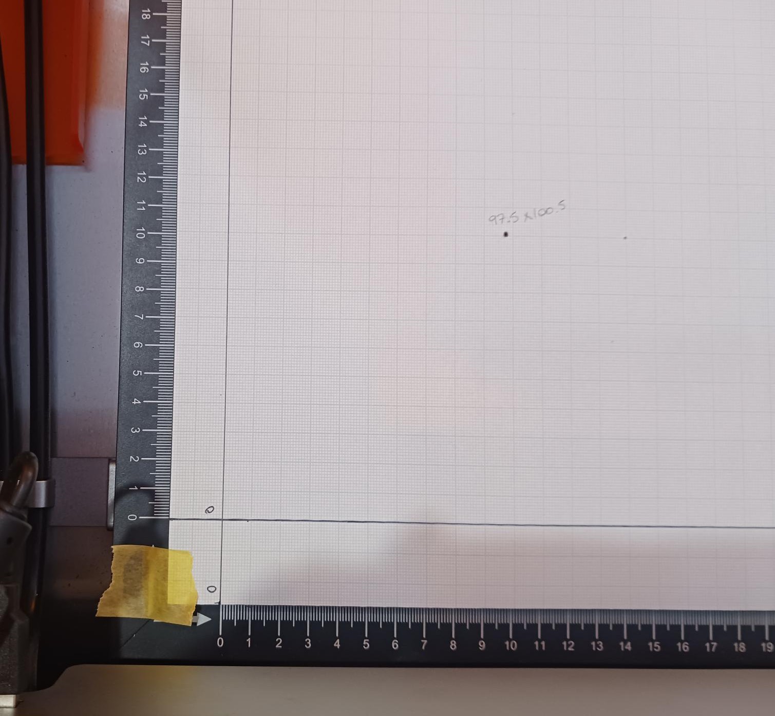

On the photo (from absolute coord), I entered 100x100 and pressed go, then fired till I got the small hole. As you can see it is 97.5 x 100.5. On the workspace, laser position shows as 100x100. Pointer offset was off for this.
The mm paper is stuck on 7mm carboard, so it may look a bit out of line on the photo, but I assure you it is in exact position 0.
When homing, it shows X:0 and Y:0
What do I need to do? And where and how do I do it?
I have a Genmitsu L8 40W.
Pulse/burn a dot while at X0 Y0 as a reference check to see if the burn dot actually lands at X0Y0 as you have marked on the paper.
The graph paper squares do not appear to be remain consistent with the measurements on the honeycomb frame?
The Laser Offset should always be disabled unless you have a separate “pointer” laser used during framing that is offset from the main output beam.
Haha, you did not mention you were using a camera!
I do not see a hole at 0,0 so how do you know it is not also off there as well? I have never used the honeycomb scales to determine position.
To check calibration, you need to burn a 100mm x 100mm square. Then measure it.
This will also check positioning accuracy. But I seriously doubt you have enough issue here to worry about.

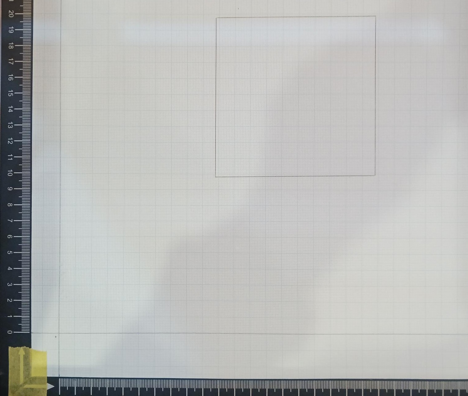

Clearly the physical workspace of my laser is -2 x-2 off from the workspace in Lightburn. The square is 100 x100 and is in the correct position from the 0x0 dot. This is good to know.
Unfortunately, it doesn’t explain why my work is always a little bit misaligned using the camera.
This is the stuff that I do:
I always start with full calibration (clearly something went wrong with the alignment the other day), but this is a consistent issue.

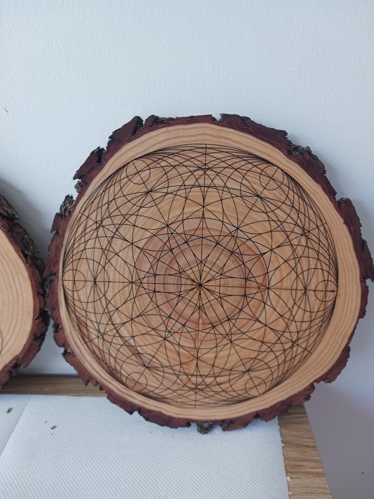

I make several camera adjustments to get the measurements right. Since the wood is about 20 mm thick and therefor closer to the camera than the workspace, this changes the measurements.
But even when I have everything perfectly adjusted and aligned on the screen, it always burns that little bit off centre.
I’m starting to wonder if the X and Y axis have also shifted a bit on the camera. But I don’t know how I can check that.

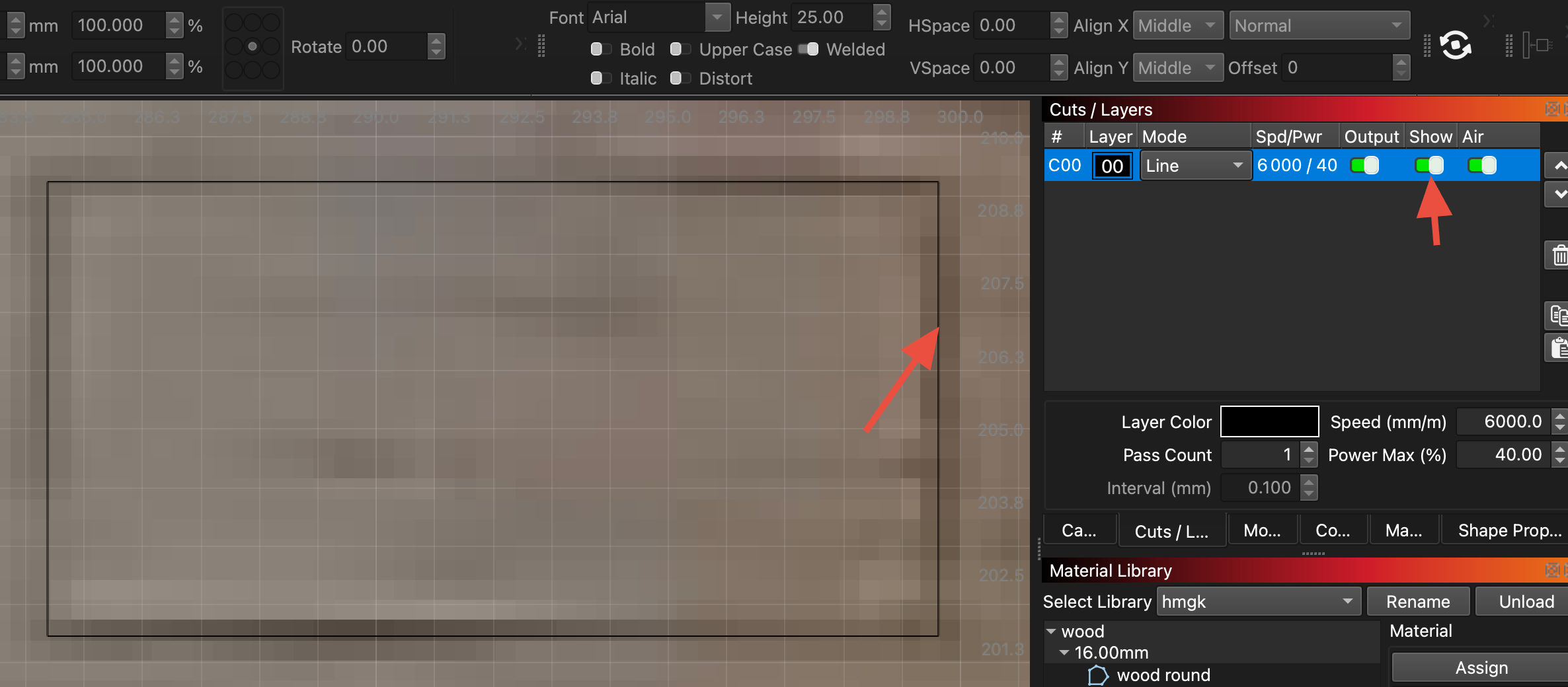

Immediately after alignment at 20mm you should confirm that the alignment is correct by setting these values all to zero:
To check everything, mark a shape and ‘Update Overlay’ and check that the shape in your workspace aligns with the burn marks now showing in the overlay image. Since you have just completed alignment, as long as you are using the same material height, it should be spot on without any adjustment needed. Toggle “Show” off/on on the layer to confirm the shape is perfectly above the mark you made:

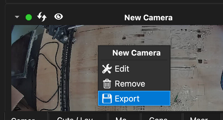

After doing this you should be good to go, but it’s a good idea to right-click on the camera image and “Export” your camera settings, especially if you could not enter material thickness during alignment - then name the file something like “camera_aligned_20mm” and I’ll give you some more instructions if you need to use the camera at other heights also.

I did everything that you said and it is a huge improvement. I only need to make minor adjustments along the way. I assume this is due to material thickness variation between pieces.

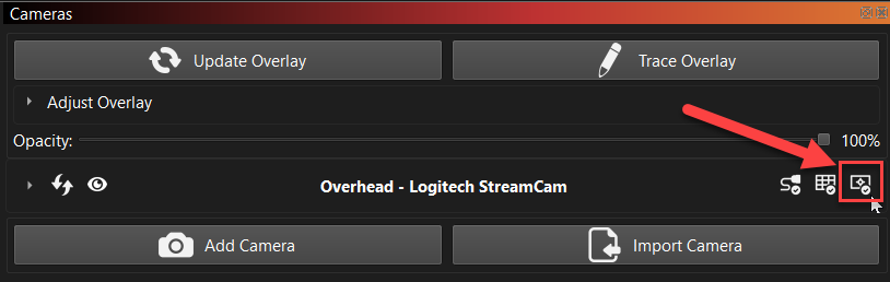

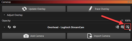

Note: It is currently best in 2.1.02 to start a new alignment for a thicker material by clicking on this button: (I had some problems saving new alignments initated from the Edit Camera area)
Then save/export your camera with a new name, and change camera settings by removing the existing camera and importing the appropriate one when you change materials.

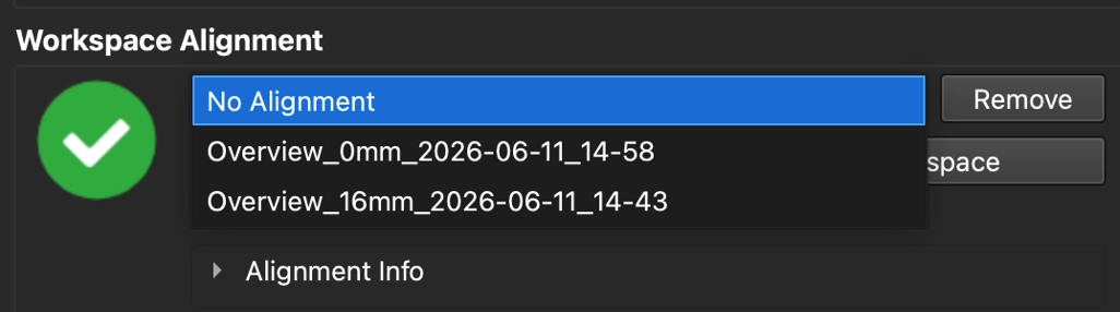

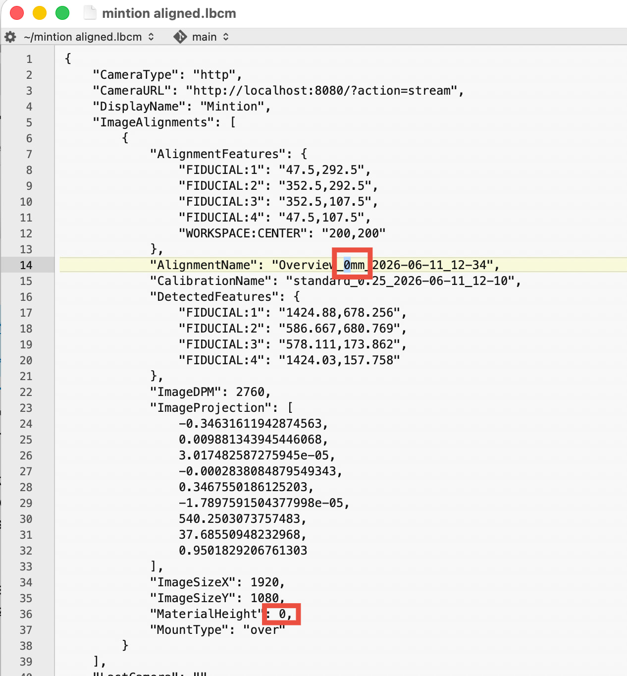

The GRBL device does not yet benefit from the new material height control and interpolated height improvements discussed in the forum post. However , there is an another way to at least set up multiple alignments for a GRBL device with the correct thickness showing in the saved alignment (rather than always “0mm”), by manually editing the alignment record in the camera settings file: For example, I change these values to 16mm:
Then, if you load your original camera that was set up and aligned for 0mm material, edit that camera and in the ‘Workspace Alignment’ section ‘Import’ the camera settings edited with the new material thickness, the 16mm alignment will be found in those settings and added to the currently loaded camera.
Now when you change material, right-click on the camera image ‘Edit’ and change the alignment that is loaded to one that suits the material:
