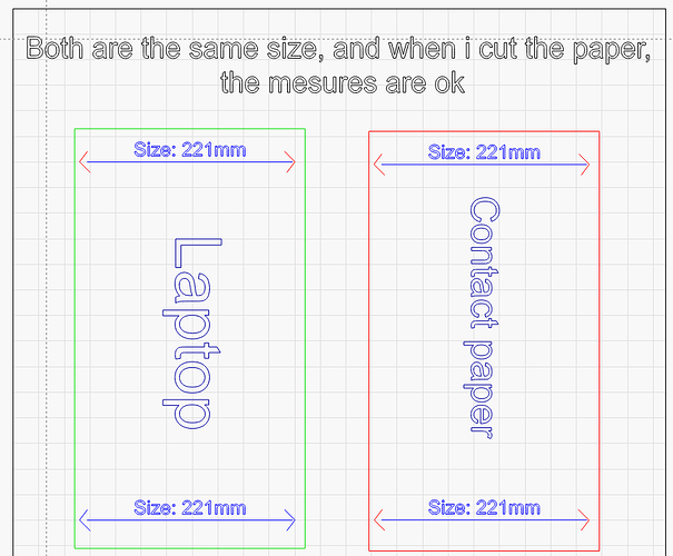

I’m new to the world of laser engraving and I’m trying to understand what I’m doing wrong with some of my engravings
To contextualize: I’m trying to cut contact paper to make a '“protective skin” for my laptop.

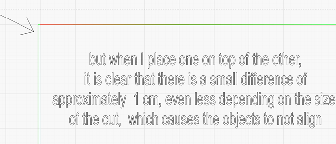

After creating a rectangle and cutting the paper, the width and height measurements match exactly what is stated in lightburn, which makes me think that there are no parameterization problems (I’m not sure), but when I try to frame it on my laptop, it’s clear that there is a very small offset of less than 1 cm that doesn’t leave the alignment satisfactory, I’ve tried to export the file and engrave it on the official NEJE software too, but the results are the same, I running out of ideias of where I could be wrong, any tips on this?

I don’t understand the problem. If the part is cutting as designed. And the part is proving too short for purpose, then can’t you simply design the part bigger?
I feel like there’s a complication that you’re trying to convey that’s not coming across.
I’ll try to draw to see if I can make myself clearer, maybe I’m not able to express myself correctly because I haven’t even understood the problem yet, since the measurements seem ok to me
It’s strange, at first I thought that the problem was happening because I wasn’t able to position both objects (laptop and the contact paper) in a way that they were fully aligned, but after several attempts, it seems to me that the problem is this small difference in size, it’s almost as if the rectangle just twisted a little bit, turning into a parallelogram
I also noticed that this problem is only happening with large cuts, when I try to cut smaller rectangles it doesn’t happen

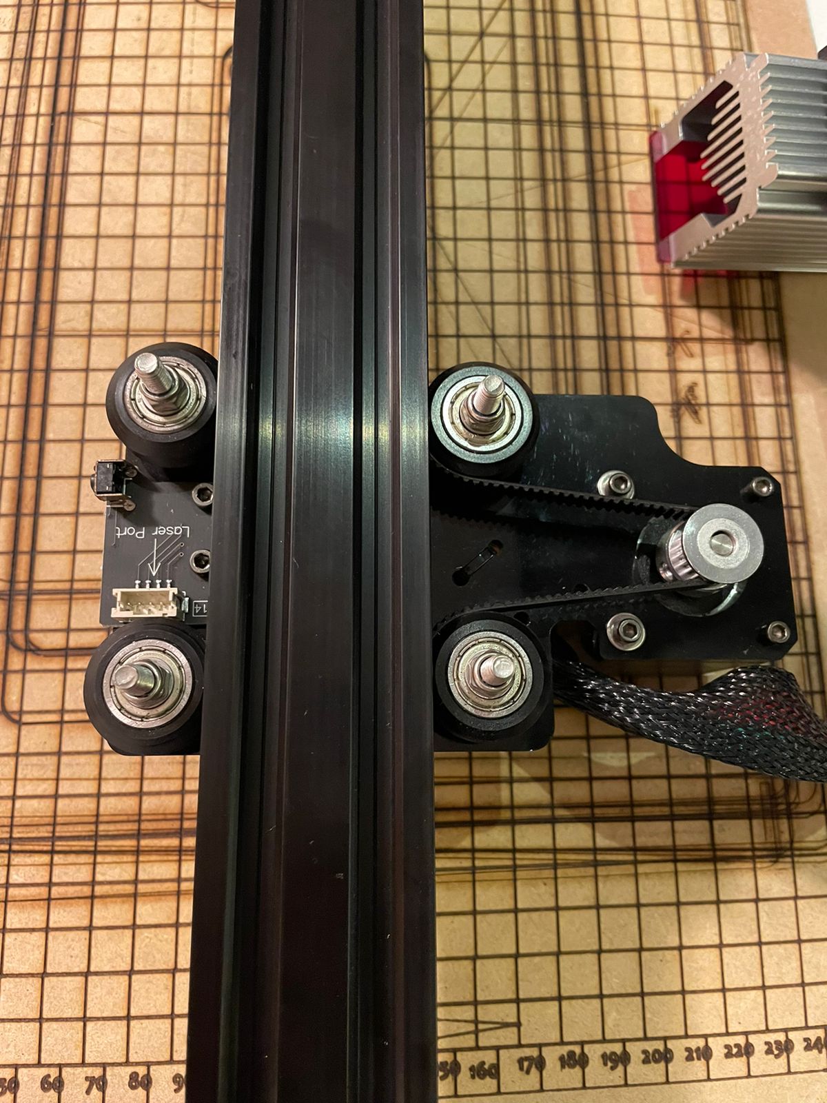

Sorry for the delay guys, I think I found the problem, but I’m not sure how to adjust it . After making several molds and measuring them, I noticed that the diagonals of my rectangles were different, causing them to become parallelograms, they differ by only 1cm, and with the naked eye it was difficult to understand, after all it seems that my laser machine is cutting something like this
If so, based on the picture I’m assuming the non-square line is along the X-axis? On the X gantry where it connects to the Y there should be a set of bolts that you can loosen that will then allow the entire gantry to pivot from that point. Square up the gantry to the Y-axis and resecure bolts.
I think you were referring to that set of four screws, is that it?
If that’s the case, I’m afraid the holes are too small and accurate, and there isn’t much room for adjustment.
First confirm that the gantry and Y-rail are not square.
Look underneath the plate to see if there’s anything you can loosen there. If anything you should be able to adjust the relative position of the wheels that hold the gantry in place by adjusting the eccentric nuts there but I recall seeing something where you could directly adjust squareness.

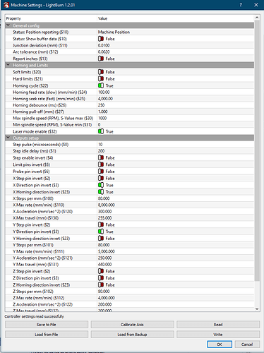

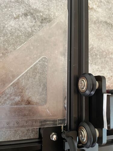

So i`ve bought a set-square, everthing seems ok, i’ve tried to mess around with the machine settings on light burn as well, but without any success.

This is a fool’s errand so suggest you not waste your time there. There’s no setting that would say something like “make this not square”.
I can’t see the distortion and you’re burning onto non-flat material. Can you burn a square onto perfectly flat material and actually measure the distortion? How much off are you talking about? And are you certain this accounts for the gap in your originally stated issue?

Are you certain there are no eccentric nuts on the wheel axles that can be adjusted to change the gap? That would be enough to fix this amount of variance I would think.

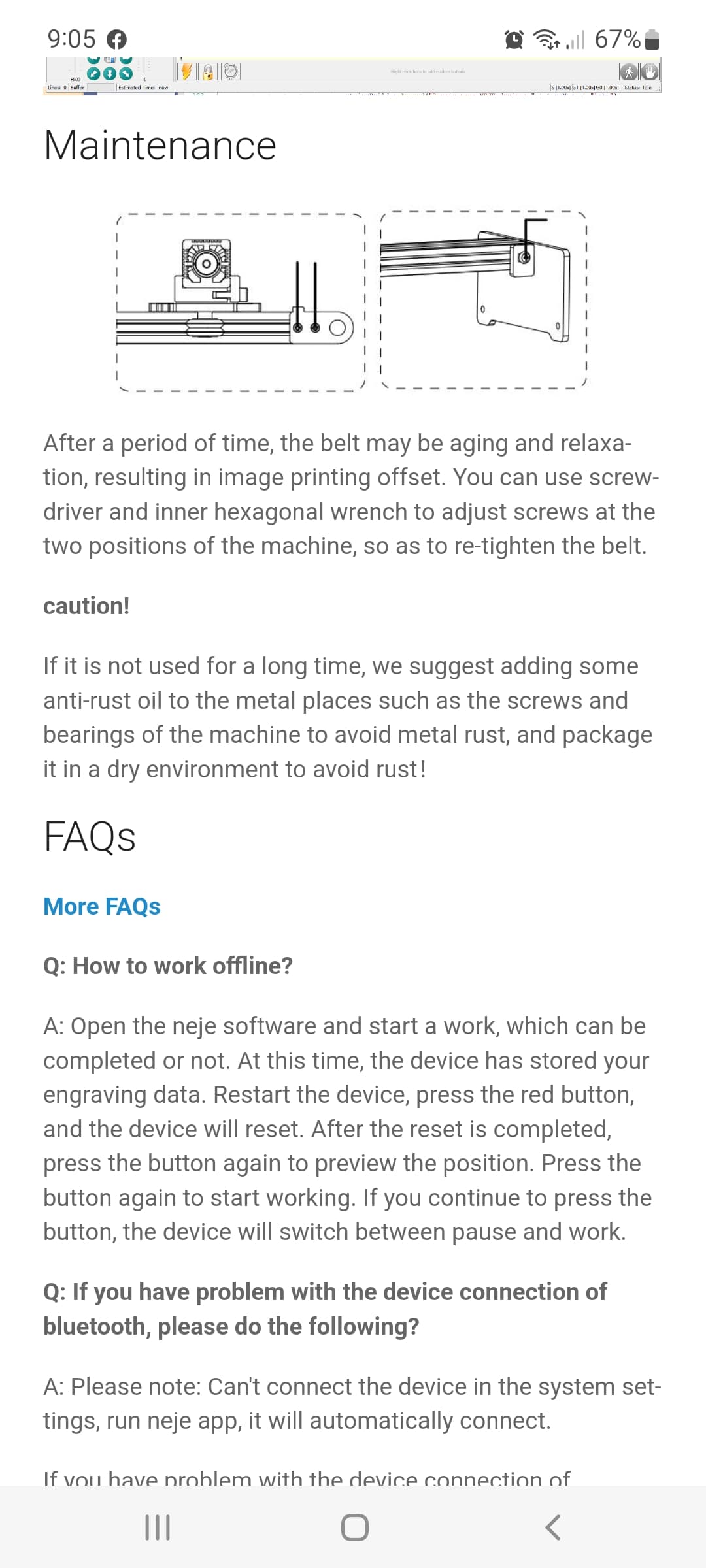

It doesn’t reach 1 cm, it’s around 750mm - 800 mm, there are the screws that @Jimcoy mentioned, what I find strange is that this machine is almost brand new, I made a very few impressions with it, but maybe it came out of factory adjustment, should I tighten or loosen the chain?
That looked like it was for affecting belt tension, not squareness but I’m not super familiar.

I want to make sure about the eccentric nuts. You’re saying that the wheels that guide the gantry on the Y rail do not have any nuts on the axle that can be turned?
