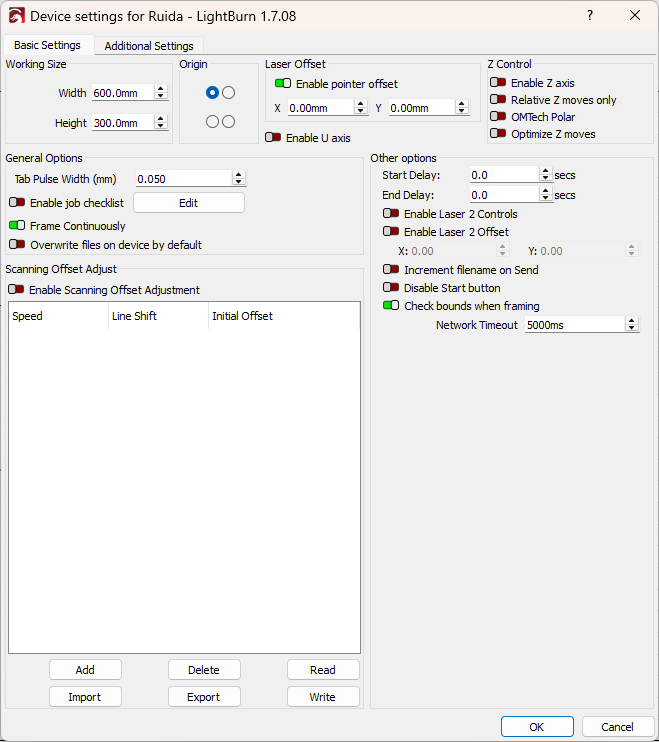

Trying to test fire my OneLaser XRF. I can hook up to it, move the head, read settings from the controller (Ruida). I want to test fire the laser which docs (and searches) say to go into device settings and enable laser fire button. But this is what I get in device settings - no enable laser fire button. Could some kind soul point me in the right direction?
That setting doesn’t exist for Ruida controllers. You need to use the test button on the machine to pulse the laser.
As @thelmuth points out, that’s handled by the Ruida controller.
The controller also sets the pulse power level and duration, although the exact Nerve Pinch required for those settings depends on the controller model. This discussion goes over some possibilities:
