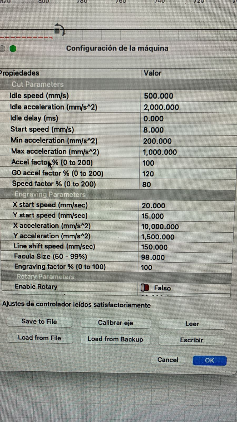

I just checked that post, im having that exact same problem , I need to arrange the steps for calibrating the axes but I don’t have machine settings , I used to have them like 6 months ago before some updates
I have RUIDA controller using LightBurn 1.7.08

yes , it is recognized , it works as “always” cutting etc, actually I tried removing the laser and running the wizard as for a new machine and it recognize it normally but I can’t enable the machine settings on the edit menu
this are some screenshots I did like a year a go when I needed to check the axis configuration.
So I know how it works and how it have to look like, but the option its just not displayed where it should be
someone share they should be on the laser tools but not for me :frowning:

thanks for sharing this version , this give me a clue of what the problem was, the solution is:
just change the program language back to English instead Español (latino America) I guess was not compiled right
I can now see this in the macOS version of 1.7.08 - Something has been left out!
In the Mac version of the 2.0, we have the “Configuración de la máquina” again!
