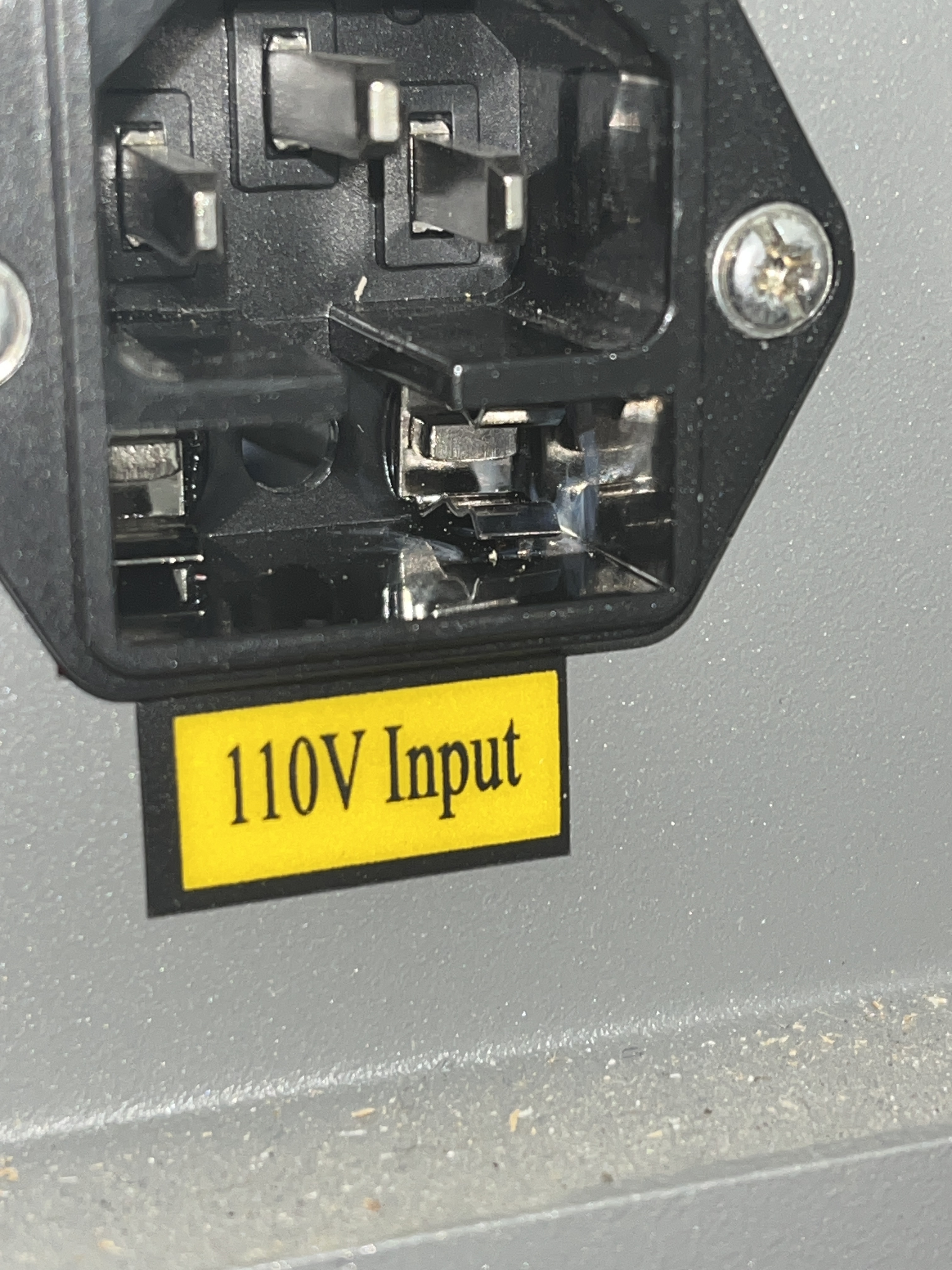

I have a USB1390 cabinet laser engraver that stopped working out of nowhere. I checked the power supplies and their LED is off, and they do not get any voltage when the machine is on or when its running a job. On the controller side there is a relay “YIJIA YJ2N-GS” that has a LED indicator light that is not on. I honestly cant remember if it was ever on though. What are the next components to test?

Here’s a picture of the power supplies, no lights, no LEDS, I checked the two AC wires on #2 with a multimeter and there was 0V. All those wires are secure, I tried pulling them out just in case they got loosened. The screen comes on, I can run a file and it’ll go through the motions but no laser fires. There’s no fuse on the back and there’s two wires that plug into the wall outlet that are plugged in and secure.
The controller (RDC6445S(EC)) has a red LED on #15 which is a ground. Could that mean there’s a grounding issue? The only ground wires I see that actually make contact with the machine are between the two plugs that go to the wall and are firmly tightened down.
I’m not very electrically savvy but I can do my best to test anything.

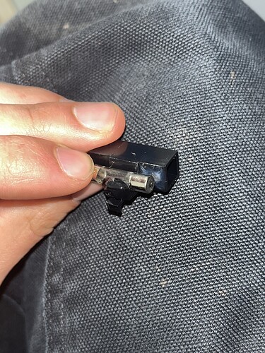

I think I found the cause, looks like the power was run too high and had a little fire in one of the fuses where the cords plug into the outlet and the machine.

With the fuse you’ve shown here, I think it’s likely that you’re seeing the aftermath of a low-resistance fault that caused heating and maybe a little fire.
When the contact area of the fuse holder is incorrect, too small, a little dirty or rough, the contact area gets hot because it can’t pass the required load. The fuse and the wires can be sized correctly but a weak connection can heat up and cause the result you’re seeing.
Most importantly, don’t install a larger fuse without checking the wire size and installing larger wire if needed. If you make the fuse carry more load, you can make an undersized wire get hot before the protection kicks in. The fuse protects the conductor. I can’t emphasize this enough.
Is there a rating on the fuse?
Is there a rating on the fuse holder?
Did the fuse blow or just get hot on one end?

Thank you for the tip! I’m still unsure what that would mean for the machine though, does that mean one of the power supplies need replacing due to a fault? And the fuse wasn’t blown, it got too hot on one end and burned a hole through the metal contact on the side, like a little pin hole. The fuse is rated for 250v and there’s two of them per wall outlet cord. I couldn’t find any rating on the fuse holder and am actually struggling to find a replacement one. Though my googling might be to blame for that. I bought new 250v fuses and plan on replacing the one that failed. I usually never run the machine over 50% since I don’t cut anything that require that power, but it was run by someone else at 90%. Is it possible that it drew too much and failed? I inspected the wiring throughout the machine and didn’t see anything apparent like burns or loose connections.

The fuse isn’t the issue anyway, it’s the fuse holder.
This is the problem.
At lower current levels, these have virtually no resistance. Since they are near the maximum at 120V, they become resistive to the input current creating heat.
This is indicative of a cheap connector that allow you to put the fuse carrier into the machine. The fuse, being intact, and it’s carrier being melted indicates it’s at or exceeded it’s maximum rated current flow for the fuse holder (not the fuse), creating resistance and therefore heat.
The problem isn’t the fused current flow, it’s the cheap input connector on your machine that couldn’t handle the current, the fuse is fine.

So I should get a better fuse carrier/plug? Will I be okay using identical fuses? They are not rated for more amperage or voltage.
It could be something as simple as the fuse holder wasn’t seated all the way and the contacts increased resistance caused it to melt.
Most of these are pretty standard made in Asia/China. This is likely what’s in there, if you want to replace it.
If you don’t just want to replace it, my suggestion would be a regular female three prong plug.
Move the fuse inside the machine. The there are plenty of types when it comes to fuse holders…

For now I’ll just replace what’s already there. Thank you for the links they’re very helpful, and thank you to all who helped with advice and ideas!
