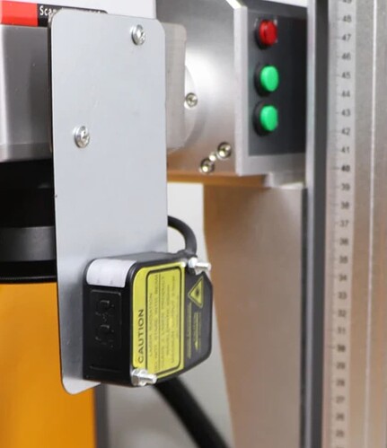

  • Autofocus system – not sure how to ID which one it is – i will provide photos this evening.

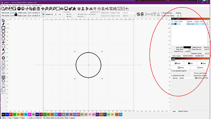

Problem: when attempting to set up setting for cutting, i have no “enable Z axis” option under device settings. it simply isn’t there.i know it should be in the upper right hand corner, but it is not. I have no option for Z step per pass, nor do i see a MOPA control panel.
ive seen some discussion on “continuous jogging” needing to be disabled, but i cannot find this function either, and am unsure if it would apply to me. i’ve also seen some controller compatibility/features discussion, but again, this is all foreign to me and i am not sure if i am doing something wrong, have a bad driver or imported laser settings, or if i’ve done myself the favor of buying the wrong tech.
im able to fire the laser, i’ve run a few tests and can basically force the laser to cut through, but being a newbie, my settings certainly are not ideal, it is fairly destructive to the 0.3-0.6mm Aluminium and titanium that i work with for dials. lots of oxidation, warping, and scorching. this is not a sustainable way to achieve a high quality end product.
Is there anyone who can help me optimize my lightburn to get full functionality and optimization for said applications? again, my plan is to be creating watch dials by deep engraving and cutting various sheet metals.
Thank you all so much in advance for your help. im sure i will be begging for more help again soon.

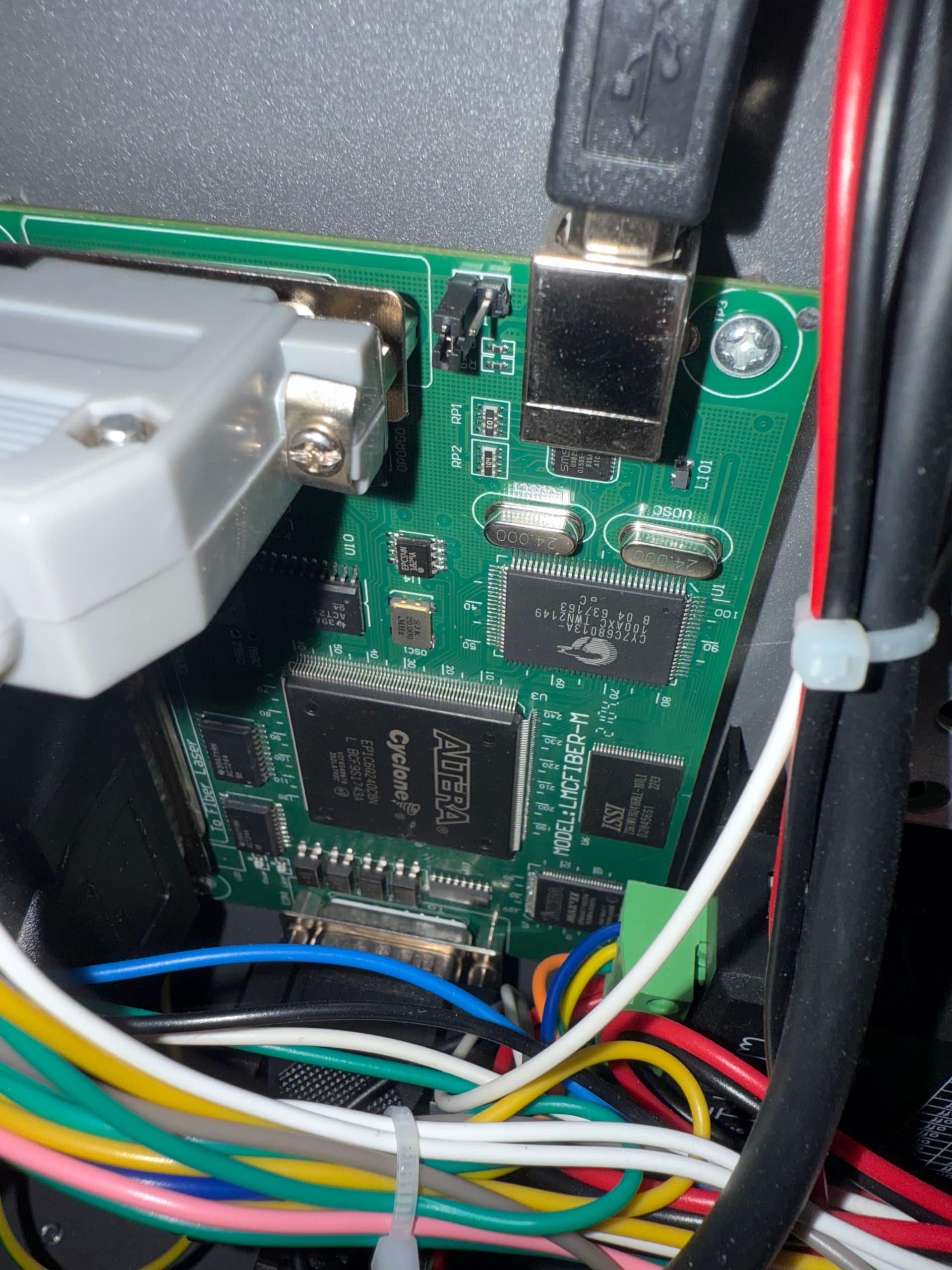

im doing some research here. lightroom has my laser labelled as : LMCv2, but im fairly sure that my laser SHOULD have come with the “LMCV4-FIBER-M.” Could this be the source of my problems, and could it be a simple software/driver issue?

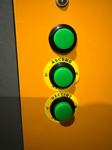

Yes, the autofocus module looks like this. it shoots a laser into the surface of whatever you are focusing on. i have no idea what the white panel of lights mean, or what the black buttons buttons on it do. See the 3 buttons on the control arm? you hold down the top one, the motor engages until it beeps to focus the device. the two green buttons below it to it raise and lower manually. i suppose you can adjust a millimeter or half mm at a time if you are extremely careful, but i doubt you can change by smaller fractions of a mm, i can contact the manufacturer for clarity, but so far they have been less than stellar in the customer service department.
Lightburn has does not support z axis control for fiber lasers.
Can’t find this, a link would be good. The photo of the Z sensor is so bad we can’t read any kind of identification, if there is any.

Since this is the brains to the machine, it’s nice to know which one you have. If for no other reason we can look inside the box and (hopefully) read it’s ID and compare them. What you can and can’t do is more of a controller function than a Lightburn issue.
As far as I know, JCZ isn’t talking about how these work to anyone outside of China, so the maximum capabilities and faults are not really known to most and probably includes the Lightburn developers.

What was finally mentioned by @Finn65 is that Lightburn is really a 2d software application, but there is no active Z axes available in Lightburn, so far.

Only applicable to gantry type lasers, so you won’t find it with a galvo machine.

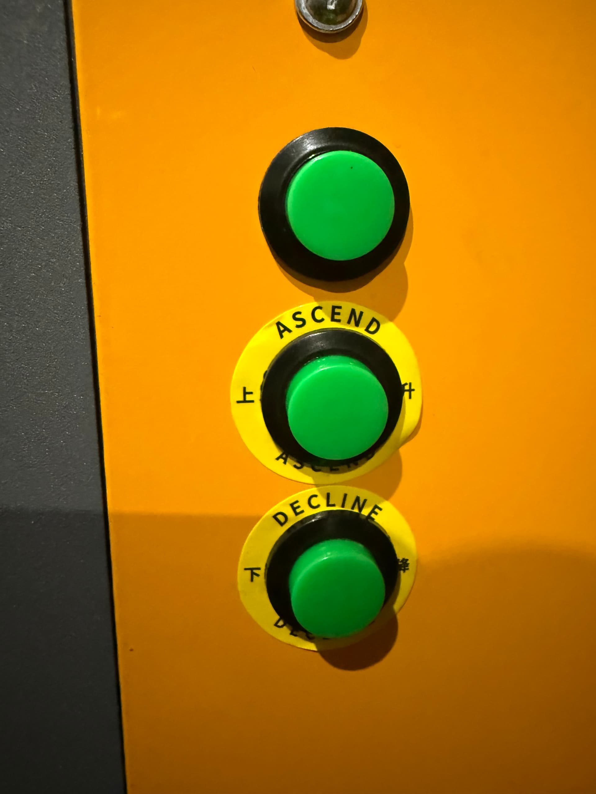

thank you for your well rounded answer. here is some more information. i took photos of all of the external and internal components this morning. it looks like the controller is different than i anticipated- it is marked LMCFIBER-M. could this possibly the the same thing as LMCV4-Fiber-M?

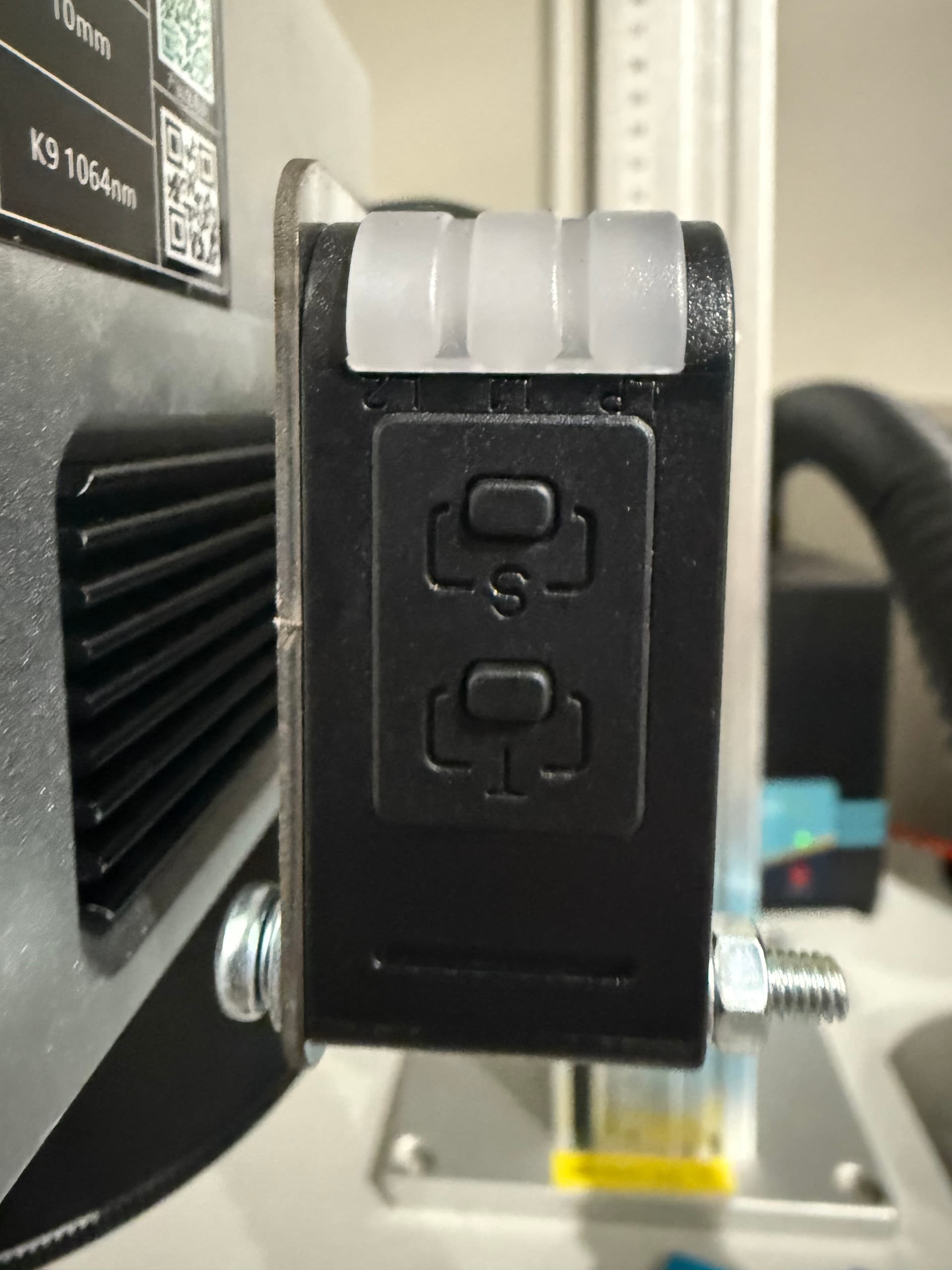

Autofocus Module: 3 lights marked “LP,” “L1,” & “L2” two buttons marked “T” and “S”
Focus control: ran some tests and found in reality that i can probably adjust by 0.15mm by tapping the up and down buttons very quickly

Thanks again danny, i did some testing and i think i can do microadjust with a quick tap of the up/down button. i do not have the 2 red led pointers on the head as you describe. see the other reply i just made with the posted photos. So, how to move forward from here?

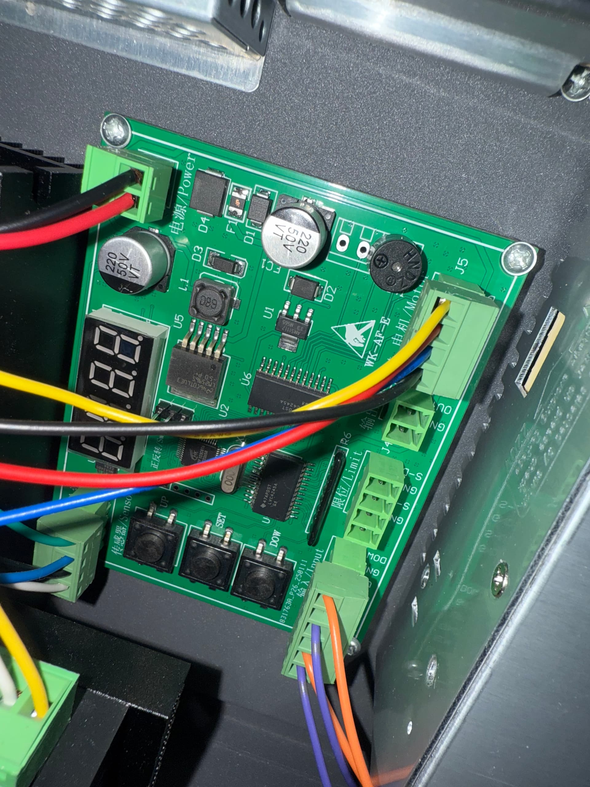

Your board looks like this clone, the chips I can read are equivalent. Labeling a little different. Looks like a clone of the old BJJCZ original board, FWIW.

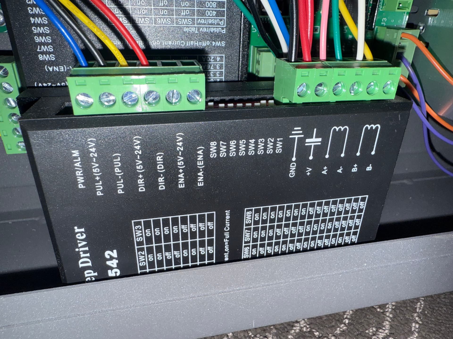

One thing I see in your photos, two microstep drivers, and an extra board. That extra board is likely a step generator for the extra microstep driver powering the stepper on the Z axis.

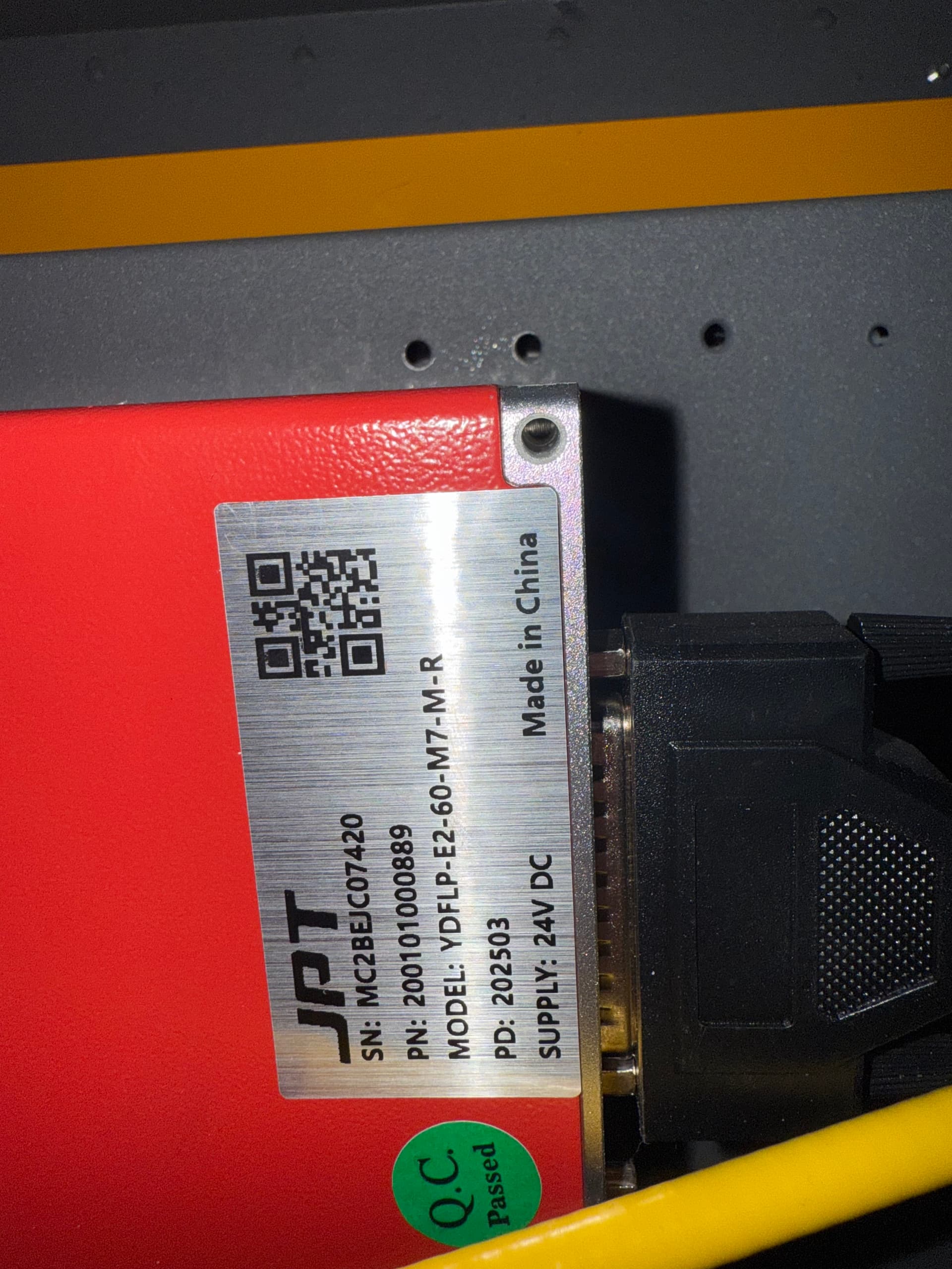

You do need the manual for “YDFLP-E2-60-M7-M-R” specifically. You can email JPT for it- in my case they wanted the exact serial number on that label too to give me a manual for it.

do you think i need a new control board? a non-clone one?

  2. i’m now under the impression that i have a clone board. im still not sure if i have the correct layout in lightburn per my devices capabilities. can you please check the screenshot below and let me know if anything is missing? If so, could the clone board be messing anything up here, or otherwise driver compatibility/recognition of features with the clone board? I’m not opposed to getting a new board, but swapping it will be an adventure for sure.

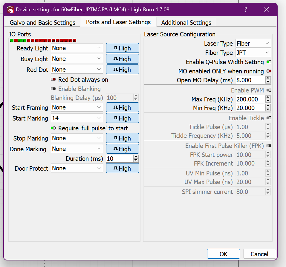

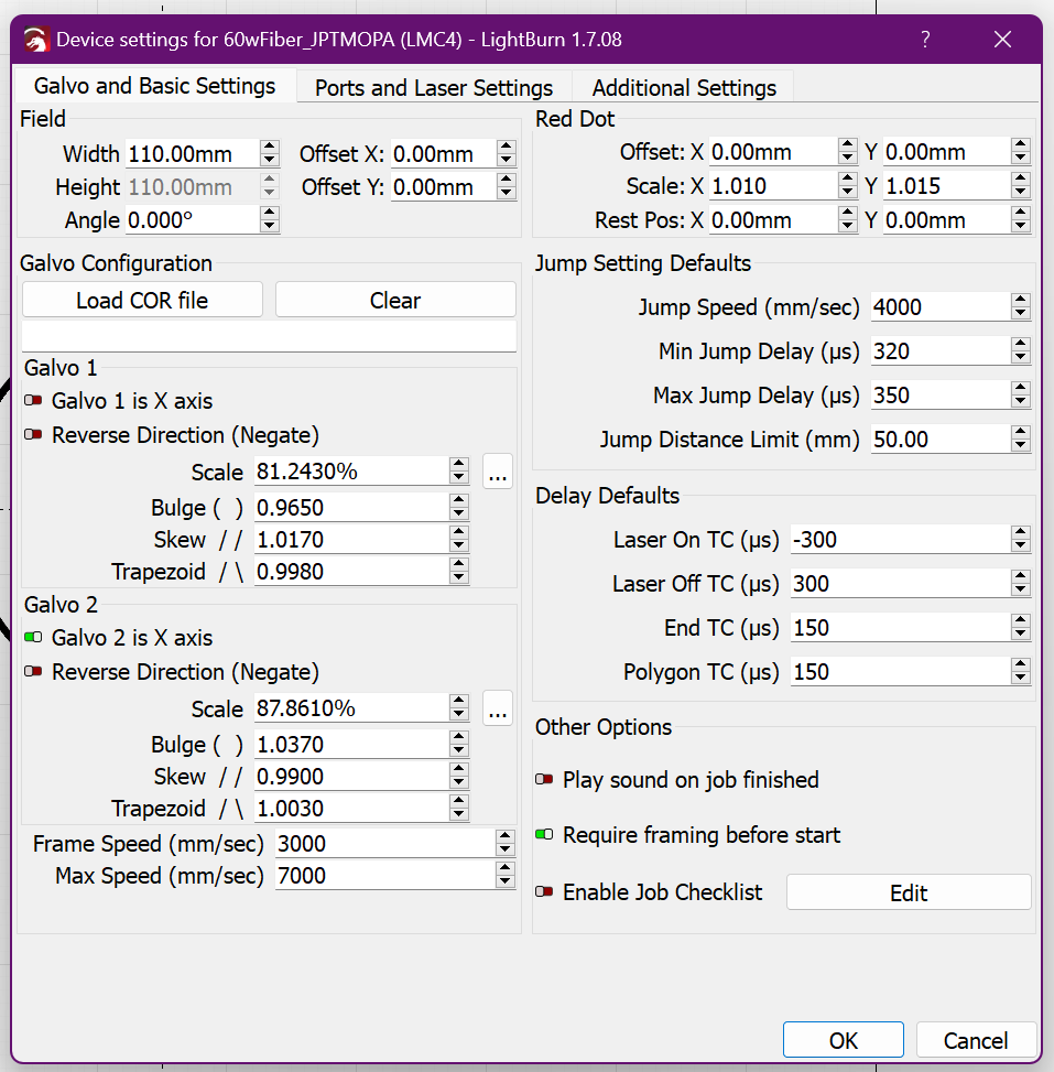

Danny,
to complicate matters, i just found that the “JPT” setting under device settings will not allow the laser to fire. the only device setting that allows the device to fire is the “IPG_YLM” option. this seems wrong. shouldn’t i be able to set Q pulse duration? why wouldn’t the laser fire with the correct source identified?
Max Freq is capped at 200KHz???
I think that should be 5000KHz! Set it to that.
The timing constants seem weird. Jump delay of 320-350us and laser on TC of -300us sounds bananas.
I can’t give you a value, they need to be calibrated. I only know mine. Let’s try the calibration routine I came up with this week.
OK, well, first we find the focus. Put a piece of aluminum or steel in the middle of the work table. If that’s a 110x110 working area, that’s an F163 lens. The “middle” of the lens (which you can only guess at, since you can only see the bottom surface) is 163mm from the work.
There should be up/down buttons to move the Z. I don’t know how your rangefinger works and we should just start from manual. Poke at buttons and see what they do.

Set JUMP SPEED=500.
MIN/MAX JUMP DELAY=0
JDL=10
Laser On TC=50
Lasr Off TC=225
End TC=100
Polygon TC=100

When not in focus nothing will happen. Hold down whatever button raises the Z. Soon you will get into focus and you’ll see a bluish-green-white line engraving across the work. Go a little further and it disappears. You may feel heat on your face like you’re facing a campfire while it’s out of focus. But it’s spread out and you’re wearing safety glasses, plus this is really low power.

Yep if you have a JPT that should be JPT.
Did you get a mark7cfg file with your machine?
You need to load it when you create the Machine Profile in LB.
IF you don’t have one, I’m not sure what will happen. The lens won’t be calibrated but that just warps the workspace and should be mild AFAIK.

MOPA Lasers are reported to run on IPG-YLPM or JPT Or both. Mine runs either one and don’t remember what the difference was 3 years ago when testing but I ended up going with the IPG-YLPM. I switched back recently to check and didn’t see a difference, don’t remember why I chose YLPM now. After changing laser type you need to power cycle for changes to take effect, at least my laser is like that. If I change from YLPM to JPT it freezes up until the power is cycled so there is something different between them.
I wouldn’t worry about your board, unless it doesn’t work. Looking at your screenshot of machine settings looks like you have corrections from the factory in place, by all means set your frequency range 1-4000 if you need it, everything else looks good for starters. Before you start down any fine tuning, I would suggest you determine focus is correct and mark some squares small up to a little smaller then full size and measure them, and measure them corner to corner. This is easy and will tell you how good of a job they did with your factory setup. If it’s not good no reason to continue with the fine tuning, have to go back to 9 point correction and/ or scale and run those utilities first.
