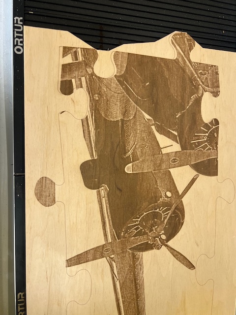

Yesterday I lasered with my X20 Pro a very large image (645x360mm) for the first time.
The image is offset by about 6mm to 600mm!
I have been able to isolate the problem, what is not a mechanical problem.
If I cut the outline DIRECT after engraving, without homing between, the cutting line is still the correct one.
Lightburn produce an incremental gcode for engraving.
So the offset by line must be app. 0.001mm.
It can only be either a firmware problem or a software problem by lightburn.
But if I control the Gcode I can´t recognize an error, what is difficult because ist incremental :blush:

Hi Josef, are you selecting all the project and burning, cutting all at the same time or are you doing the burning then doing the cut?
Does it look right in the preview ?
Hi Chris,
thank you for answering!
Could you load the second video?
Here you can see the cut is at once after the engrafing, without homing between
The Preview is correct
Hi Josef, sorry didn’t watch the second one but now, seeing it, the propeller looks to be where it should be (looking at your preview in the vid), the rounded parts at the bottom look to be the same as the preview.
The rear part (top in your preview in the vid) is way out.
That’s a strange one.
Sorry that’s got me stumped.
Hopefully someone will come along and give you a solution.

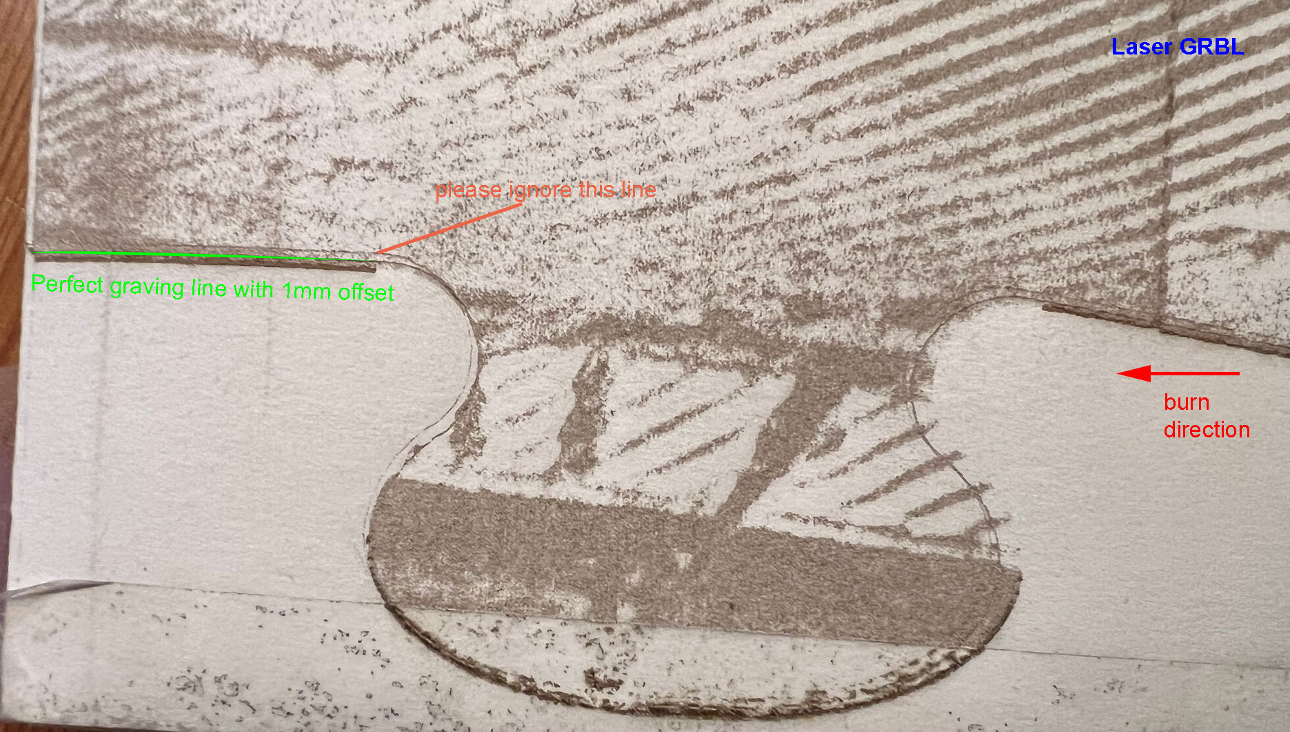

I´ve tried graving in LaserGRBL with pass trough too and it seems that the image burned correct, terrible quality but correct, I think (I´ve burned on glued onto wood papersheet, because running out of wood :roll_eyes:)…
The image quality in Lightburn is absolutely amazing with the improved pass through function!
I´ve tried to make it exactly like in LaserGRBL

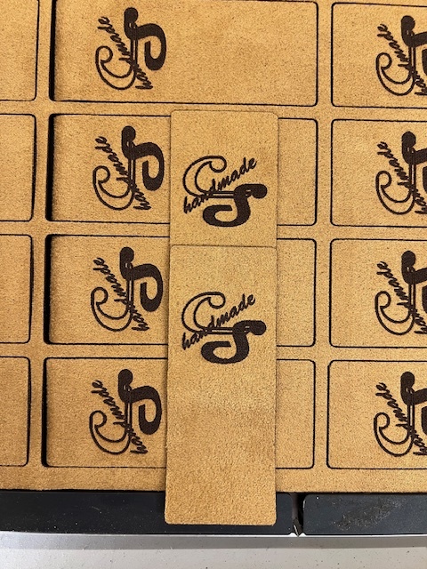

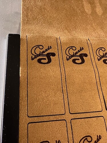

How did you do this? Was this done in two operations?
In your original post, the Junkers puzzle piece, was the engraving and outline cut done in a single job? Or was that two separate jobs?
Also, are you exclusively using millimeters as units or do you ever switch to inches? I assume you don’t use inches based on your language settings but good to confirm.
On the paper sheets two separate operations each.
On the original post (video) it was a single job.
Yes, you´re right, I´ve never swich to inch.
In this example, can you confirm whether its the outline or the engraving that’s actually offset? Also, can you confirm that it’s just offset? Or is it skewed? I assume the latter. For example, the engraving is slanting slightly but consistently.
