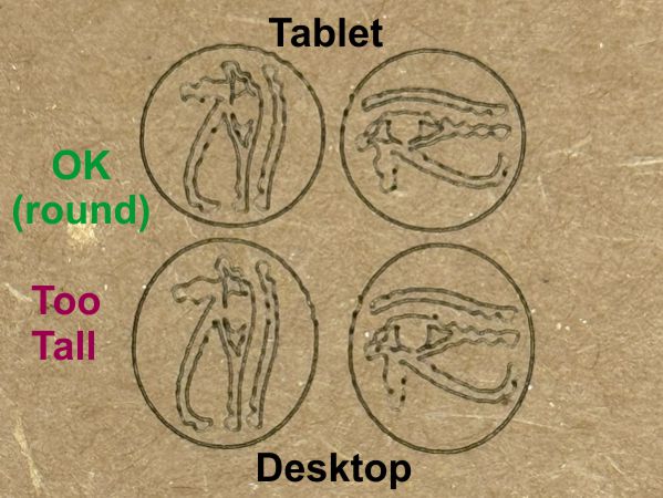

Hello all! I have an issue I can’t figure out. I attempted to engrave some small emblems yesterday but they came out TALL (they were suppose to be round). So I ran a tall rectangle (100 x 300mm) in preparation of making a Y-axis calibration and instead of 300mm tall it was 338mm. I was going to make the adjustment in the ‘Calibrate Axis’ panel, but decided to wait overnight before I did anything.
I was running the laser from a desktop pc.with LightBurn via wifi. So today before I made the axis calibration change, I decided to hookup my tablet to see if the file prints the same way from a different pc. I ran the file again from a MS Surface tablet also via wifi, but those images came out fine–both the emblems and the rectangle were the correct sizes. So next I shut everythng down (laser, LightBurn and desktop pc), then rebooted (shut down and restart). After the reboot, I ran the files again on the desktop, but as before they came out too tall.
I compared the Machine Settings from both pc’s and they are identical. So since it runs fine from the tablet, I didn’t think I should run the calibration on the desktop pc that would make changes on the laser controller (I assumed it would then affect my tablet).
Any suggestions? Attached is a photo of the images. The bottom (oval) images are from the desktop, the top (round) from the tablet. I rotated the image to see if the issue was with the file, but as you can see it prints tall no matter the rotation.

Sorry, forgot the image. Sb attached here.
Check to see if you have ENABLE ROTARY checked on one machine and not checked on the other.
Hi Jim, thanks for replying! Sorry for the delay in replying I had to wait until the job was done to check that. And–YES, I had the rotary enabled! That was it!
I should have thought of that–I aways use the rotary with the AL1, but never with the OLM3. So I don’t know why it would have been enabled. All I can figure is that I must have opened the job while I had the AL1 settings up (I had just run a job on the rotary–and why I had to change the bed size).
