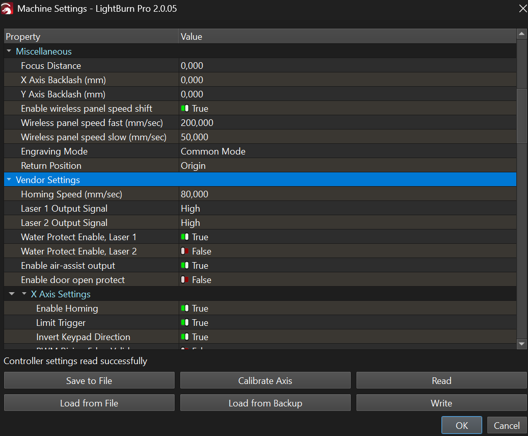

[Edit]: I fixed Question 1 myself.
Solution was to set “Laser 1 Output Singal” in the “Maschine Settings” to: Low

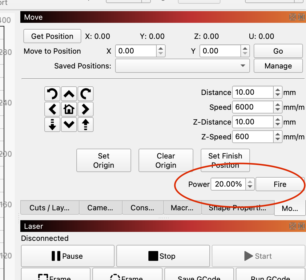

Question 1:

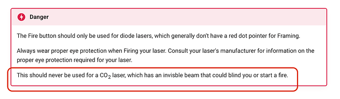

I actually face an issue where the laser beams while framing/ pressin reset button. I’m not able to enable the fire button, because the Option to enable it, is not given.
Im not in the beginnder mode. Using latest lightburn version. 2.0.05
[Edit]: I fixed the second Question myself.
Solution: Set “Focus Distance” and Z Axis → Limit Trigger = true

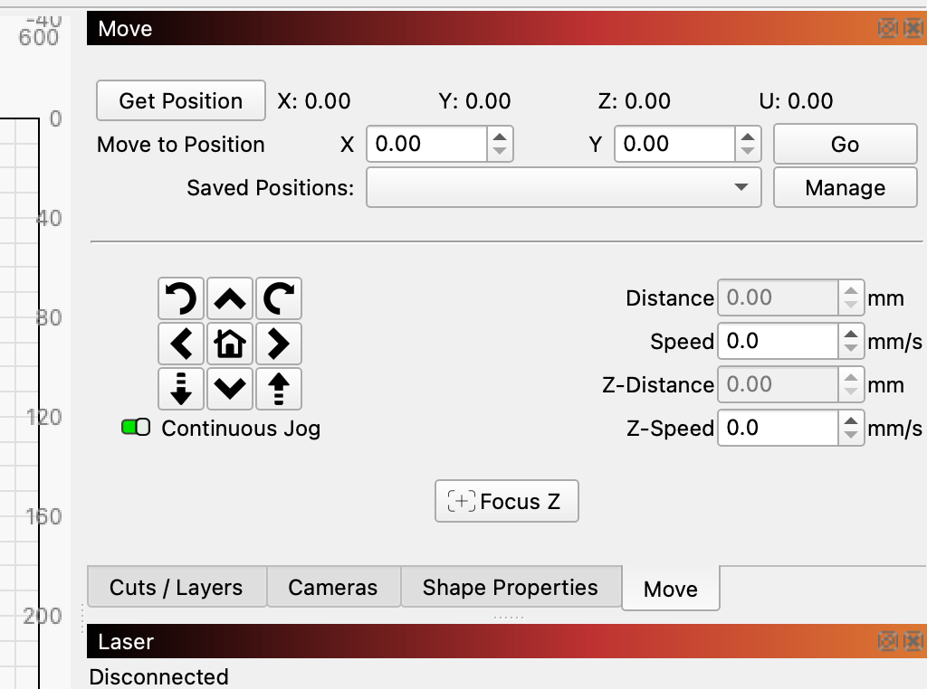

Second question:
My Laser has autofocus. If i press the autofocus button on the controller, the bed is going up until it hits the laser head and stops there. Its not going down. Is there additional setup requiered?

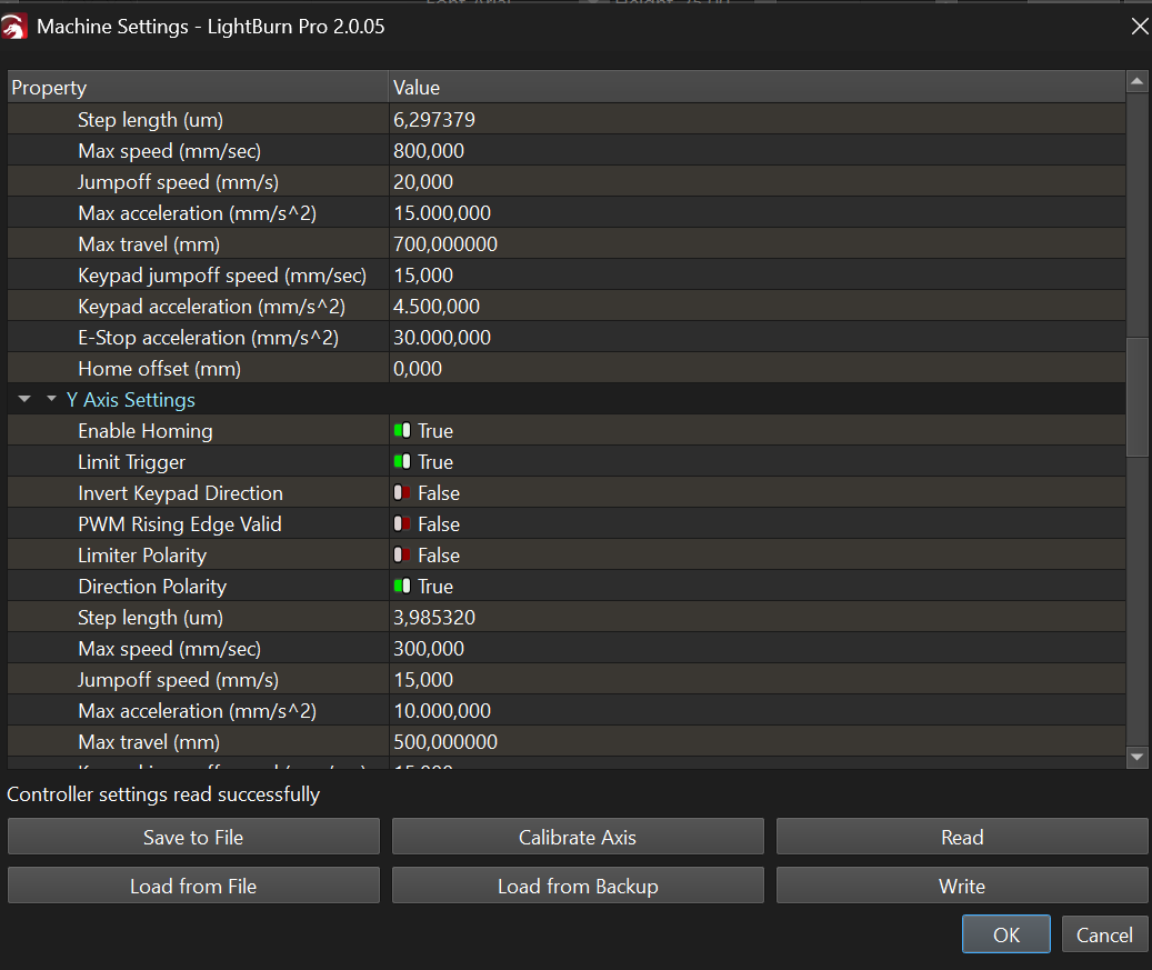

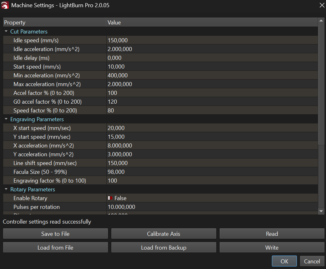

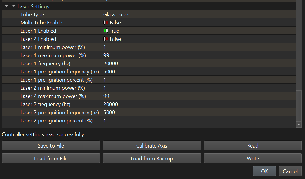

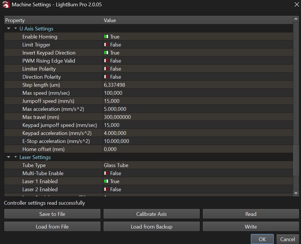

Can someone tell me if my settings are correct for the laser im using:

All the other questions about your machine, here you should be able to rely on the basic settings that come from OMT with your machine. Later there is the possibility of optimizing - if needed.

Well i was just asking for that feature, because it relies on the setting to stop beaming/fireing while framing…
My best advice is if you have the “laser active when framing” function, turn it off. Doesn’t your machine have a red laser pointer built into the nozzle? If not, retrofit one, I use it and like the function, others hate it (I don’t know why)
I personally use a camera to orient subjects and the laser itself, highly recommended and makes framing unnecessary.
It does have a red pointer. But where can i disable that function “laser active when framing”?? Thats what i’m looking for.
I’m a bit confused or didn’t read your original message correctly. I only have this feature option in my diode laser (and the K40 had it too) but not on my DSP laser machine.
no.1 is my OMT CO2 laser, no.2 is a grbl profile for my diode laser
Assuming it’s that machine
That’s the right way to do it, but the physical distance depends on the position of the sensor. The description suggests the machine has some kind of contactless sensor(s) on the sides, so be certain they cannot / did not move with respect to the laser head.
Use a focus gauge to verify the autofocus position whenever you have doubts about the focus.

That’s determined by the controller. Check the Machine Settings for something like Return position, which will have a choice along the lines of Origin to return to the home position.
