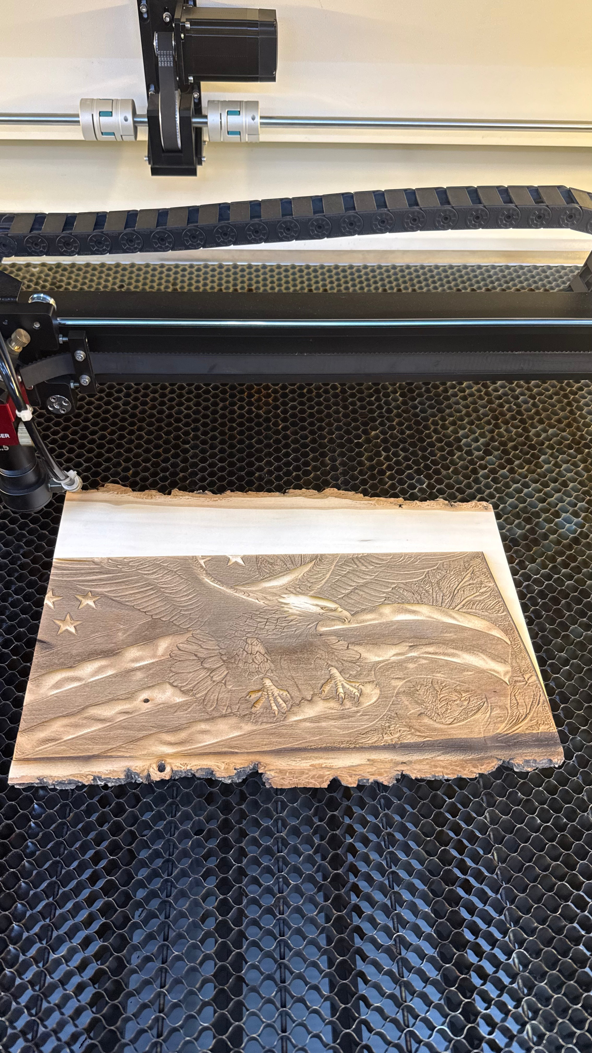

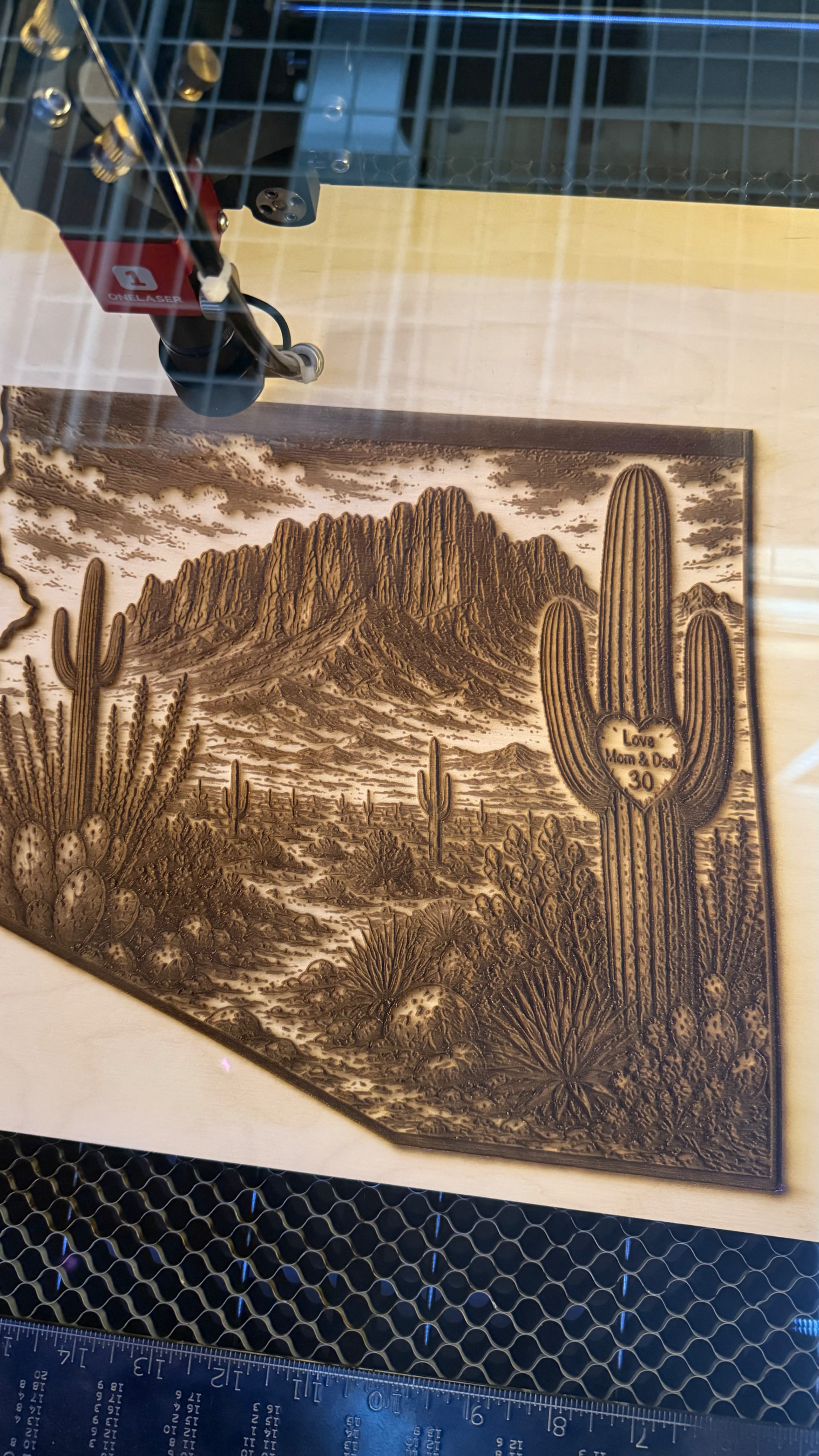

My Hydra 13 has developed a progressive X-axis skew/stepping during raster/image engraving. Cuts and vectors are fine. OneLaser and I have been troubleshooting for about a month, including hardware/alignment checks, with no cause found.
I’ve tested multiple speeds and LightBurn 2.1.x versions. Today I even installed LightBurn 1.5.01 and created a completely new file with a freshly imported image, and it still skewed.
The strange part: an older raster image/project originally created in LightBurn 1.5.01 still engraves perfectly on the same machine, even when opened and run from LightBurn 2.1.04. But if I freshly import an image, it skews.
Ruida mainboard firmware is RDLC-V7.17.07.
Has anyone seen this behavior or have any idea what could cause an older raster job to run correctly while newly generated raster jobs progressively skew?
